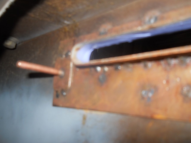

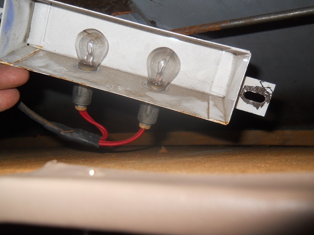

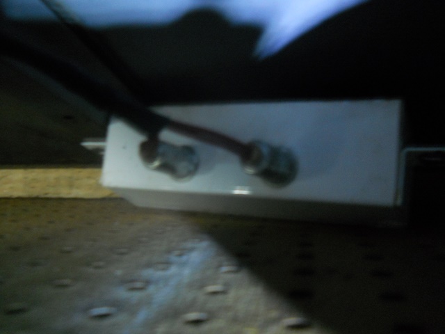

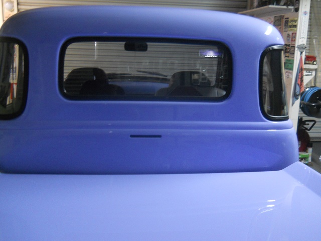

    Wallaby - post pics of rear of truck to see what you have now - attached are some pics from installing a 3rd brake light on my Wife's '50 Chevy PU - may be more involved than what you are looking for - DSCN9371.JPG does not show entire install process - the rectangle box was from another project but, easy sheet metal project.not shown is the custom formed lens using transparent red plexigl*** & clear acrylic prismatic glued together - Tap Plastics is a common source or try estreetplastics.com - light is very bright by using "Brite Bulbs" DSCN9380.JPG DSCN9381.JPG DSCN9383.JPG 1016161646.jpg
