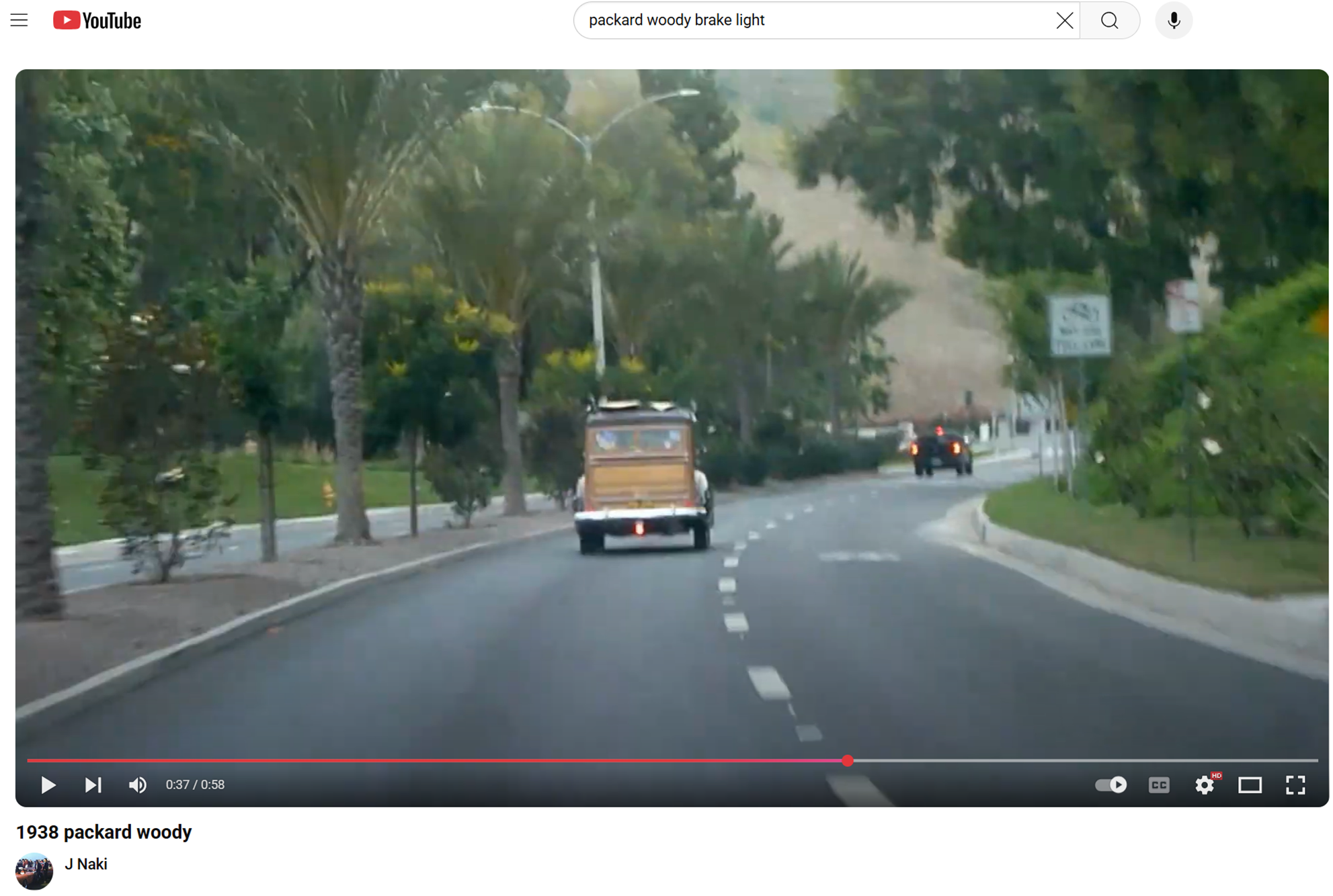

    After those ideas on different hot rod cars, my wife spotted this one from far away as we happened to turn on to the same street following that cool station wagon.
    One an old woody with a couple of surfboards on top was ahead of us while we were driving toward our weekly coastal cruise and errand day, in our station wagon. So, out came the digital camera to record some action. The woody was nicely finished and accelerated quite nicely. When it stopped, we were able to get a closer look with the zoom in feature of the digital camera. A nicely finished woody wagon made by Packard. A Packard woody? What is this world coming to in this day and age?
    Packard woody video:
    The digital camera was a lot easier to film than using a phone. The format of the little rectangle camera was perfect to rest on the steering wheel and hold it steady. But still being aware of the traffic (none surrounding us on a one way divided street) and continuing to shoot a moving vehicle.
    Jnaki
    So, for the thousands of dollars, time spent and enjoyment fulfilled, it is worth the extra added protection for the build to "be seen..."

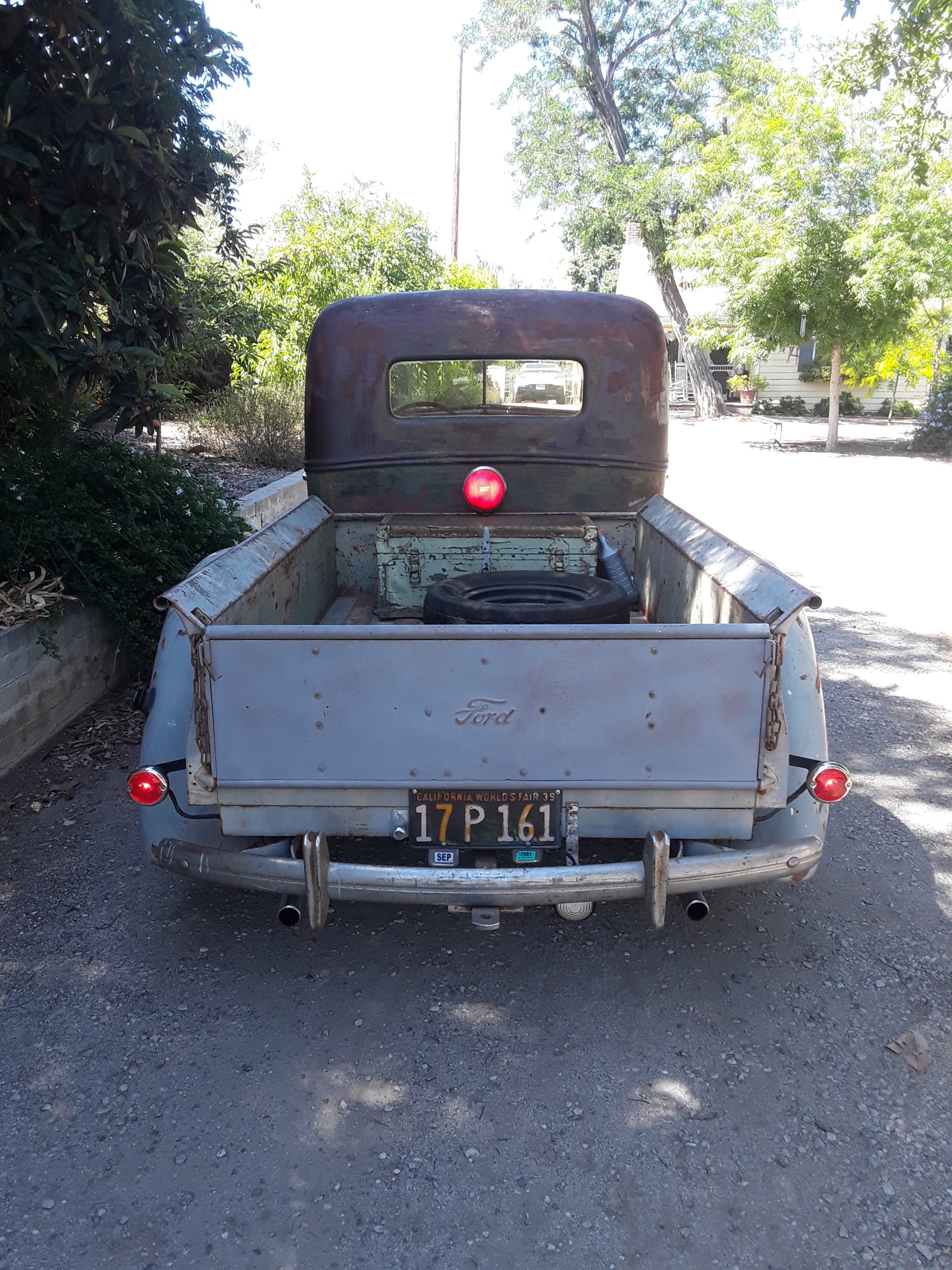

    What I did on my '39 p/u

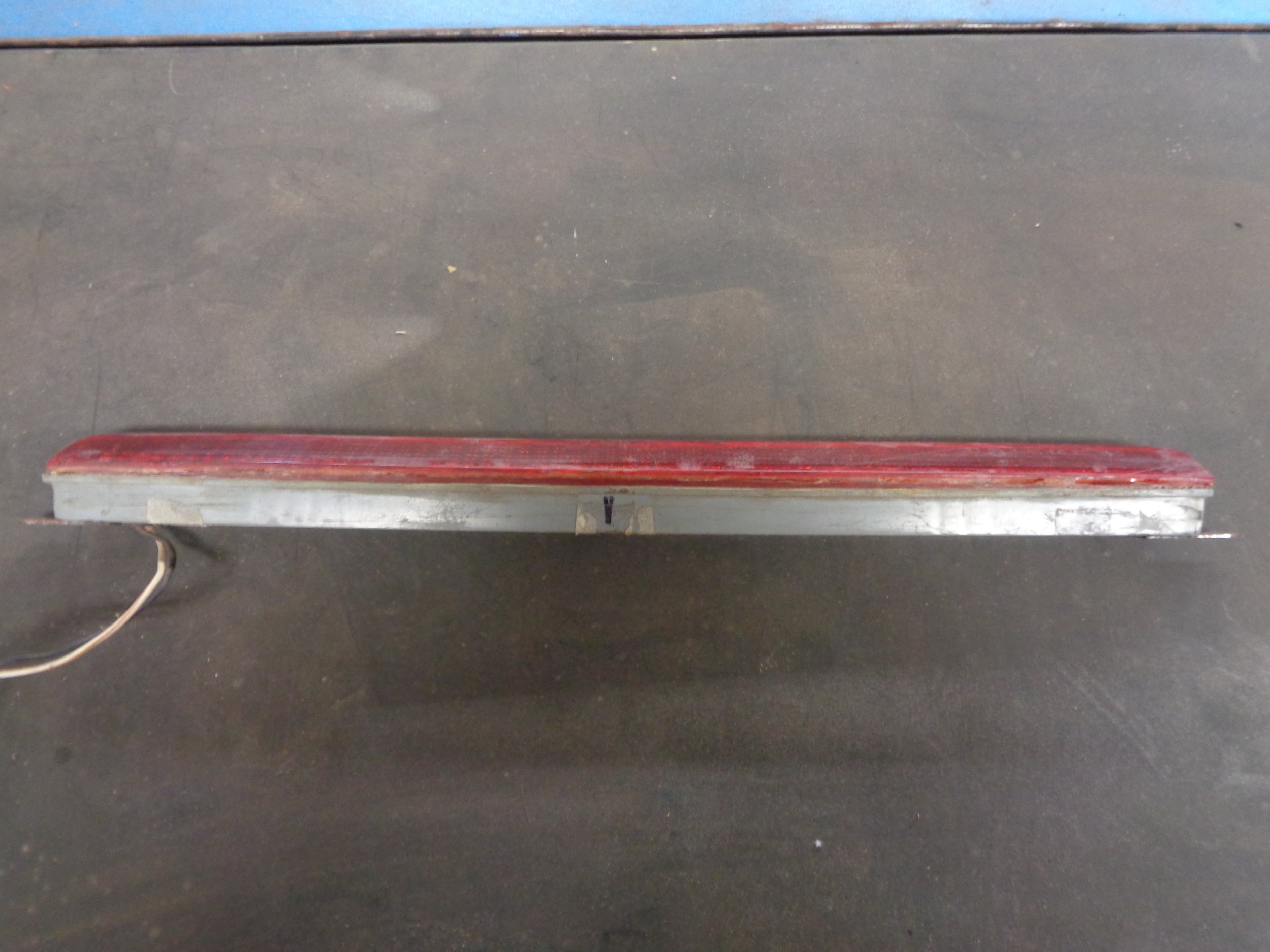

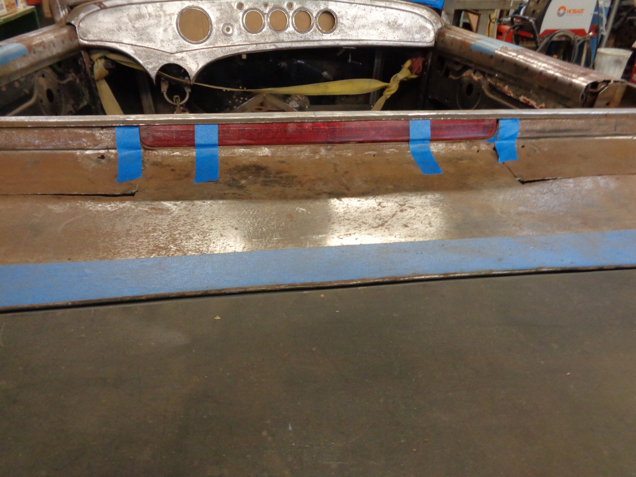

    Found this on an early 90's Chrysler. Blends right into the bead on the coupster.
    Had to Dremel the lens off and take out some of the longitudinal curve.

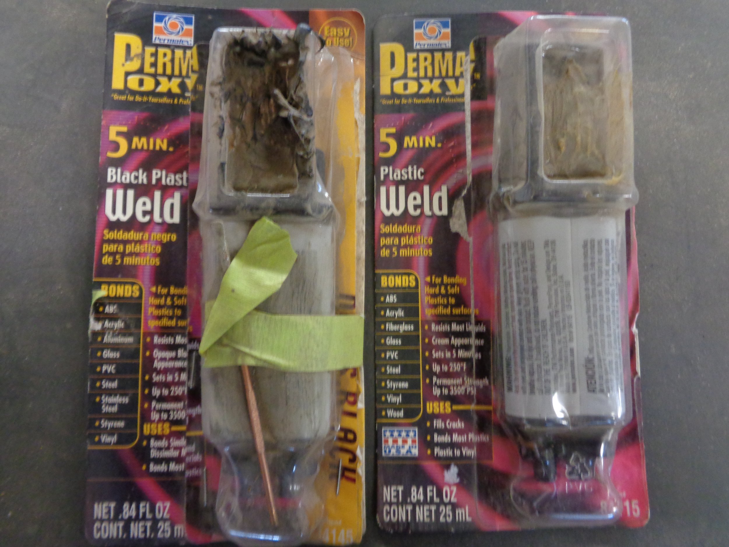

    Used this to glue the lens back on. Also used it to attach new mounting tabs. If you look at the list of what each one bonds, they are very similar but not identical.

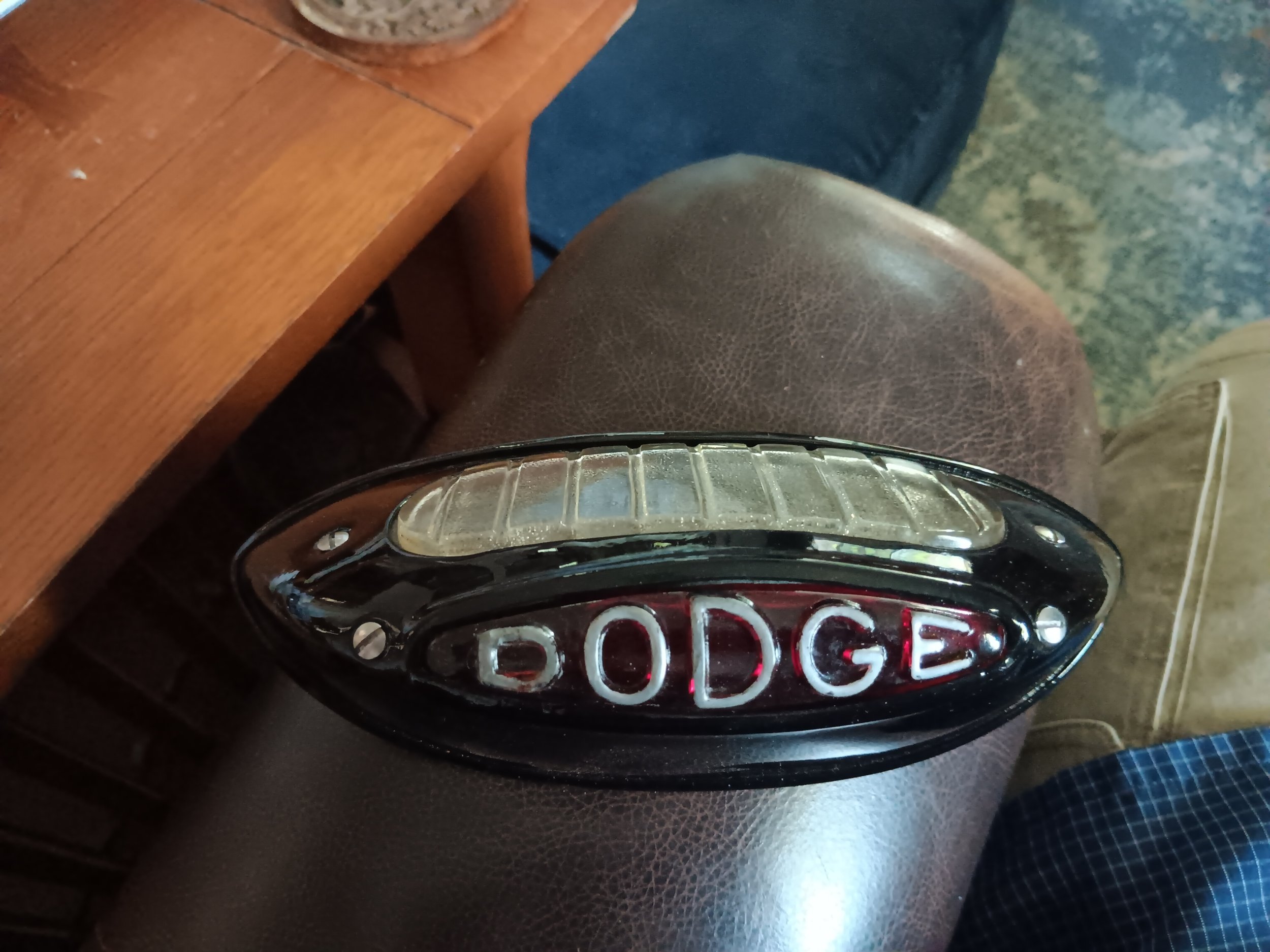

    20250903_085739.jpg my license plat light on my 38 Dodge. Making it my 3rd. Brake light.
