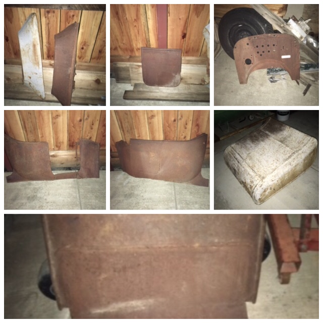

    Last year I bought a bunch of T stuff[​IMG]

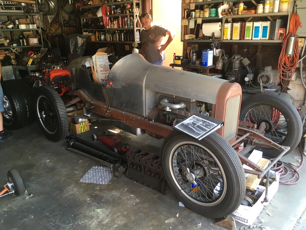

    I recently sold the Tourer and still have the original T chassis but I also have a bunch of other parts to build an A powered speedster. Just to use parts laying around - a low buck build. Then the other night on instagram Sam Strube had this 24 roadster body available so my speedster idea has morphed into a roadster like my 2009-2010 project[​IMG]

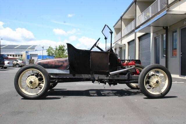

    Here's my previous one [​IMG]

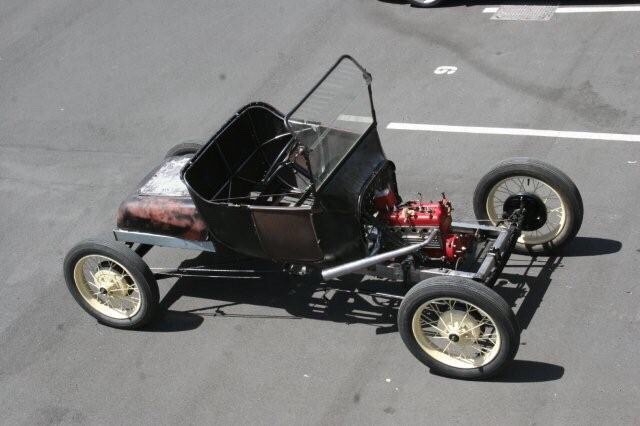

    Well my Model T Tourer went to its new home on Saturday...
    .... within moments I had this mocked up

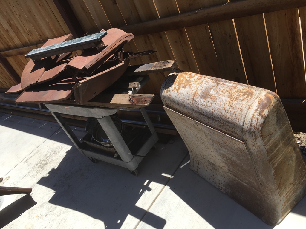

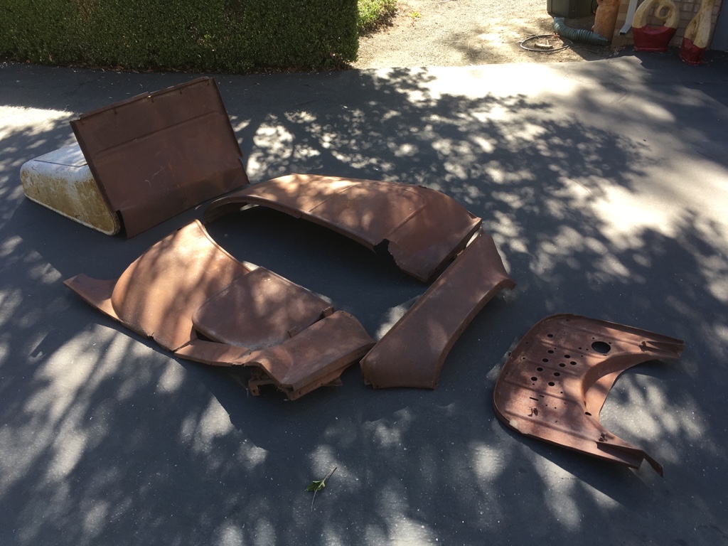

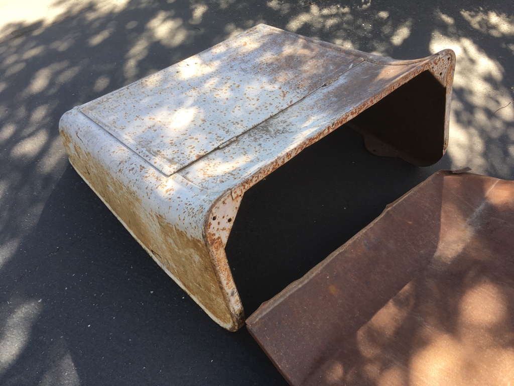

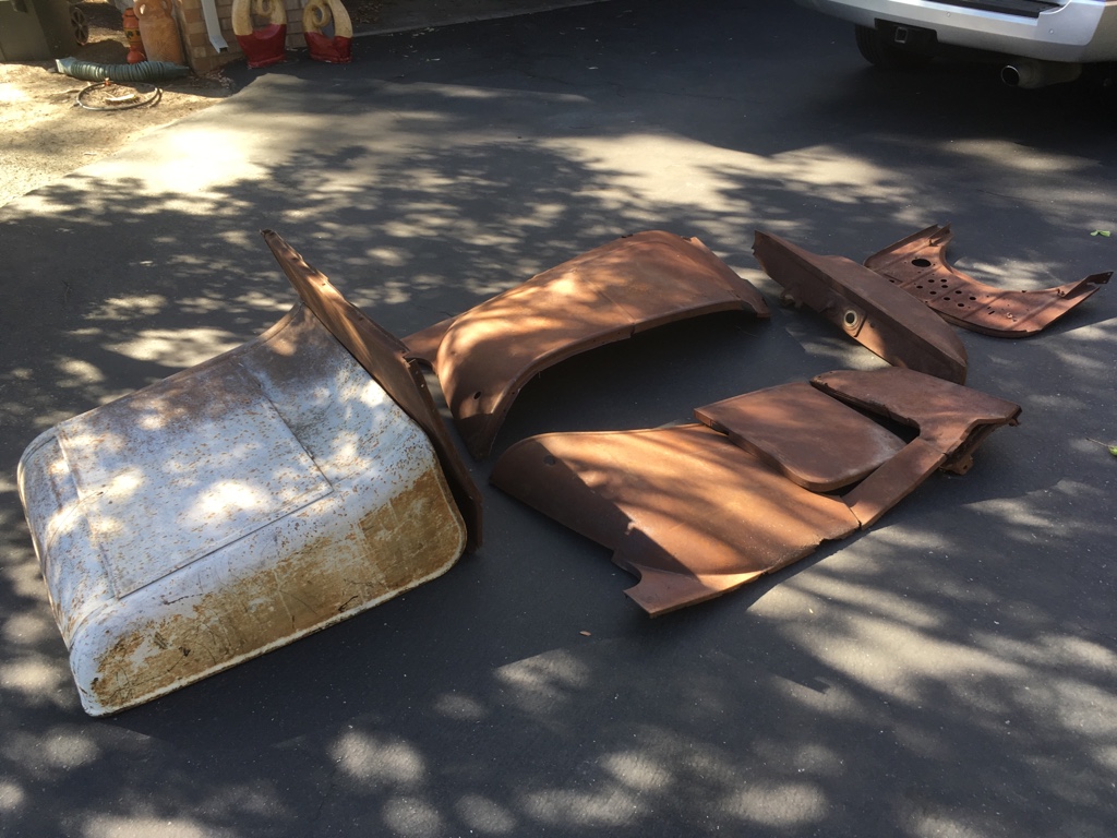

  13. On Sunday we went to Tracy, CA to pickup this 24 T roadster body from Sam Strube. Really happy with the turtkedeck and rear quarters.
    [​IMG][​IMG][​IMG][​IMG][​IMG]

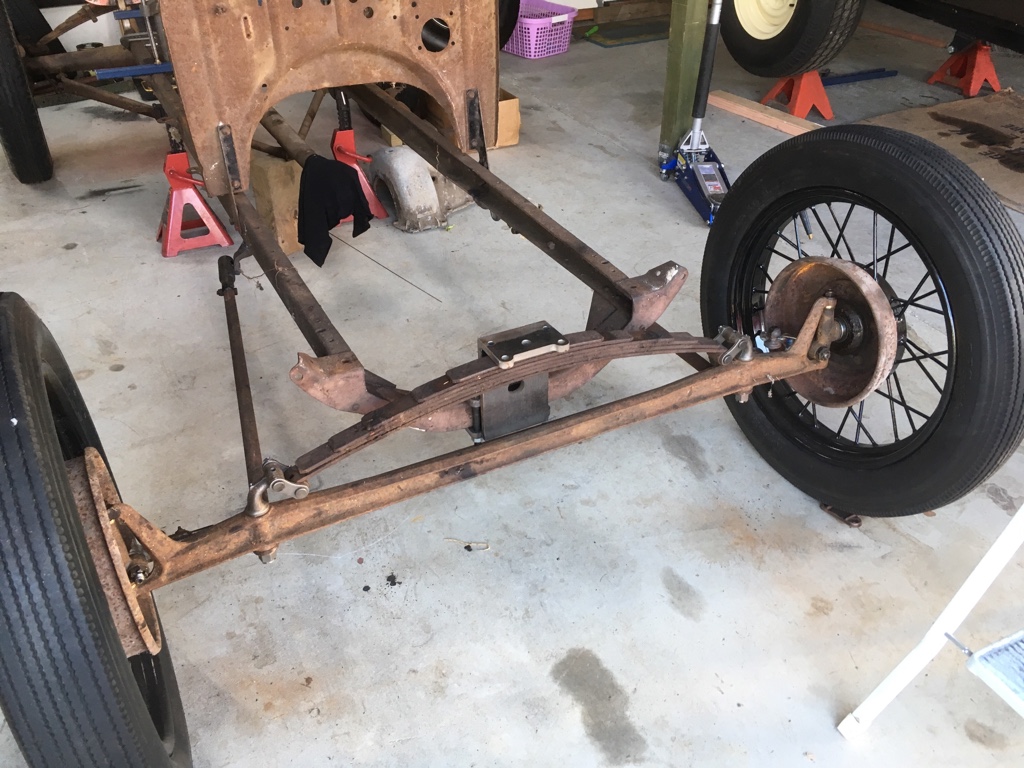

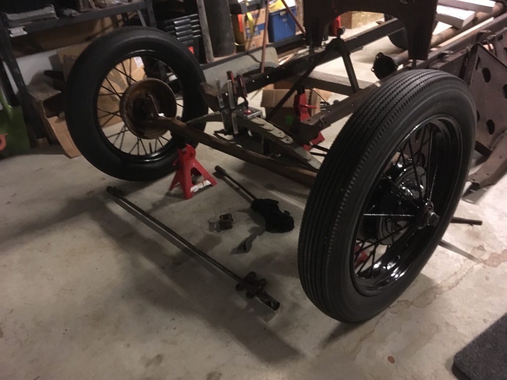

    Model A hubs on the T axle. Waiting for spring perches then I can get the front end sorted a bit before working out the rear end

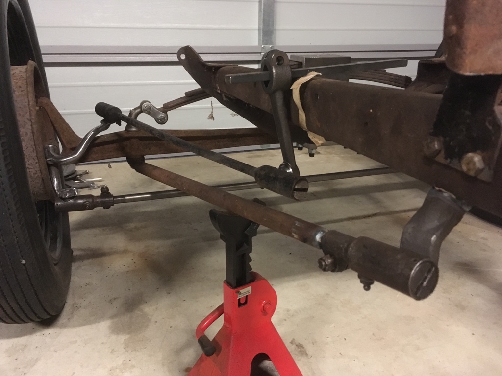

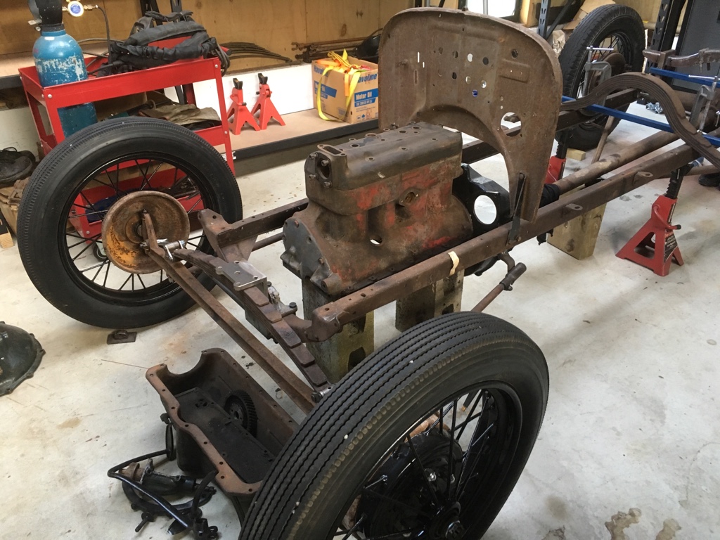

  20. Got the frontend finalised and will sort steering with the body on
    Motor initial mockup

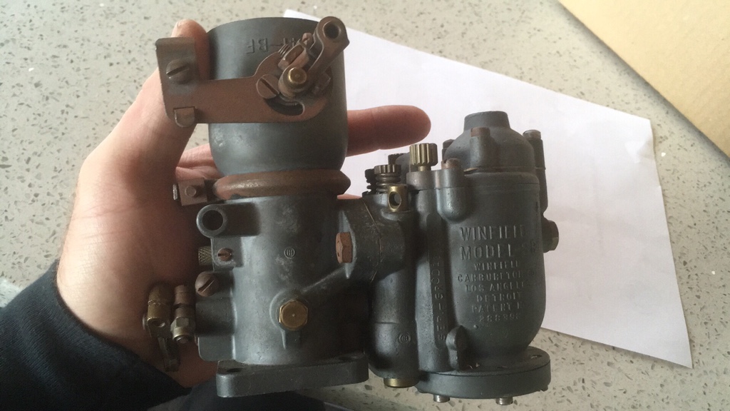

    Scored a Winfield SR carb for it as well

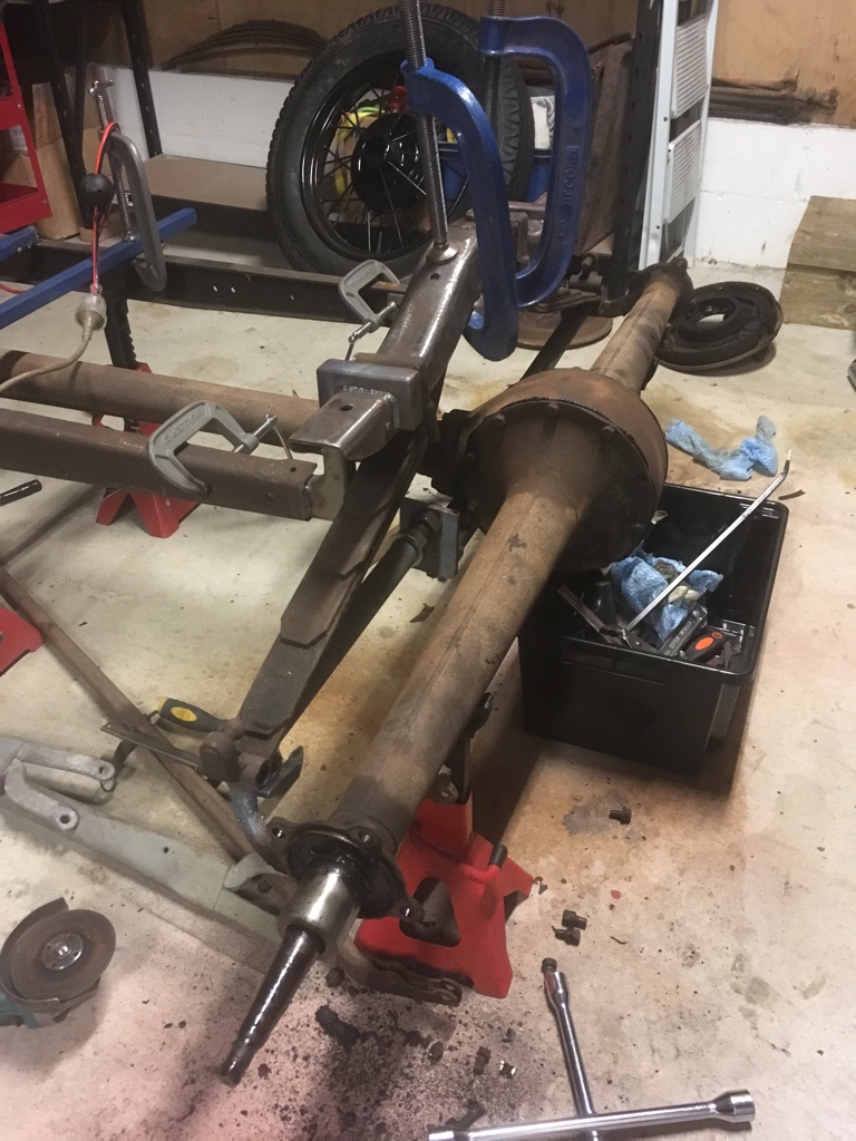

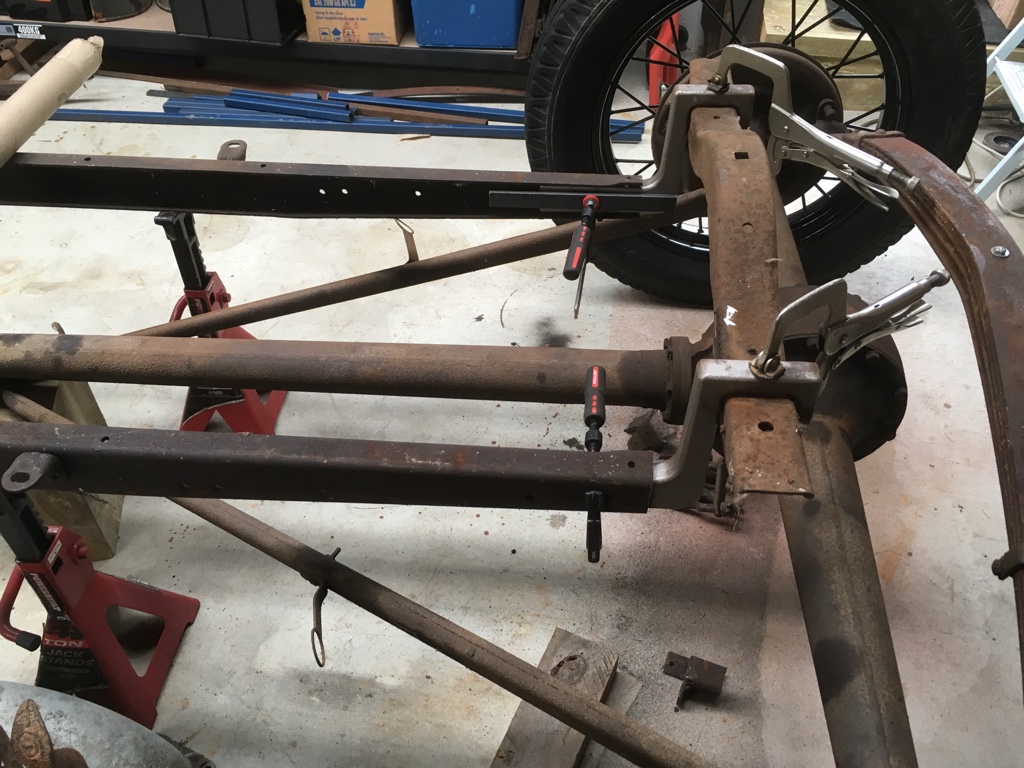

    On to the rear end - flip the axle housings side to side to get the T spring in front of the diff
