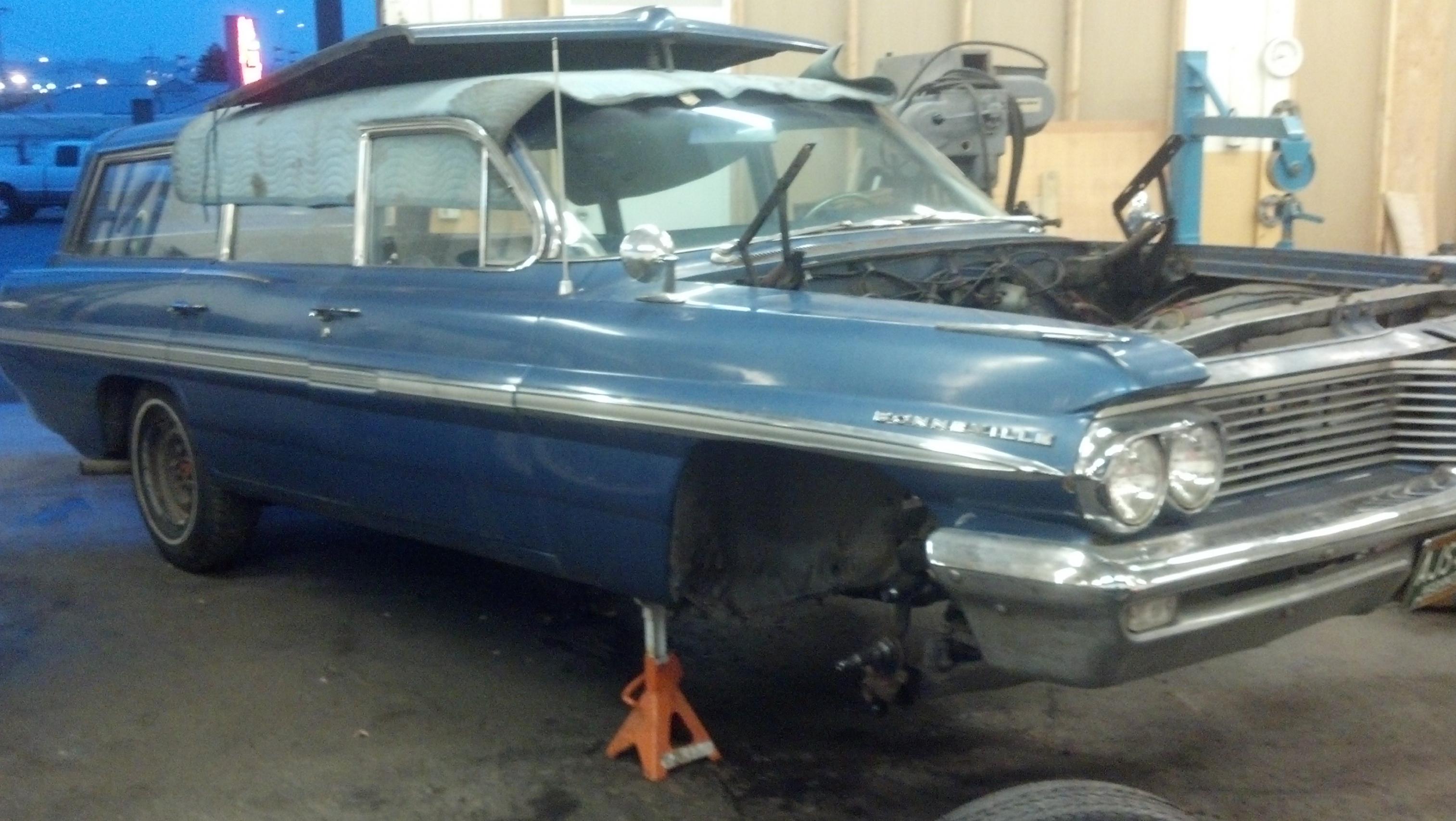

    Before you go too crazy on the headlights, make sure they aren't just burned out.
  2. rob-redm
    Joined: Nov 15, 2005
    Posts: 6,548
    rob-redm
    Pretty sure the dimmer on the floor is bad.

    engine and transmission (400 c.i. Pontiac with turbo 400) swap, brakes complete...front and rear

    Marshall/ THUNFIELD Rod & Custom has been busting his***** on it... brake wheel cylinders getting stainless steel sleeves , the power brake unit and master are getting the same stainless sleeving... HMMM Tom, what worked best Walnut , Oak or Alder , maybe Balsa ??? lol !!

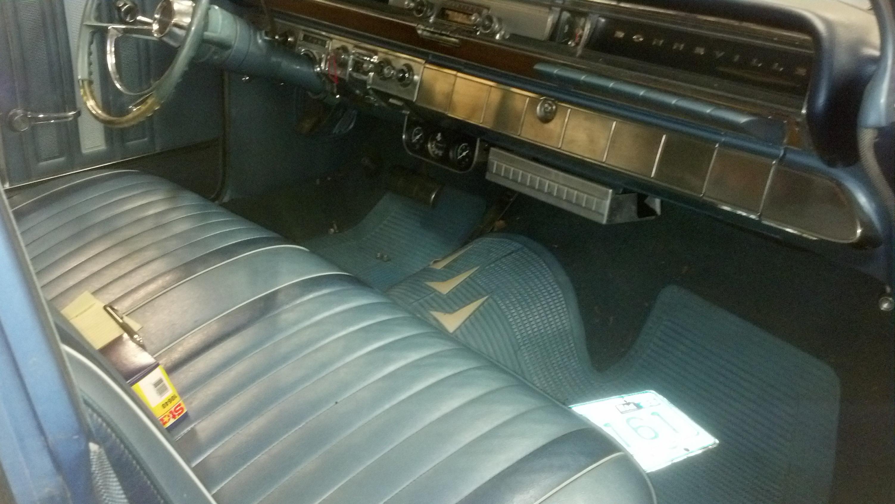

  19. NIce, I've always liked Poncho interiors....

    progress is moving along, still waiting for the engine and trans, the brakes are getting closer to being done. The heater core was repaired, radiator was junk.. new replacement was sourced. Thunfield Rod and Customs are busting***** on it.. :D

    So , I 've got a engine and trans from Solo here in the HAMB(thank you !!!), some 400 exhaust manifolds from Stephen.... Fuel tanks is cleaned and resealed, new radiator, recored heater ...

    Cool wagon...I used the E-T classic fives on my poncho wagon. [​IMG]
    Is the interior vinyl or leather. mine is cloth. And mine is the canadian poncho.

    My interior is tri-color vinyl, What size rims are you running front and rear ? I found set of new 15 x 7 and 15 x 8 American Racing T.T.O. I will have to sell off the rears and get two more 15 x 7, Going to run a 215/70-15 front and rear... ribbon white wall .. I was looking at a 62 Catalina convertible at show on Saturday and he was running that size tire with out a problem.

    Little update, Thunfield Rod&Custom busting*****. They separated
    the 400/Turbo 400. Doing engine detailing. Replacing freeze plugs,new timing chain(to be safe)
    New starter, flex plate,was missing a few teeth. New flex plate. Coming along!
