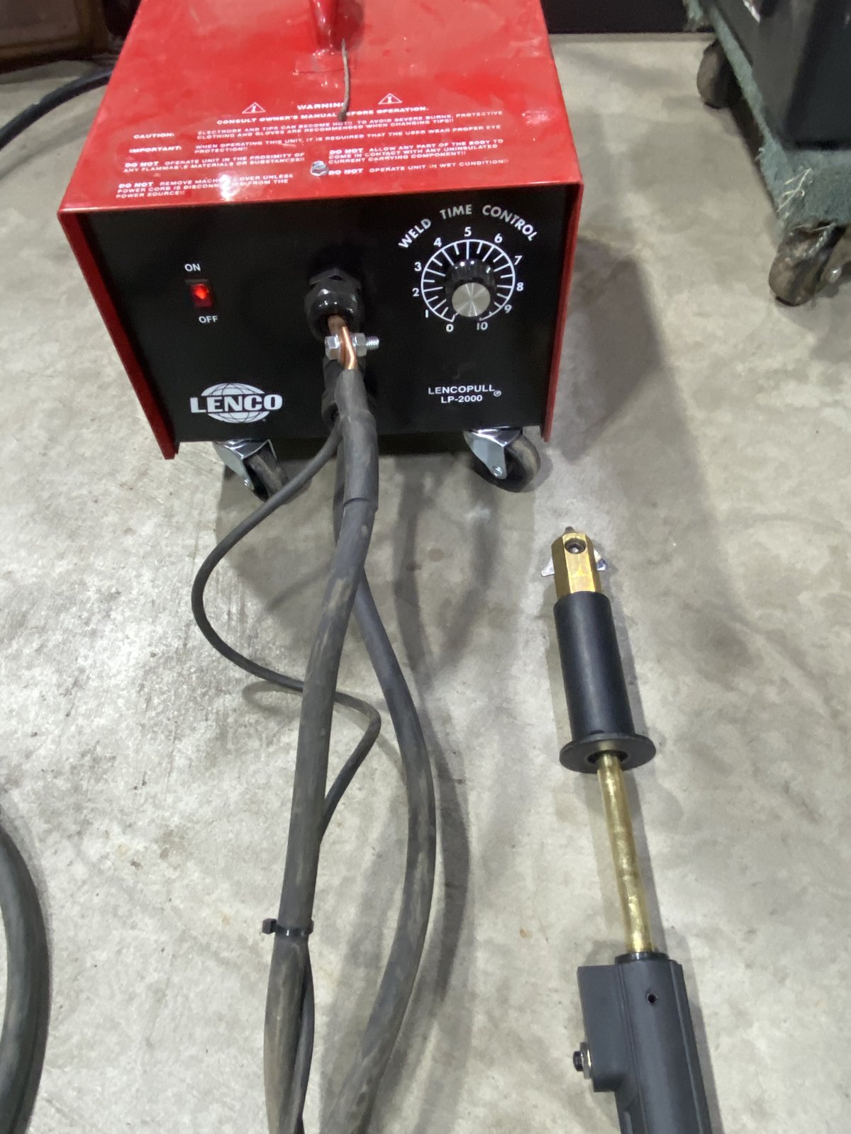

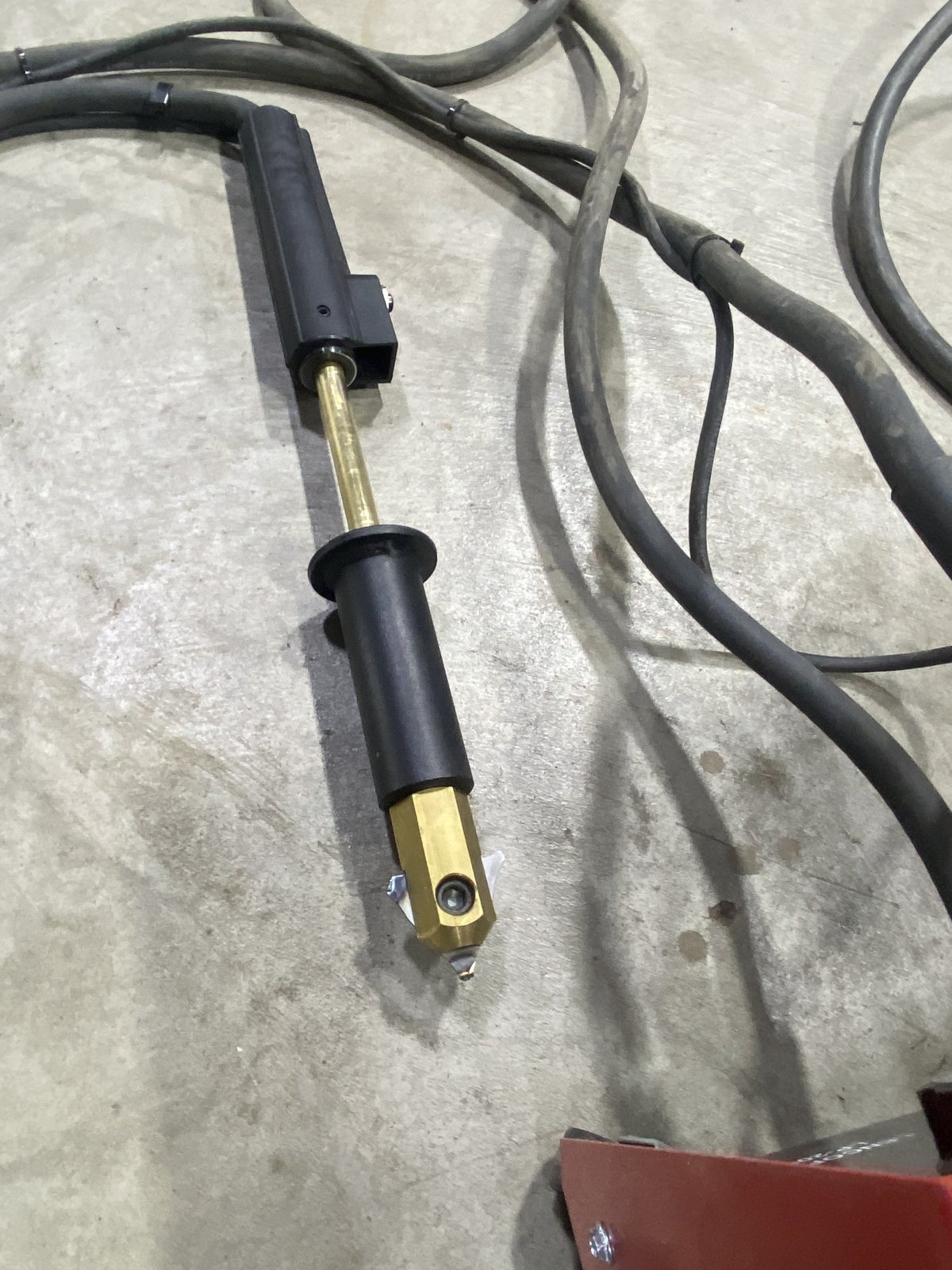

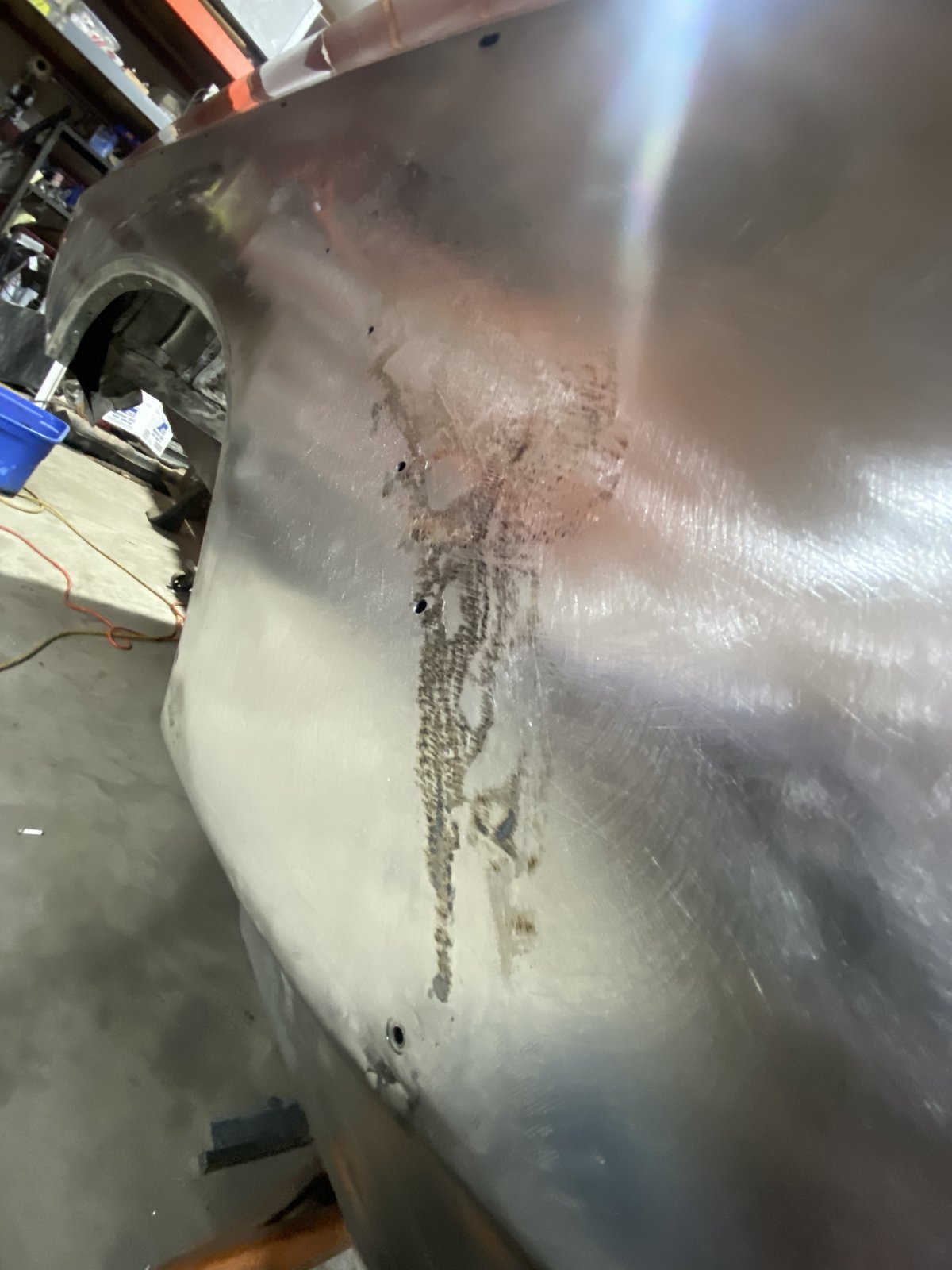

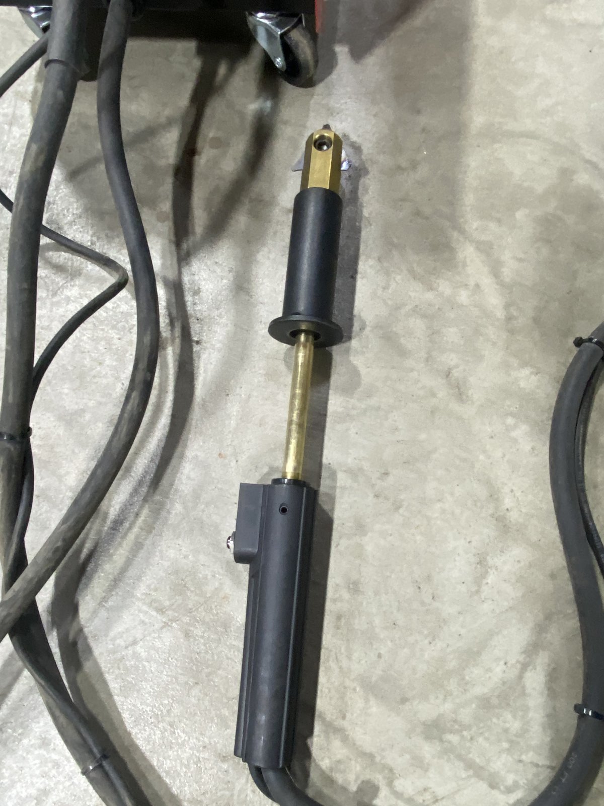

  1. This thing will shave days of your metal working projects. I’m kinda mad at myself for not getting it sooner.
    47,000 times better than a stud gun.
    FAST and virtually no scars. Hit the ****on, slide hammer, slight twist next spot.

  19. Also Works anywhere you can’t get a dolly, (there’s too many like that)
    Metal finish raising low spots. There’s no distortion, and virtually no scars left from it.
    Damn fast too. I do more panel work than collision.
