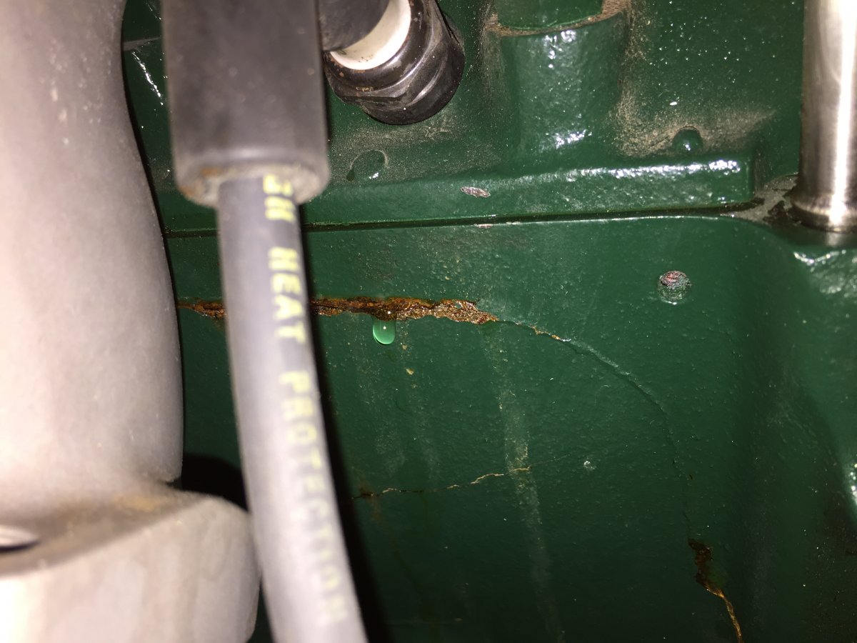

    I would think that finding a block and machining it to fit your parts would be cheaper then a crate motor.

    That's the thing with drag cars now, NO ANTIFREEZE allowed on the track. Then, when the season's over, guys forget there's only water in the cooling system; race motors are expensive too! Seems you're pretty much sold on the crate motor idea; sell the 327 for parts, or find a 4 bolt 350 block to swap the rotating ***embly into. That "yellow" block posted is more what I've seen; yours really wanted to push a large chunk out. Now, a Rambler Wagon, that's different.

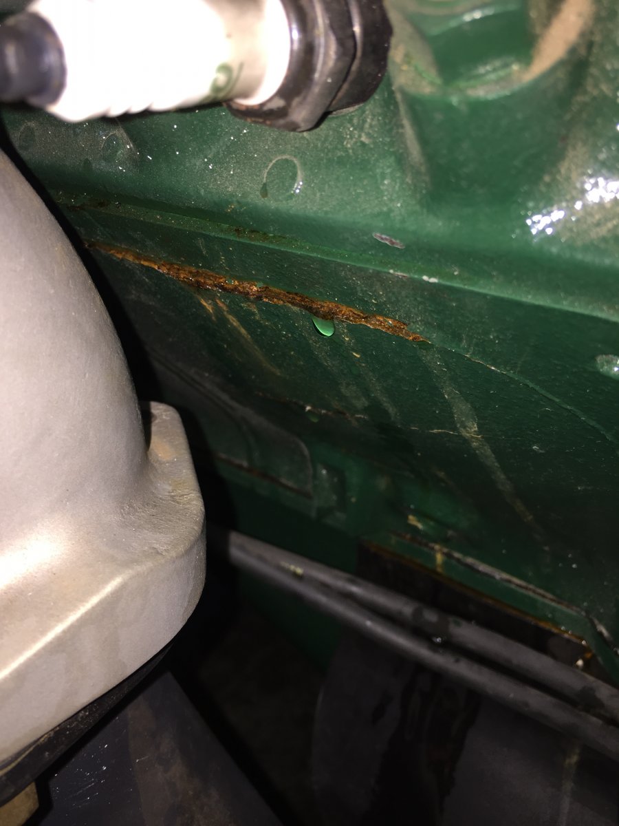

    Hate to say it, but that 327 block is nothing special. Find you a 350 block and swap internals- as many have said- and you are back in 327 business. Easy peasey.
    Interesting pictures- I recently got a block that had a crack similar to yours- horizontal just below the deck. First time I have seen one crack like that. I verified the one I had is cracked using crack check sprays from the welders store and got my $ back.
    cjsavage and Fordor Ron like this.

    Yup. Call your local machine shop. Mine could find a bore-matched block in about 90-seconds.
    A few hours of fitting/checking parts, and you are back in the game, and not for big money, either.

    If nothing else froze up that gets me to thinking it was a bad block from the beginning and a slight freeze finished it off,even if you had removed the water that crack might have shown up the first time antifreeze was put in but not as large of a crack.

    That is very doubtful.
    The power of freezing water is beyond what you may think and will destroy the strongest casting you could throw at it.
    I think that the block was fine and wasn't what you suggested it might have been.

    I bought a truck with a cracked block and the water in the block was completely froze up and the crack was not as bad as that one,this truck was sitting outside where this one was inside and out of the elements and I drove it 3 years with only minor seepage.

    Grab a 350 block and bore to your pistons, gaskets bearings and rings. Or go buy a short block from your local rebuilder put your stuff in it. Crate motors ****.

    Back on the mend. It does make me a bit sick looking at the sedan torn down but it should be short lived. Bought a new g.m. performance 300 horse 350 from Karl Chevrolet. IMG_1784.JPG IMG_1789.JPG IMG_1814.JPG
