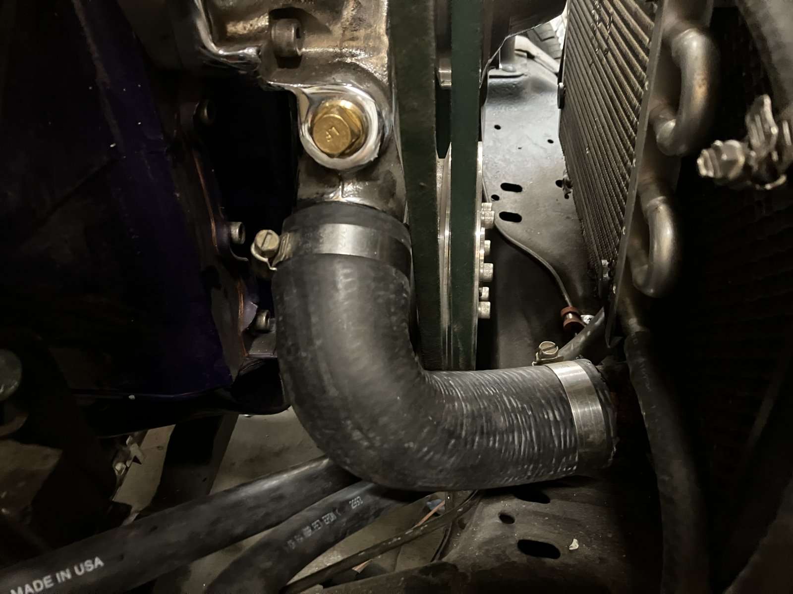

    So tell me. Is there anything in hot rodding more thrilling that to find the perfect radiator hose for a tough application at O'Reilly?
  2. I am just about to see if my wire template was true. And only after sifting through about 50 hoses! But I have a section of metal tube ready to splice into the middle -just in case it needs a tweek.

  18. Winner! A 1" trim at both ends, and on it went!. I'm not doing anything more today, I've used up my good luck quota for the day.

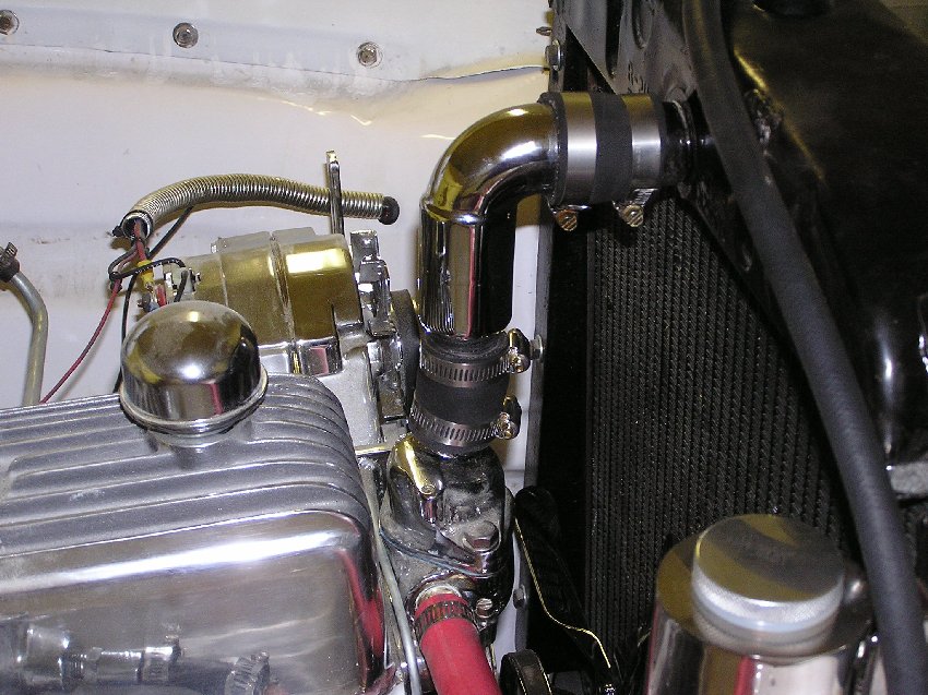

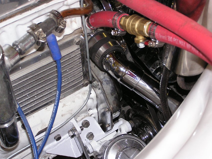

    I agree. I have cut up a lot of hoses to get the right shape but, not to hijack your post, when all else failed, I had to make this 100_1637.JPG one. I was very satisfied with the outcome

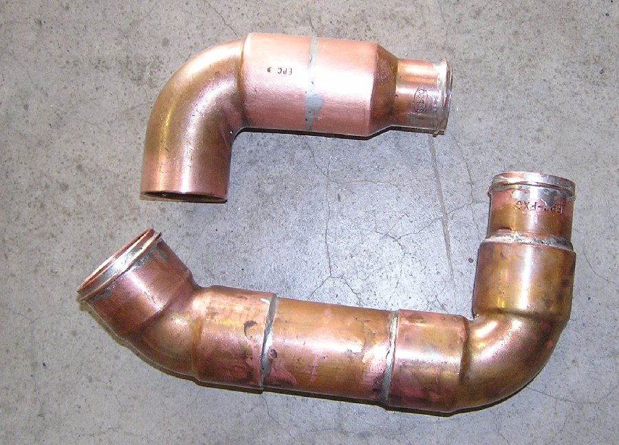

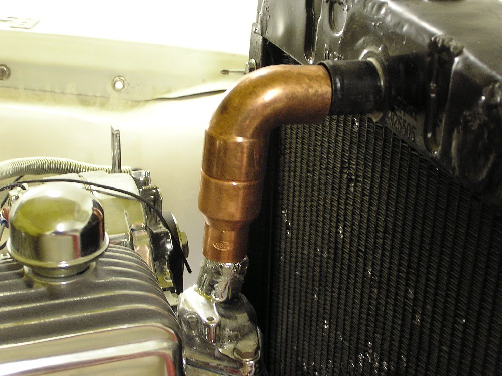

    Been there, done that!
    Chrome bottom.jpg Chrome top.jpg Bottom hose mockup1.JPG Top hose mockup.JPG Finished soldering.jpg

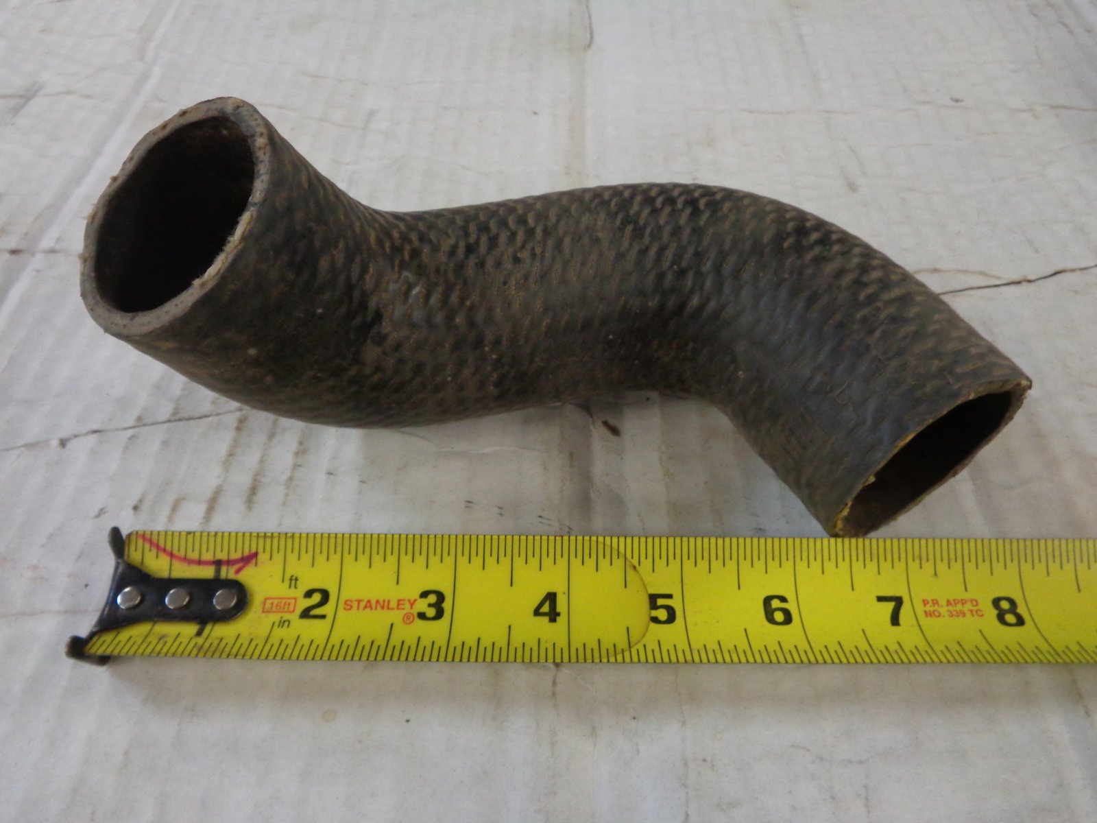

    Getting the lower radiator outlet changed to 2" dia. made finding this section of a hose a lot easier. L/side is the w/pump end, R/side is radiator. When in position it will fit in a 6 1/2" tall,6" square box.
