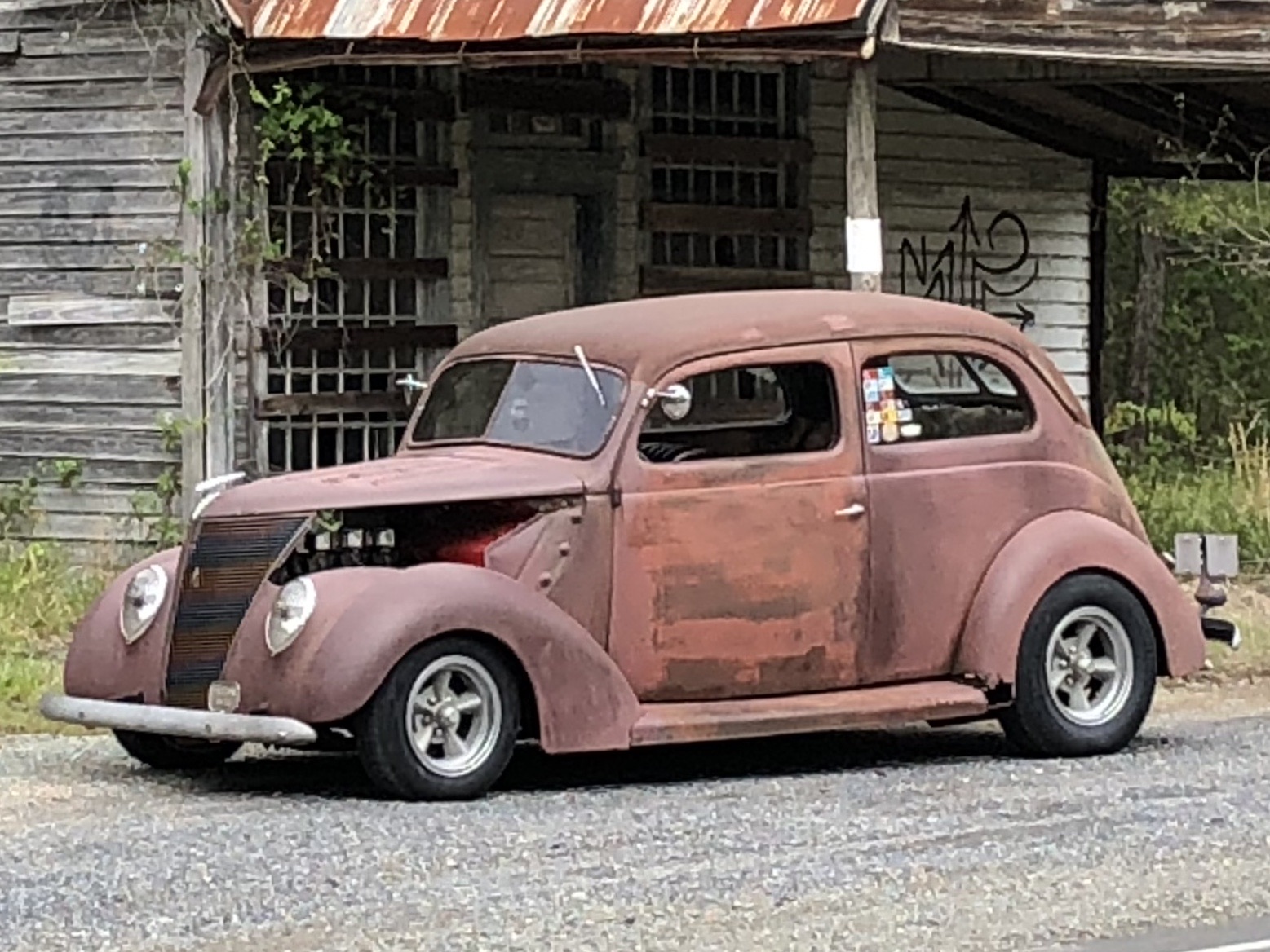

    THIS IS WHAT HAPPENS if you strip to bare metal, and just put primer and no sealer or paint...might as well add wet sanding stripped cars to the pile'''
    ANY QUESTIONS????

  2. Yes, is that a four-inch chop?

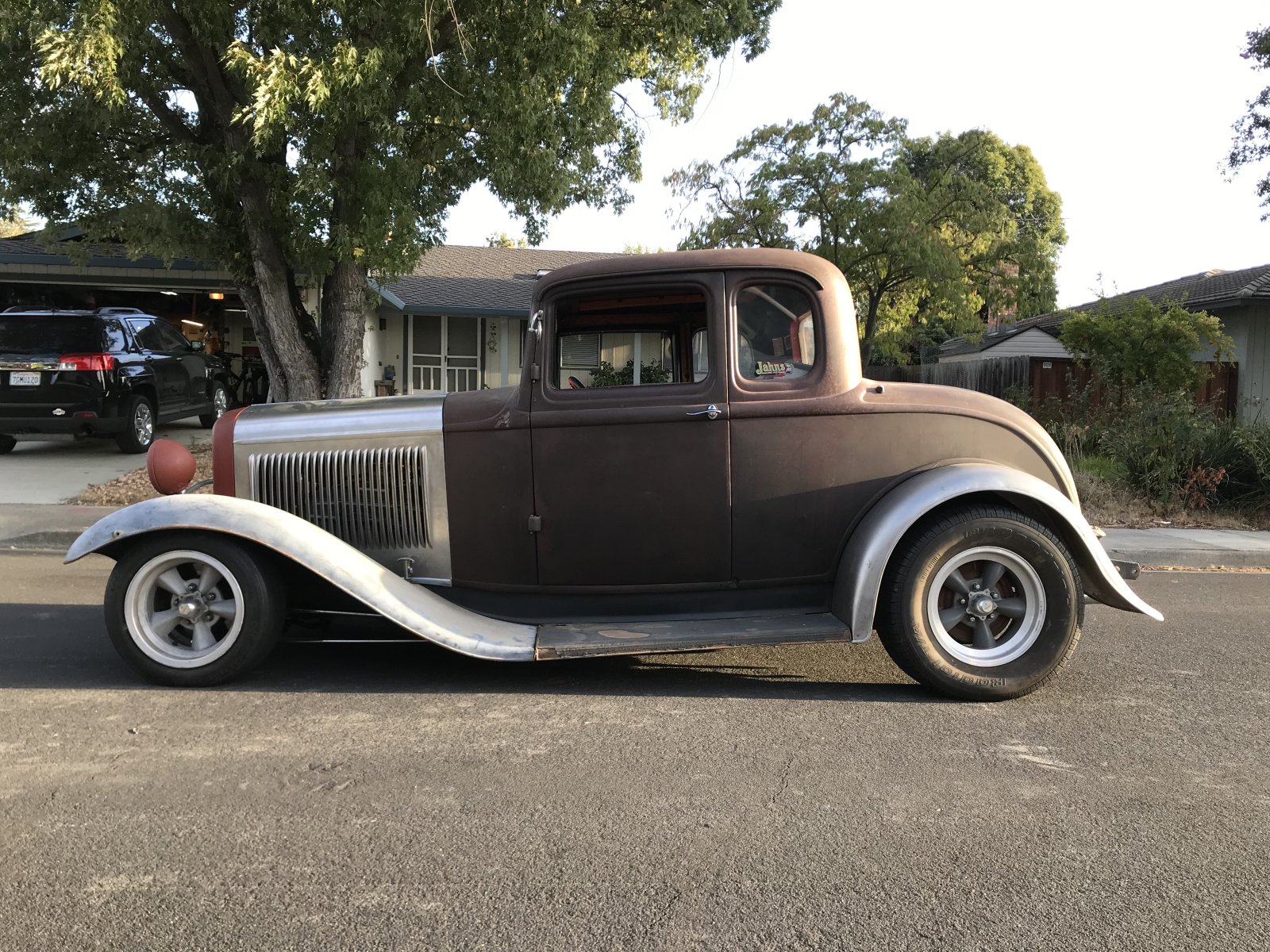

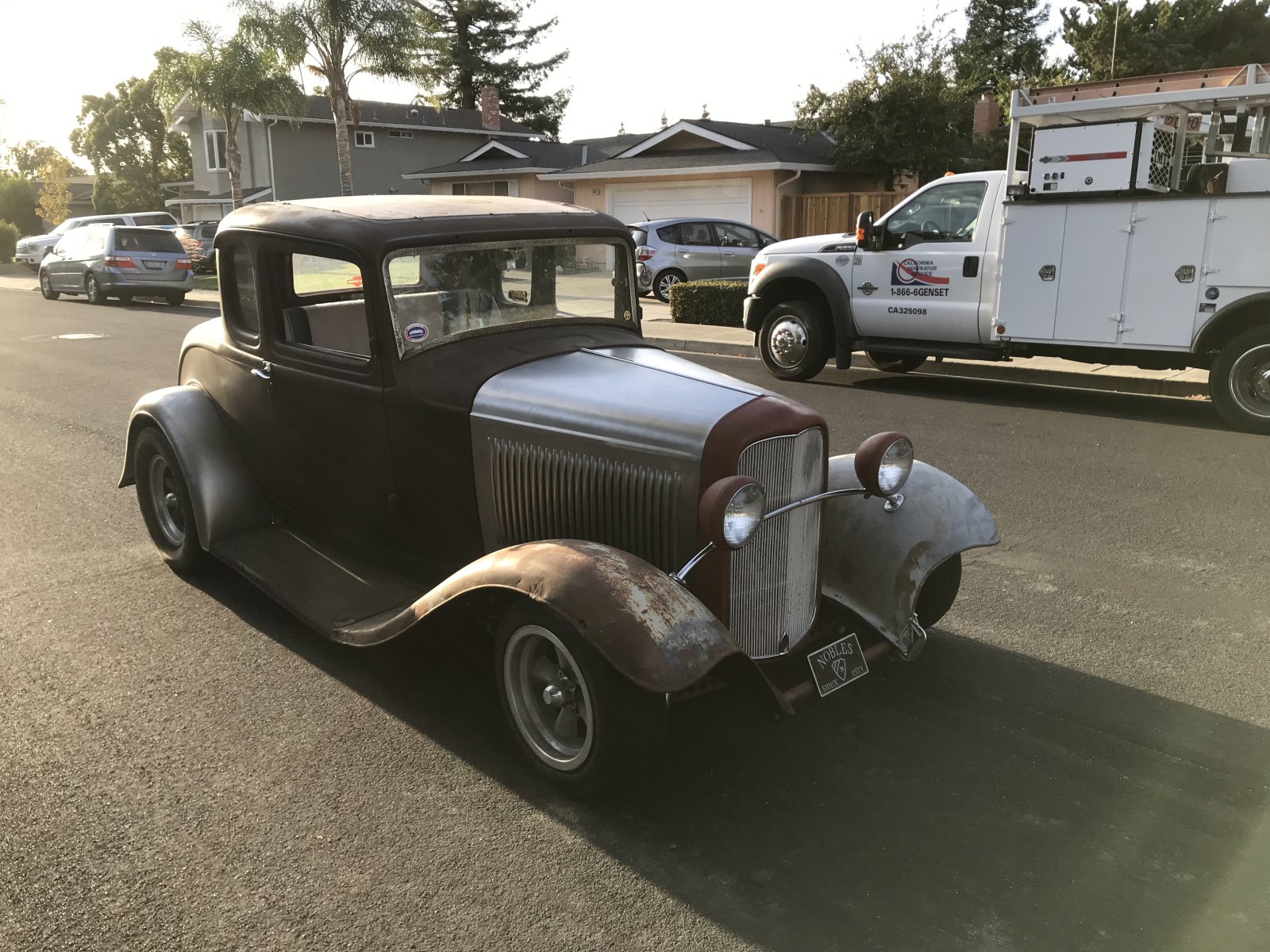

  12. Looks great
    I’d run that look.

    I can vouch for that, primer only will be see through in no time when exposed to the elements

    They don't get any better if you let them sit outside either.
    That is not frigging patina either.

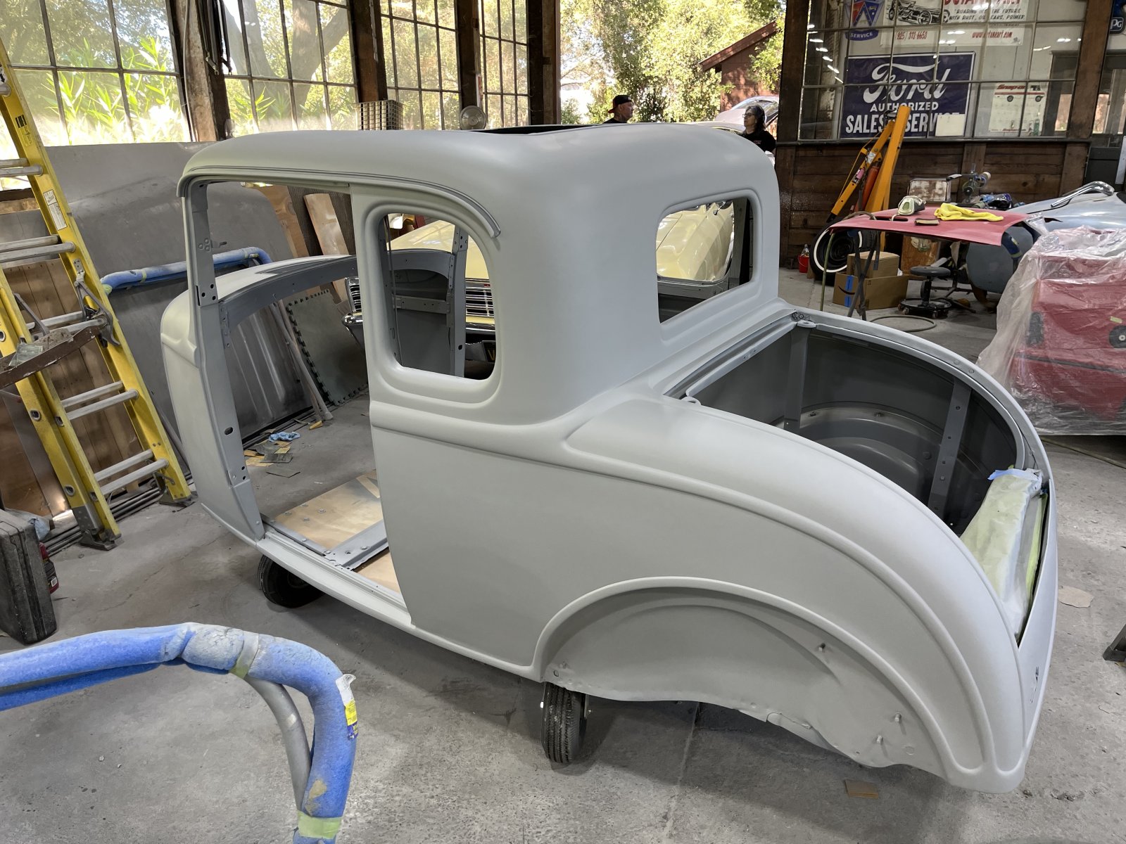

    Blasted and primed going to paint. No bondo, very few pin holes, almost zero rust IMG_6972.jpeg IMG_6973.jpeg 74553446996__B9937159-AE2E-447E-A9FF-7770D9A865FC.jpeg

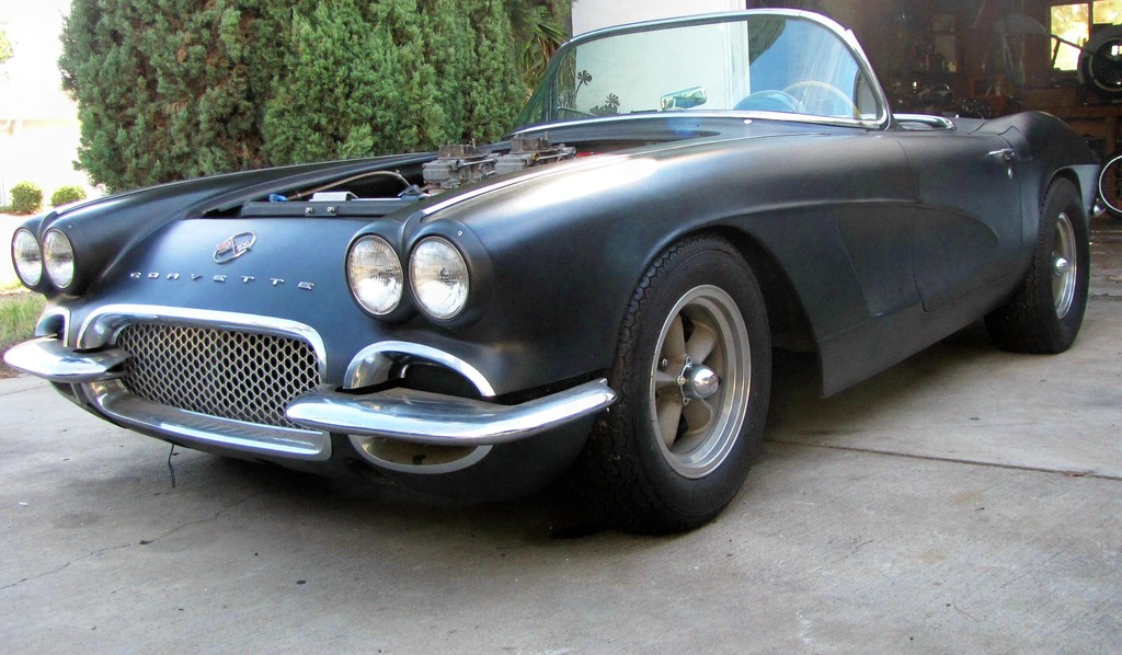

    Man! Those two old 'vettes look like rocket ships!

    what primer is that??? I wouldn't paint over it un less I primed it ,.. in fact, I wouldn't paint the car even if I did prime it..... most the time people use surface primer and not DTM.... biggest problem I've seen is not only pro painters and home painters is they try to be chemists...if it says don't do it on the can... theres always those who say I did it and nothing happened...
    the best thing to put on a bare metal car that you have no intentions of painting for a while or even 10 yrs or more down the road... and wanna protect the metal is BEHR exterior paint/ primer...you can pick the shine , egg, simi gloss, flat... and you can roll it on.. or spray it with a harbor freight HVLP if you drill the tip... and also get it tinted any color you want... and water clean up...

    It’s going to paint hopefully next week

    the second part wasn't to you, you no doubt have a good painter picked out... more what I was say'n was to the DIY 'rs.... people dive in to stuff like stripping a car that they don't have the money to get it painted but wanna do something... so they buy sand paper and spray bomb primer...

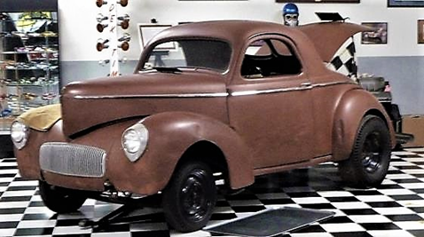

    Years later, with the memory only in my head, I was wandering around a set up day at the new Lion’s Dragstrip Museum and saw a red painted 1941 (different grill) Willys Coupe sitting there on display. Red primer black wheels and a tow bar that looked exactly as our did, due to the attachment position of the bracket. Behind the red primer Willys Coupe on display was a 671 sitting on an old SBC motor.
    upload_2024-10-13_3-31-12.png Red Primer... what a small world... YRMV
