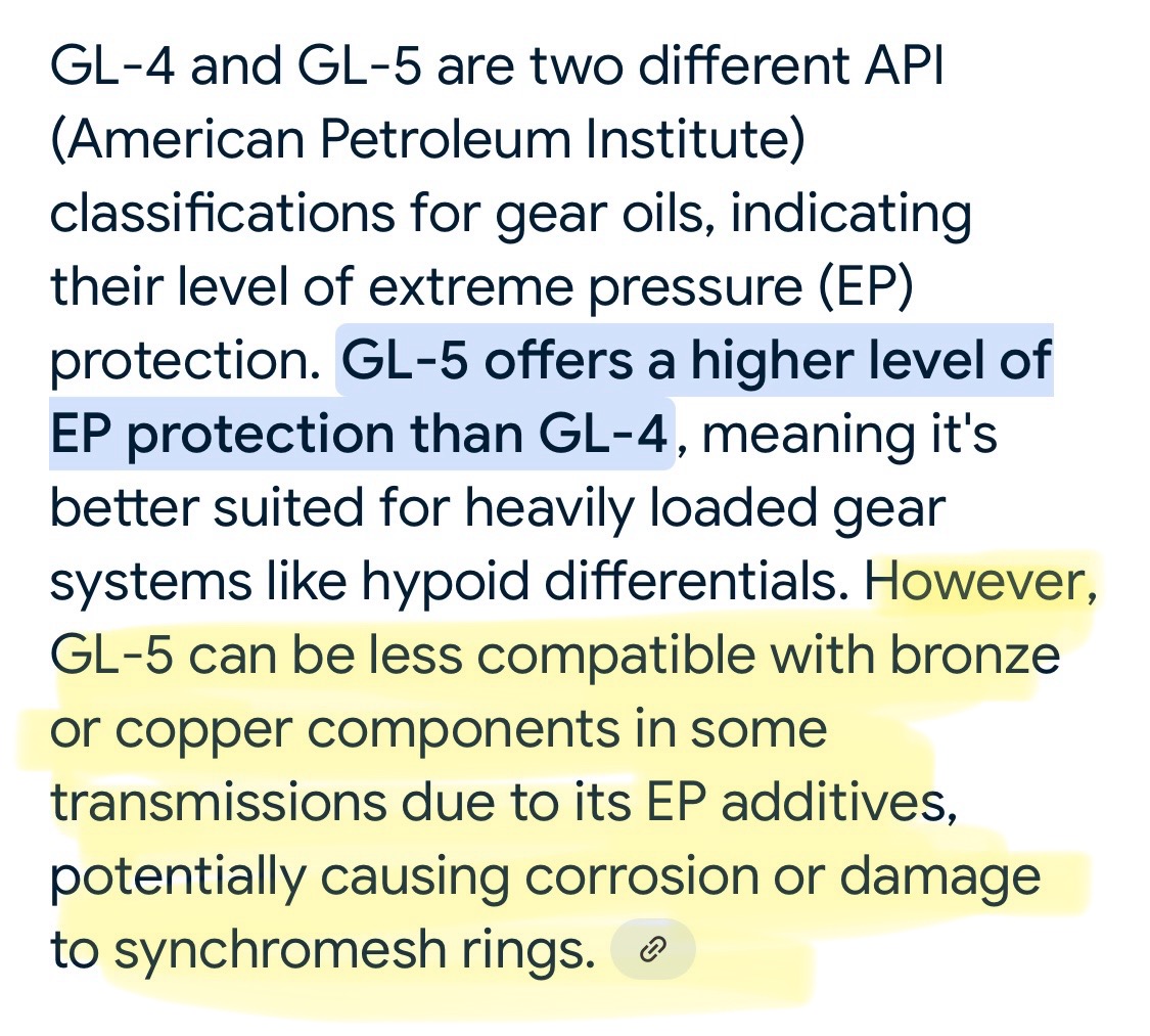

  7. Went to the local Napa and all they had was sta-lube GL5. tried telling me that it replaced the GL4, but, that's not what I've seen on the net. Now that I put GL5 in the trans, All the comments say stay away from GL5.

    The only issue I'm aware of with GL-5 is that some of it contains anti wear additives that can discolor "yellow" metals, such as bronze synchro rings. It won't make the transmission act like the clutch isn't working! especially in a few miles.
