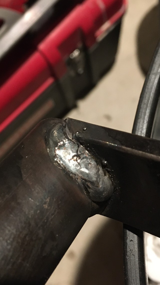

    Same with the Z-bar, over the years the factory welds start fatiguing, after rewelding, some reinforcements should be added.

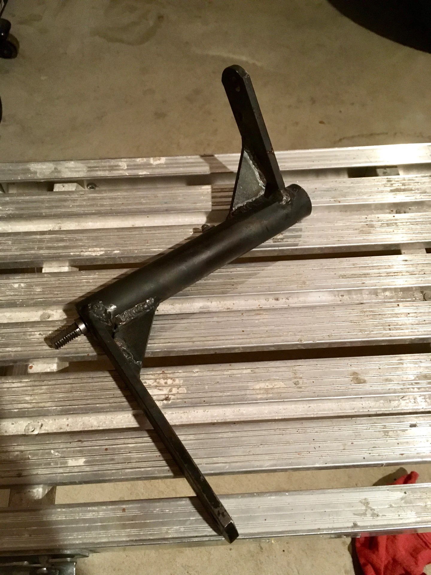

    With the Mopar performance stuff I used to deal with, you had to work really hard, or didn't pay any attention at all if you put the clutch disc in backwards, you could barely get the pressure plate bolted on, the disc was against the flywheel bolts (or, maybe I was lucky and tried it with just the one with the stubborn disc & pressure plate ***embly o_O).
    I did have a Z bar self destruct once, in a traffic jam at the Car Craft Nationals in Indy. That was quite a deal. I managed to get it stuck together enough to work long enough to get us through the weekend and back home, with a borrowed welder and welding rods that were sitting in a can of water! Once home, I built a new Z bar for the 65 Barracuda with a v8 4 speed, cause I sure couldn't find a good Z bar for it in 1984.
