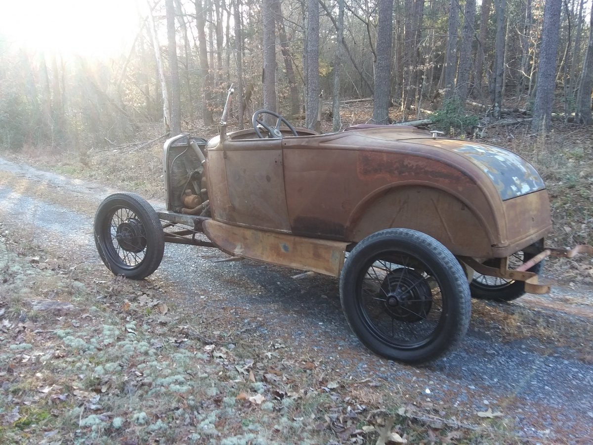

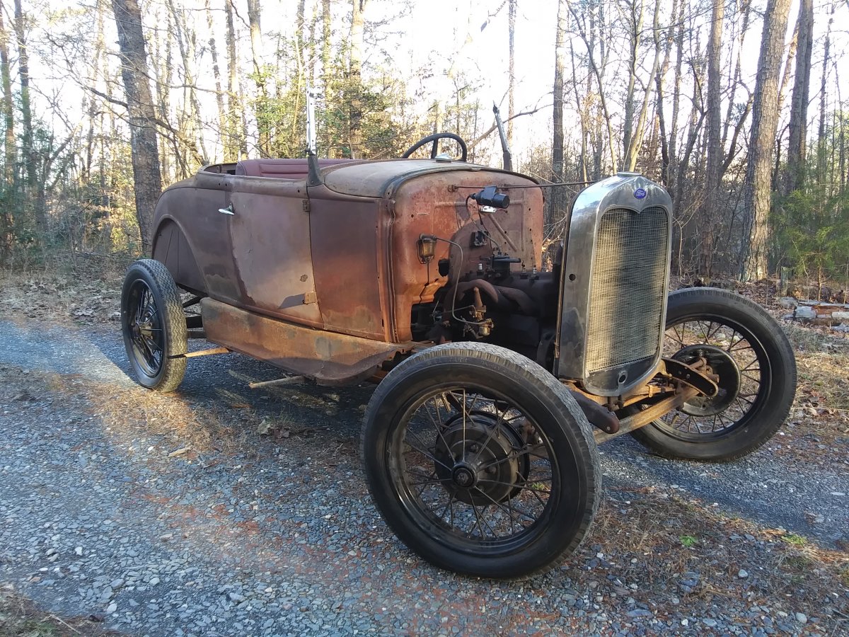

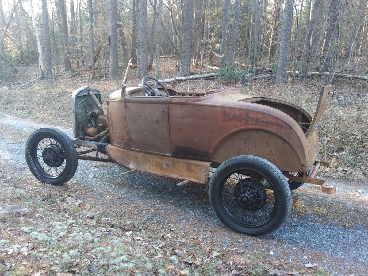

    Since I can't really do anything while I'm waiting on the carburetor I might as well try to make it look like a hot rod. Off with the fenders! 20200119_163516.jpg 20200119_162543.jpg 20200119_163539.jpg 20200119_163516.jpg 20200119_162543.jpg 20200119_163539.jpg

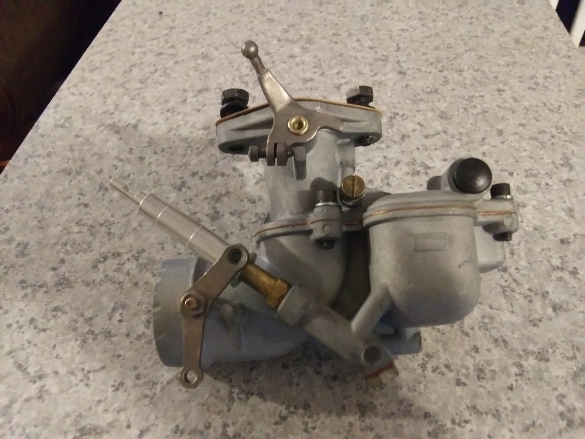

  29. JunkCarJesus
    Joined: Dec 31, 2019
    Posts: 39
    JunkCarJesus
    I don't have a GAV. I tried tying the enricher up a little with a wire but I don't know if it made a difference.
  30. dwollam
    Joined: Oct 22, 2012
    Posts: 2,809
    dwollam
    Tillitson carbs have a GAV. To adjust it, screw it in by hand til it bottoms out. back it of about a half turn. When you pull up on that same valve it closes the choke ****erfly. You should see a "flat" on the end of that with a notch. That is the GAV. Without something to keep it from turning the mixture will change. Search on a Model A site for how to set idle mixture and the GAV and the timing. Zenith carbs were original, Tillitsons are after market but many think they deliver a bit more power. I run them myself.
    Post a good pic of the carb.
    Dave
