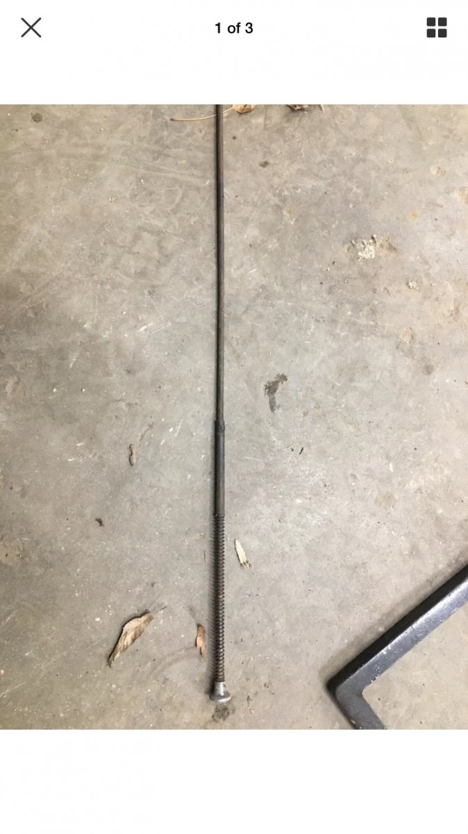

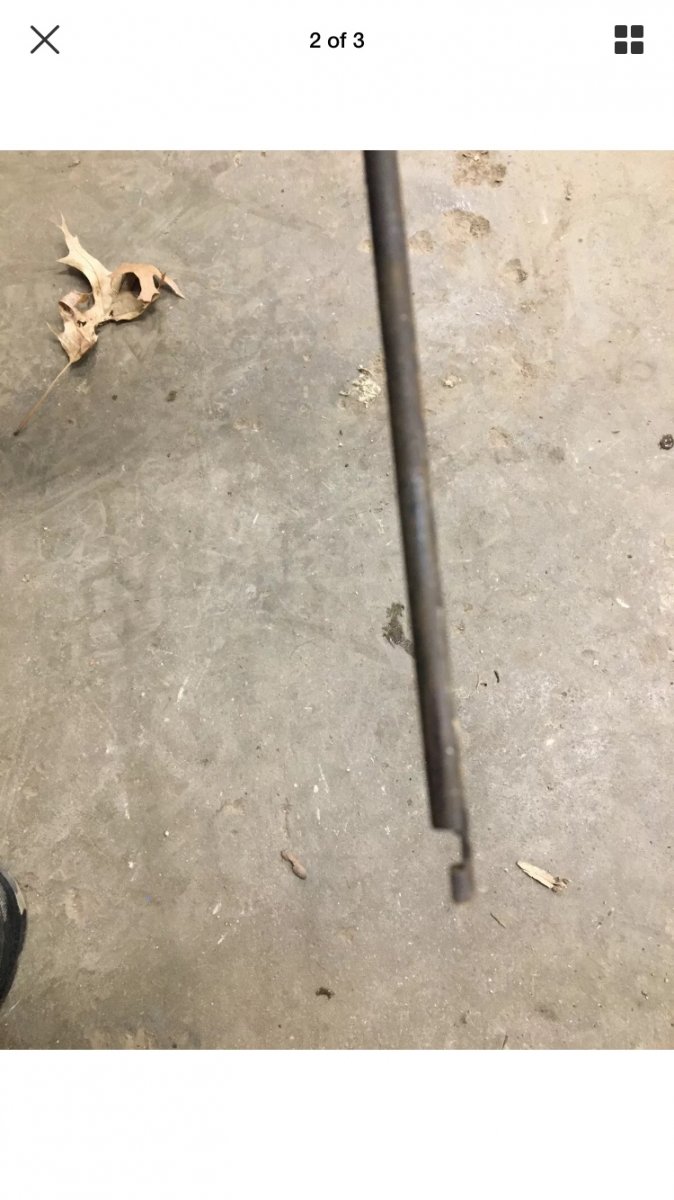

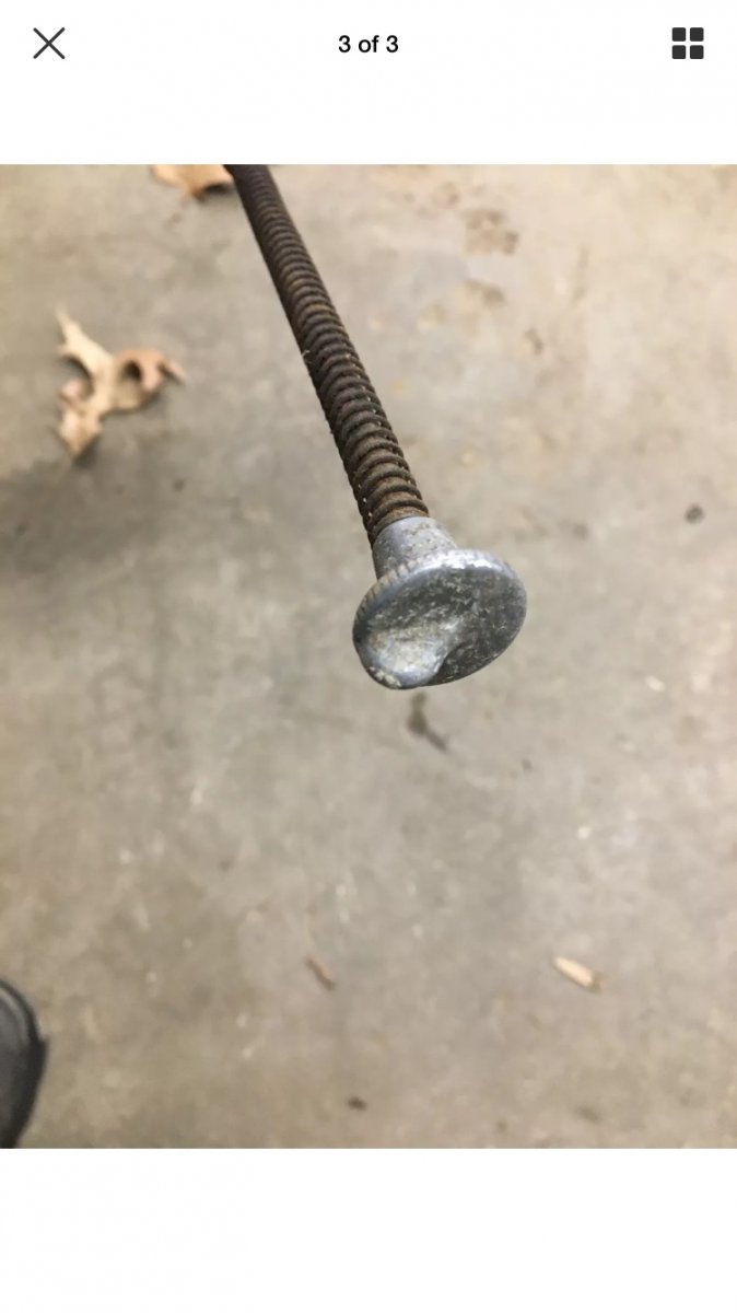

    It definitely has a GAV I just don't have the choke rod. It was missing when I bought the car.

    Picked up a couple more pieces to the puzzle. I scored this 32 shell last night thanks to jonnybright and my friend came through on a choke rod today. To all of you saying check the gas flow from the tank, you were correct. I ran it out of gas last week and I guess some crud got ****ed into the shut-off valve. I blew some air backwards through the line and now she's running like a champ! I finally got to take it on a successful test drive. I'll post the video in just a few.

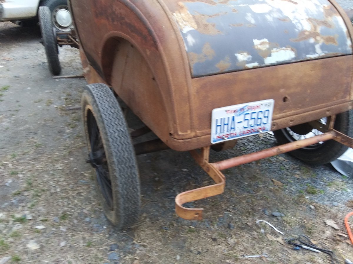

    I should probably fix this. Does anyone know if waterproof grease will slow it down until I can replace the water pump?
  17. Have you tried to tighten the nut? I believe there is a lead gasket/bearing that you deform and tighten around the axle to stop the leak?

    I couldn't get the nut to move. I'm going to try soaking it in pb blaster.

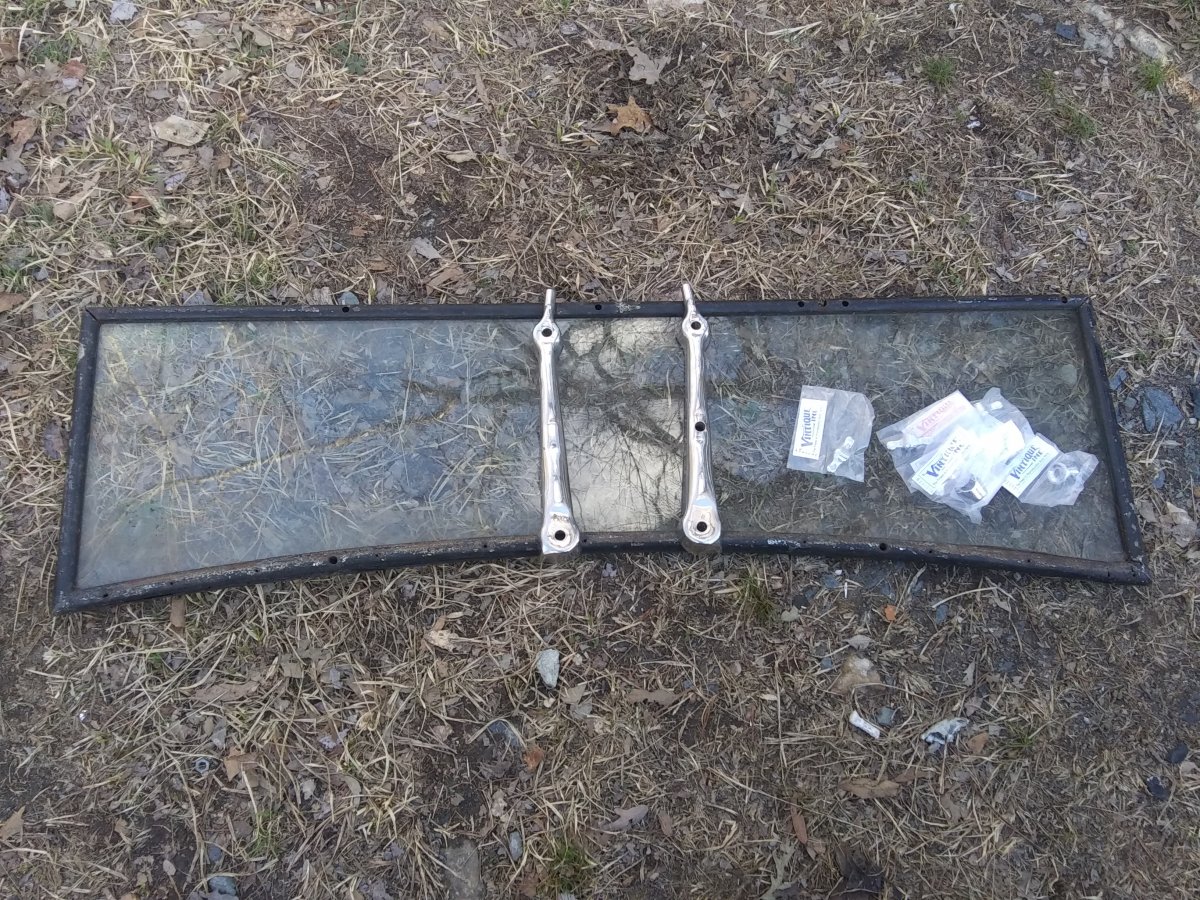

    Finally got the hardware so I could mount the windshield. A combo of reproduction parts and original parts made it much more complicated than I had anticipated.

    There's a few pics of the gl*** installed. Now I've got to figure out a way to clean it!
  25. Might I suggest using Windex?

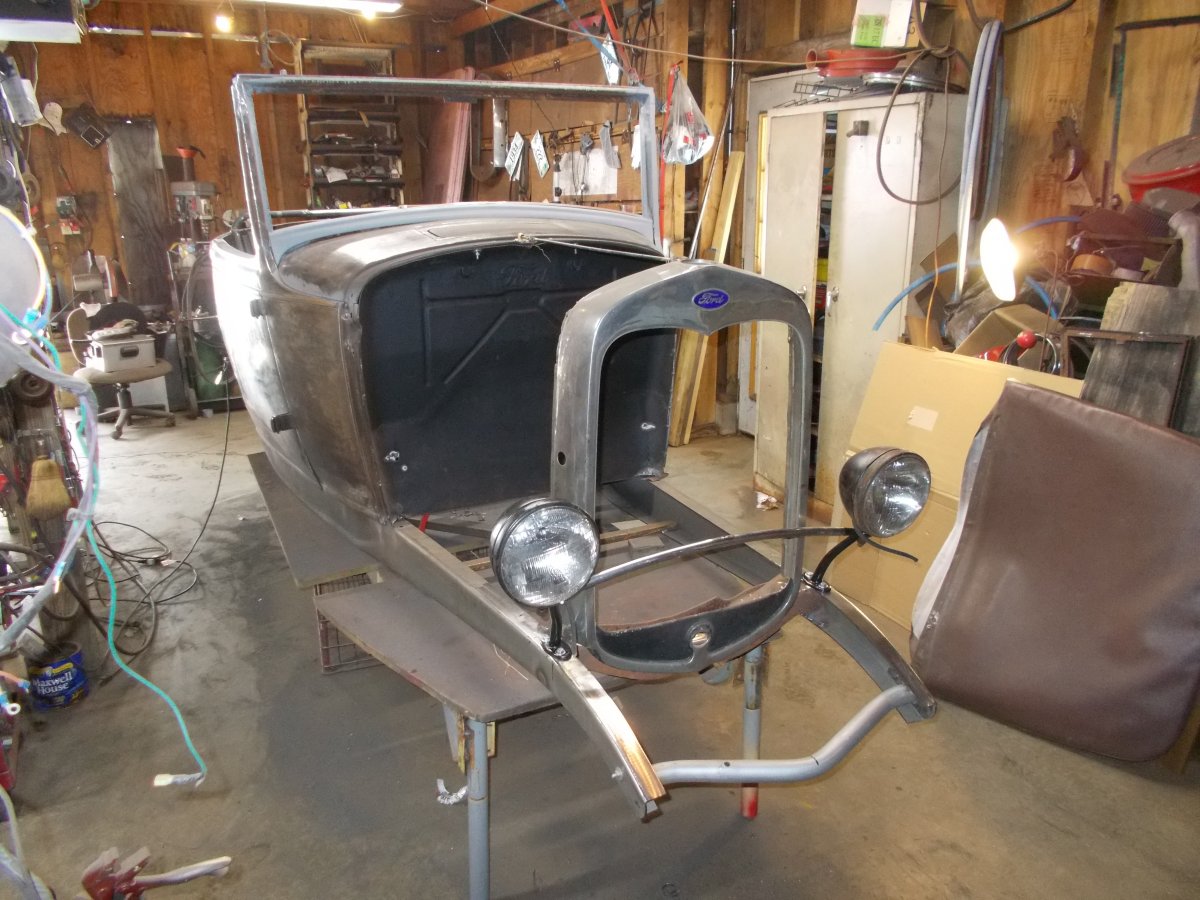

    Time to get some lights on this thing. I started out by cutting the ends off of the stock headlight bar. A little convincing with the torch and they worked perfectly. I'll change out the hardware as soon as I have a chance. The taillights are just some cat eyes that I had laying around. They too are temporary. Now it's time to take her up the road... 20200311_181733.jpg 20200311_181744.jpg 20200311_190543.jpg 20200312_094044.jpg 20200312_100313.jpg 20200312_104734.jpg 20200312_104728.jpg 20200312_180240.jpg

    when you cut that bar off maybe leave half of it with each cup... it is handy as leverage when twisting the light mounts …. I always tilt the cups down [tilting forward] or the lights won't adjust low enough to work...

    Yea I learned that the hard way. I ended up using a big adjustable wrench. Made it difficult to make each side match.
