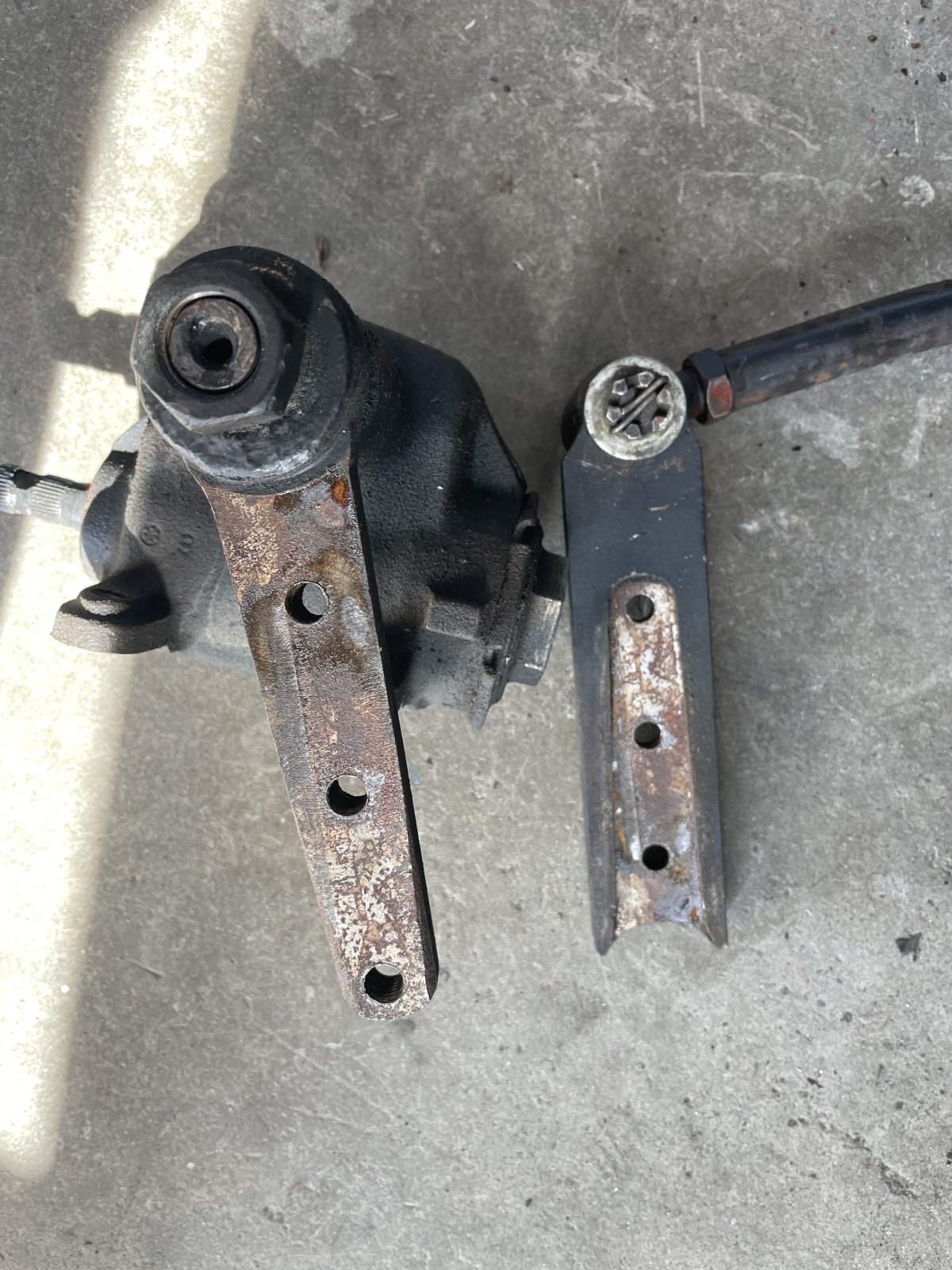

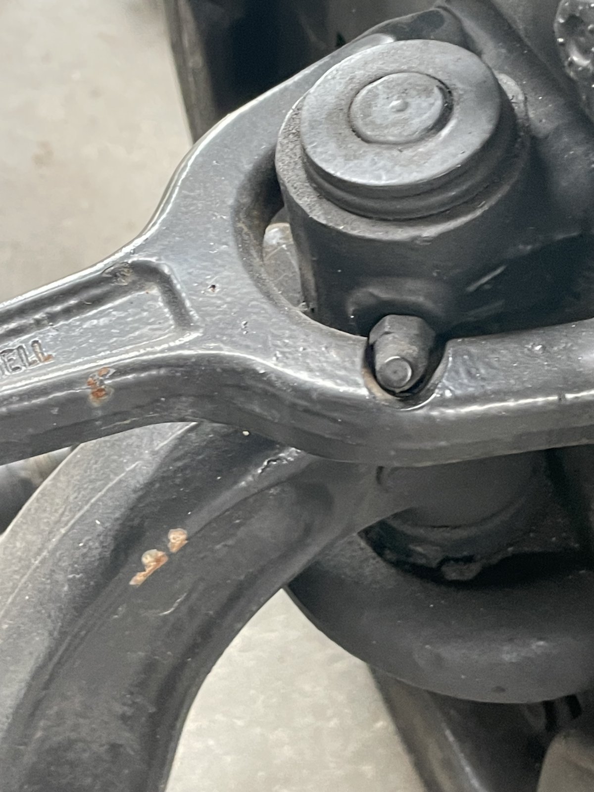

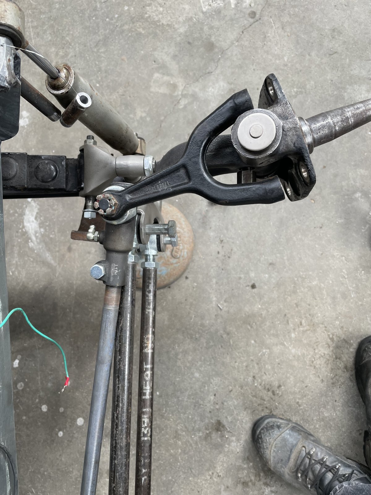

    I am a dummy . Doing our 32 roadster. Mocked up the rebuilt F100 steering with some poorly constructed split wish bones. Every thing worked well together. Couldn’t stand the poorly constructed wishbones. So fitted some nice Curtis style hair pins. Didn’t even realise the clash of the drag link with the hair pins until we fitted the brakes. Hmm this isn’t going to work . Tried searching for something similar but alas I must be on my own with this dumb mistake. Will go the same as our other 32 steering , 37 type cross steer , tie rod and drag link between the hair pins and better geometry . As the chassis is boxed we made some beefy crush tubes to go right through , don’t want any hidden fasteners as far as steering goes. Might add a panhard or dead perch. Don’t worry about the hair pin bolt sticking way out ,just slipped it out to get the F100 pitman arm off. IMG_4101.jpeg IMG_4102.jpeg

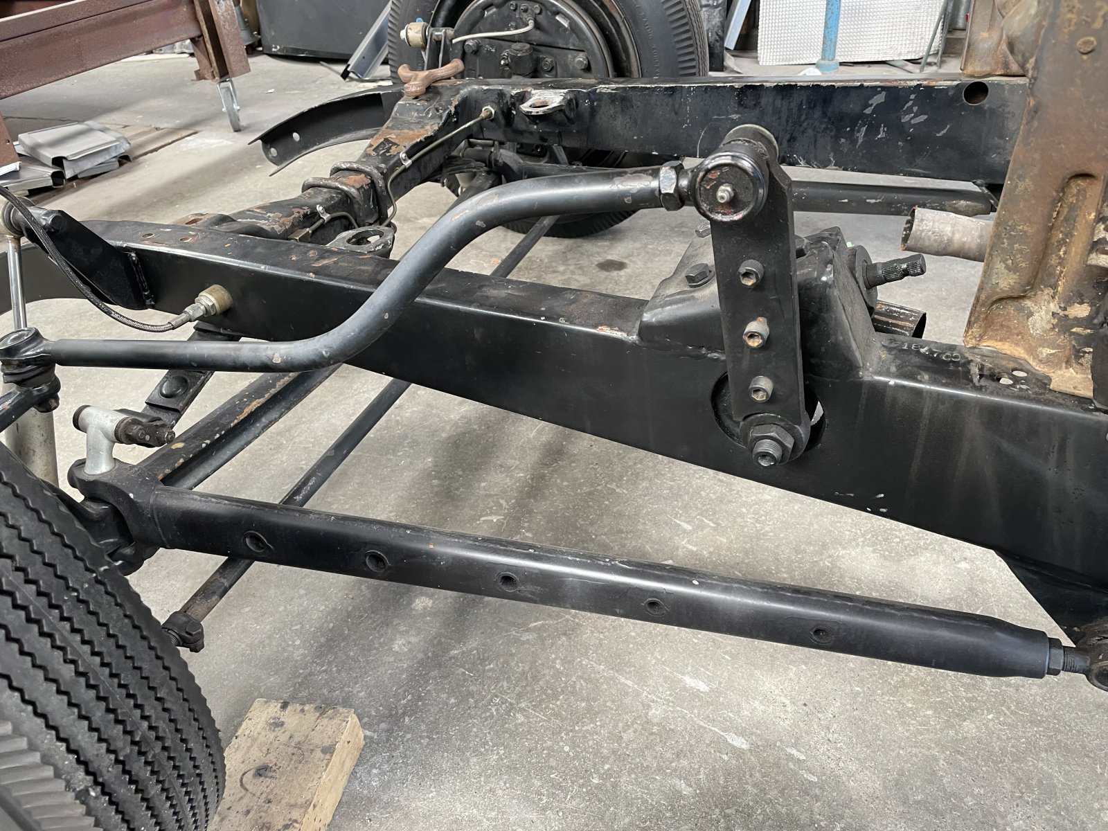

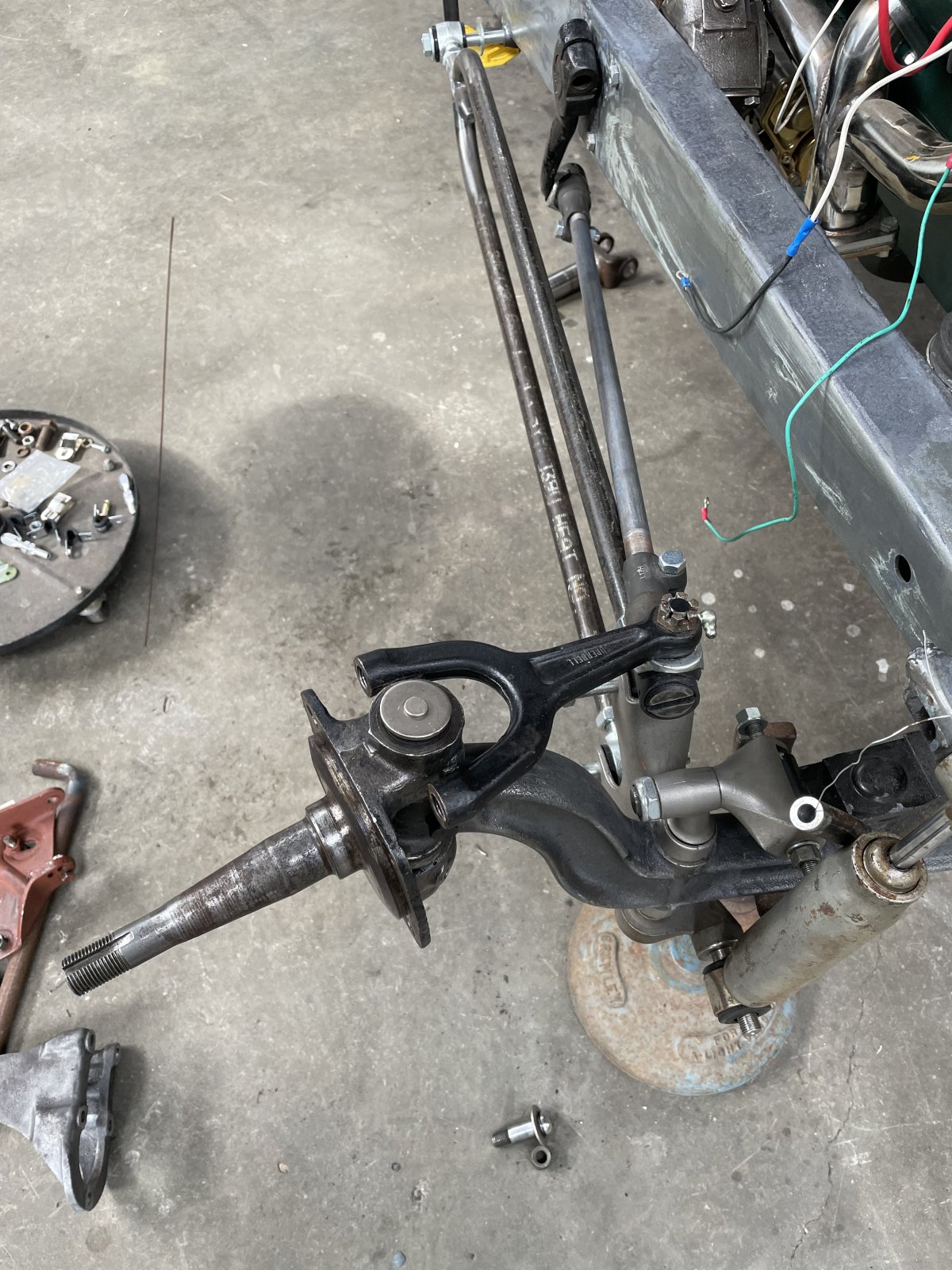

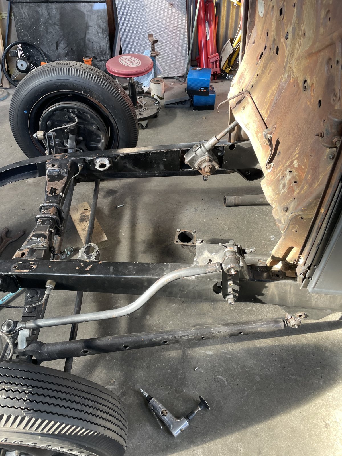

    This is what it had. So now we’re on to version 3 !!! The last pic is a drivers ed roadster with twin steering. IMG_2504.jpeg IMG_2510.jpeg IMG_2534.jpeg IMG_2512.jpeg

    Turn the steering arm over and put the drag link on top.

    The steering arm could be heated and bent up some, further messing with the bump steer.
    The drag link could have a kink in it, but that's not great.
    Could the hairpin mount drop some?
    Universal fit doesn't always actually fit.
