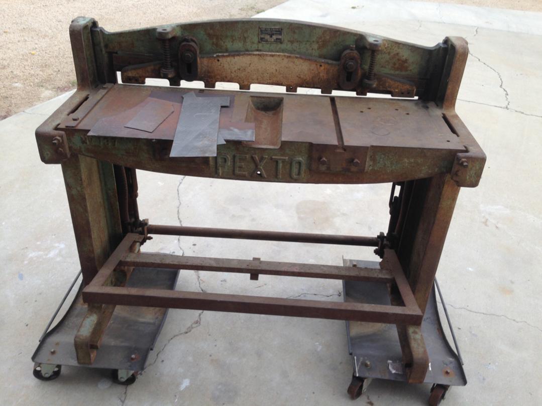

    Score!!! Just picked up a new toy a 37" Pexto Sheer! I would have liked to get a 42" but hell I can't complain for $200.It cuts like ****er!!!

    Life just go a lot easier for you my friend. I am very jealous right now. Soon I'll have one.

    Everything I have done up till this point has been with hand tools as far a cutting metal goes. It will save time for sure and all the cut off pieces will have straight edges…. makes life a lot better.
    The guy still has an 8 foot brake for a good price but its overkill for my garage. I can give anyone contact info if they would like to pick it up.Your gonna have to be creative lifting it tho…

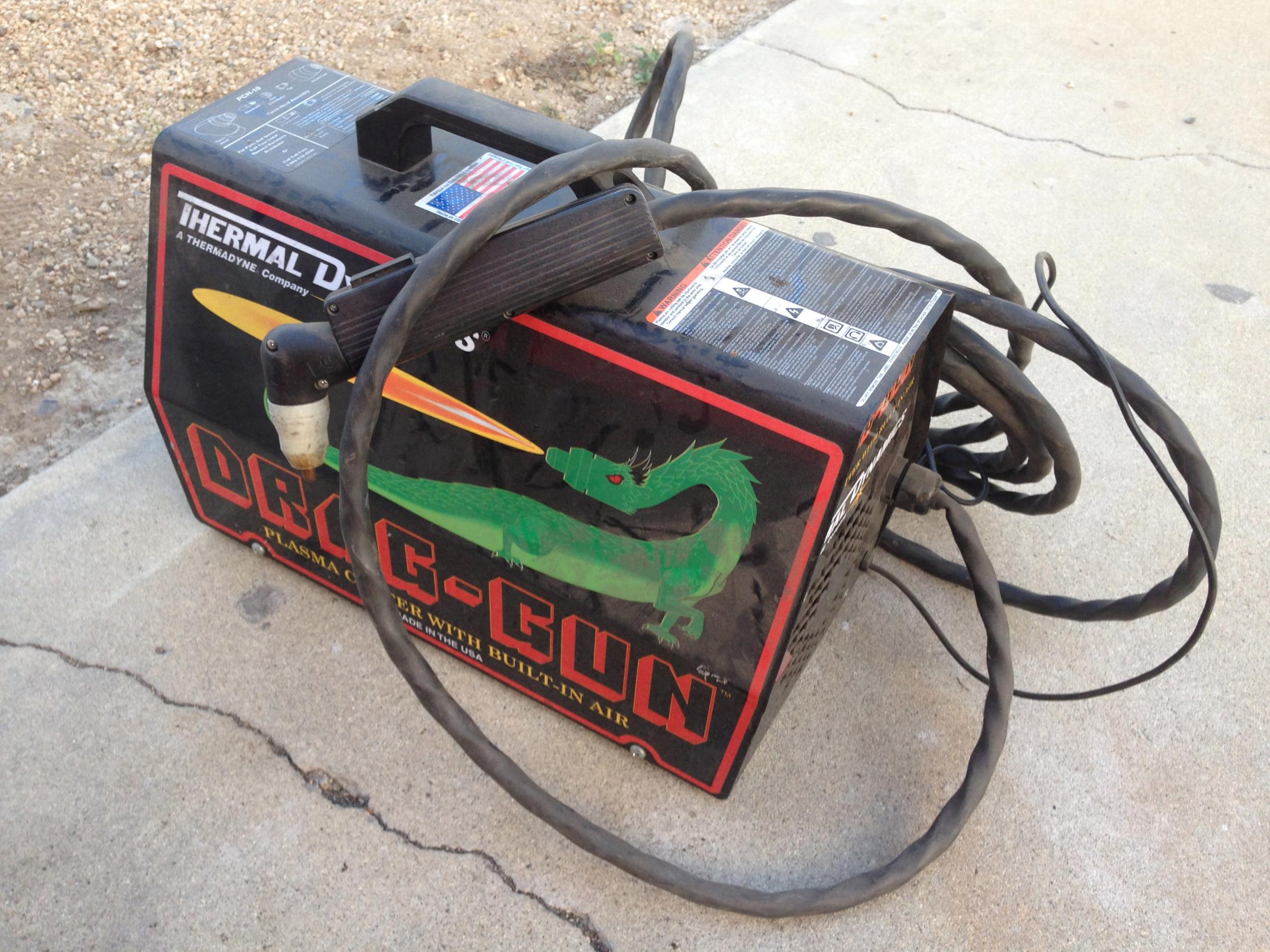

    Almost forgot. Motor Pic and free plasma cutter pick!!! Stacking up the tools and the year just started…… Im working on getting a bailey industrial magnetic brake this year as well….

    Way to rub in your tools are better than mine! Motor looks great!

    Haha sorry mr ****ies..... Don't mean to be rude. Just excited. I'm doing some rear quarter panels rite now on a 65 chevelle and the customer happened to have this sitting on a shelf and showed up with it and said it was my new toy. Ill post some pics this weekend of progress on the shoebox.

    I'm just busting your balls. I almost bought that model a few years ago. Have you used it yet?

    Yeah yesterday. I had a chines eBay one and it had a lot more amps than this one but this one cuts nice and is good for what I do. Its also self starting which seems to keep the tip nice and clean and will cut through paint and crud better than the other one I used. It not a tool I'm gonna use all the time but like every other tool in my garage when you need it you got it. If I were going to buy one I would get one with a bit more amps so I could cut 1/4 plate. I don't work with anything heavier than that and if I do I have friends with equipment that will handle it if need be.
