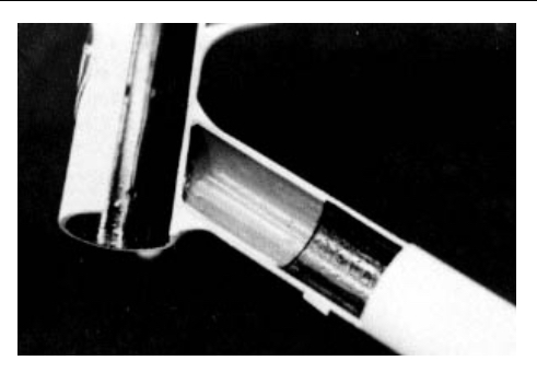

    That wasn't "brazed" it was gas welded which he clearly explained in the article. Basically "aircraft welded" a lot of small plane frames are gas welded to this day.

    Bike frames and motorcycle frames are furnace brazed. They are clamped together, and a br*** alloy paste is applied to the joint(s) and the frame is heated in a furnace to the melting point of the br***, and it then flows into the joint and around the outside leaving a nice clean joint. It is stronger, neater, and faster than brazing, or welding each joint one at a time.

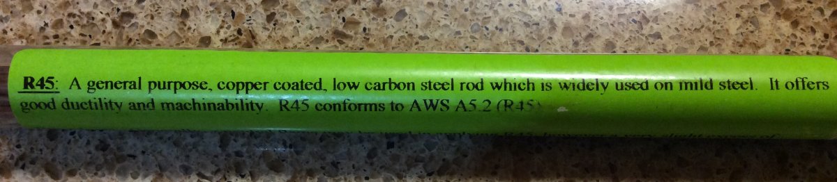

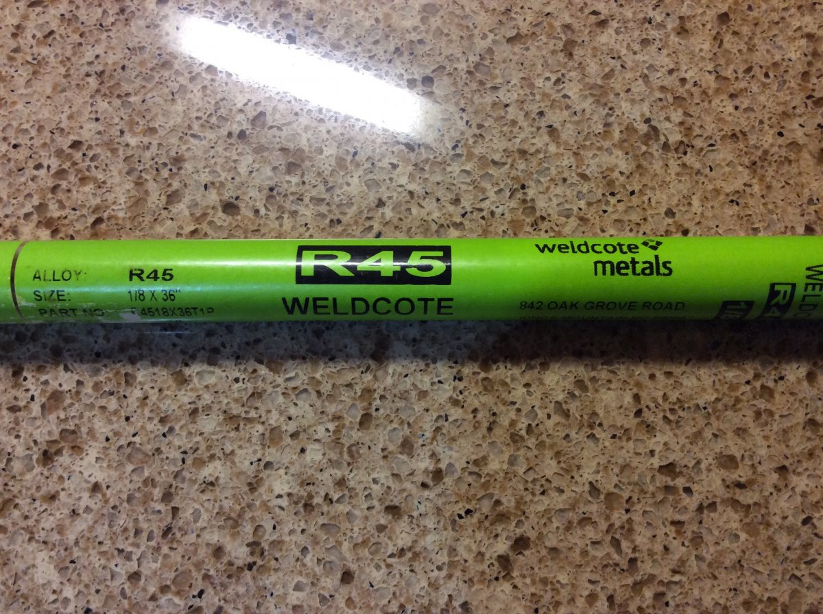

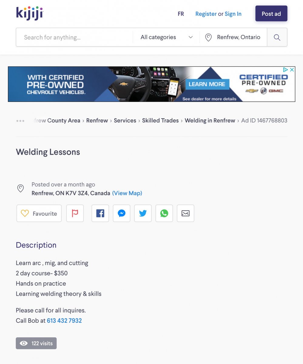

    Seems the local college is now only offering full-time welding courses which last 42 weeks! Found someone on kijiji (Canada's version of Craig's List) for ONLY $350 for two days. Lol...
    This what the local welding shop told me to use. Have not yet checked to see what this actually is.
    I think my issue is either the helmet or lighting, of a combination of both. I have the darkness dialled down to 9. I sometimes position my dual halogen work light on what is I'm welding, but them typically the helmet will darken as I get ready which is a royal pain. I'll try a few things this weekend, and will look into a helmet light.

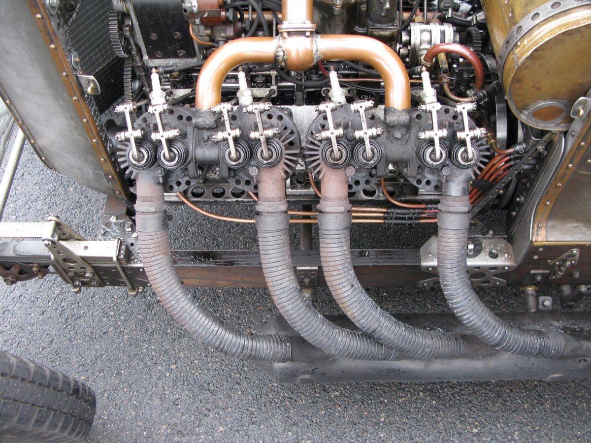

    A guy named Lloyd Taylor built a number of engines this way. The one you will recognize was named Crosley. It was later switched to a casting for production and water leakage problems.
