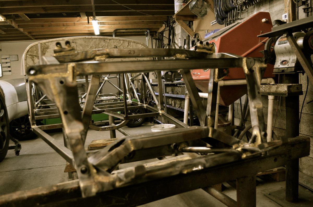

    How not to bronze weld / fillet braze, by non other than the late, great Tom Jobe.
    All welded structures are subjected to loading of some kind.
    The loading on the welds depends completely on the structure's geometry.
    Note the Surfers' frame design put the side rail triangulating diagonals in almost pure tension or compression which is the most efficient (potentially lowest weight and greatest strength).
    Designs that try to bend the tube really require larger diameter tubes, more sophisticated joinery, etc.
    https://weldtalk.hobartwelders.com/...lding-questions/50248-i-get-a-call#post657168
    Note the Surfers' bronze welding failure really was a surface prep failure.
    Although some types of welding, and weld electrodes tolerate contamination better than other surface prep is always important.

  5. Not sure if it’s been mentioned but Caterham chassis were 100% brazed until recently. Allowed bent chassis members to be replaced easily.
