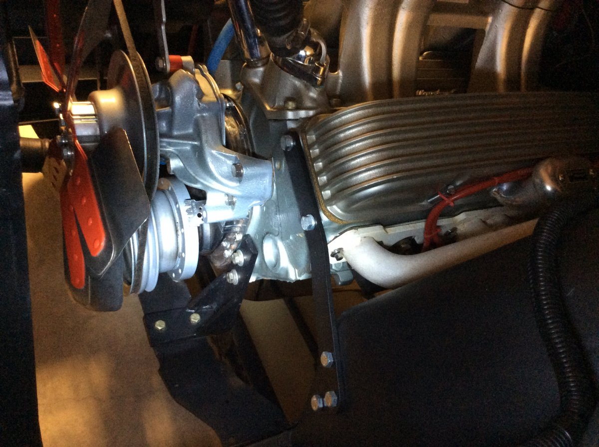

    Well one piece of news, after having the engine out and inspecting the mounts, they are a rubber mount. So, all of that vibration was still getting past rubber mounts. Not sure why the previous owner said they were solid One other person suggested checking to be sure that there wasn't contact happening somewhere else between the ch***is and engine, so that will be next when she starts going back together.

    Something like the exhaust up against the floor or solid against the ch***is could do it.

    It's been a long while. I don't have as much free time at the moment, but I thought I'd come back and post an update. Motor is finally done and going back into the truck. All new pistons, rods, a new cam, new lifters, (after speaking with the builder I ended up switching to a roller cam after all. I just couldn't see not doing is since the whole motor was apart anyway) and then rebalanced. Haven't seen it run yet. Should be going as early as the end of today. Fingers crossed that the vibration is gone. The engine was done by Doug at Rockville Ring and Bearing in Rockville MD.

    Just as an example this is my solid mounted 1000 rpm idle, with the cam it does not like anything under a grand. You can see it is rather smooth and not shaking the car to pieces with the solid mounts.
    and another that idles at a grand on solid mounts, the myth that a car will shake apart and be underivable with solid mounts is just a myth

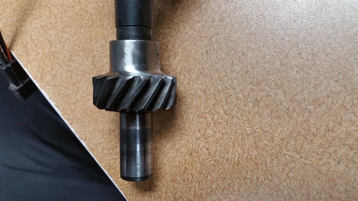

    Those are some sweet rides. What motor and cam did you have in those? I only wish mine had been that smooth! I had someone tune it and they tuned it down to under 700 rpm, which I think in hindsight was probably the wrong move. Haven't started the rebuilt motor yet. Still debating this distributor gear. Going back and forth as to if it is iron, bronze or billet. New cam wants an iron gear. I know it should be easy to tell, but this one is brightly polished. 20150924_182716.jpg

    A magnet will stick to an iron gear. I've always wondered why cam manufacturers don't include the distributor gear.

    Okay, now I'm feeling a bit slow. I'll check it with a magnet on Tuesday when I start looking at things again. Comp cams sells distributor gears, but I agree they really should put one in the K kit given the price.

    Glad you are resolving the issue. It has been said here by some unknowing souls that solid engine mounts were the root of the problem. Guess they were wrong. I have been running solid mounts since 1974, works just fine, no vibration issues whatsoever.
