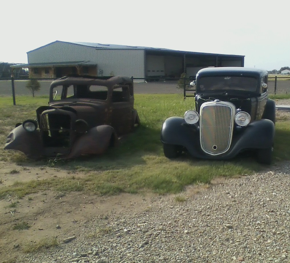

    I am longtime caretaker of 34 Chevy Master 5 wdo. After lusting for "big headlights" for years, I finally added 33-34 Ford commercial lights mounted on "short" stands to the existing fender brace hole. These are the Bob Drake version w/excellent low beam light (best of 3 different styles of headlights used over the years). Problem is reflectors are permanently mounted to buckets and after rotating the lens to have vertical flutes and adjusting on low beams, high beams are directed to the trees due to angle of the reflector. This Chevy is first and foremost a driver, and although I seldom use high beams, I can see the need on dark two lanes. My thought is a projector style light mounted behind crank hole in grill. Anyone have thoughts or better yet, similar experience? 0803181747_00011.jpg

    I use the original headlamp stanchions on my 35 Standard, fender to grill shell, with OEM buckets, reflectors and Tiltray lenses. I use H4 bulbs that were made to suit, they maintain correct forward focus with no search light issues. I see a donor car to the left with headlamps, are they rebuildable? Could it be the Ford lamps rejecting the Chevy body like a donor organ? :)

    I hope it's not organ rejection!! I have no original parts so these repo headlamp ***emblies give the original-ish look I'm shooting for on my Chevy...
