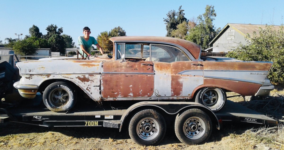

    Brigrat, before I bought my 61 corvette I looked into building a corvette but it just wasn’t worth it. The problem is every early corvette I found was restored and tons of money. No body seemed to have projects.
    I bought this 4dr hardtop for $1500 in 2018. I think $30k would go a long ways opposed to starting with rust. IMG_0111.JPG
    Complete minus engine and trans. Hope to start next year.

    Budget36
    That looks more like surface rust(on my phone) and not rot. That’s a good candidate, IMO, to work on as-is
