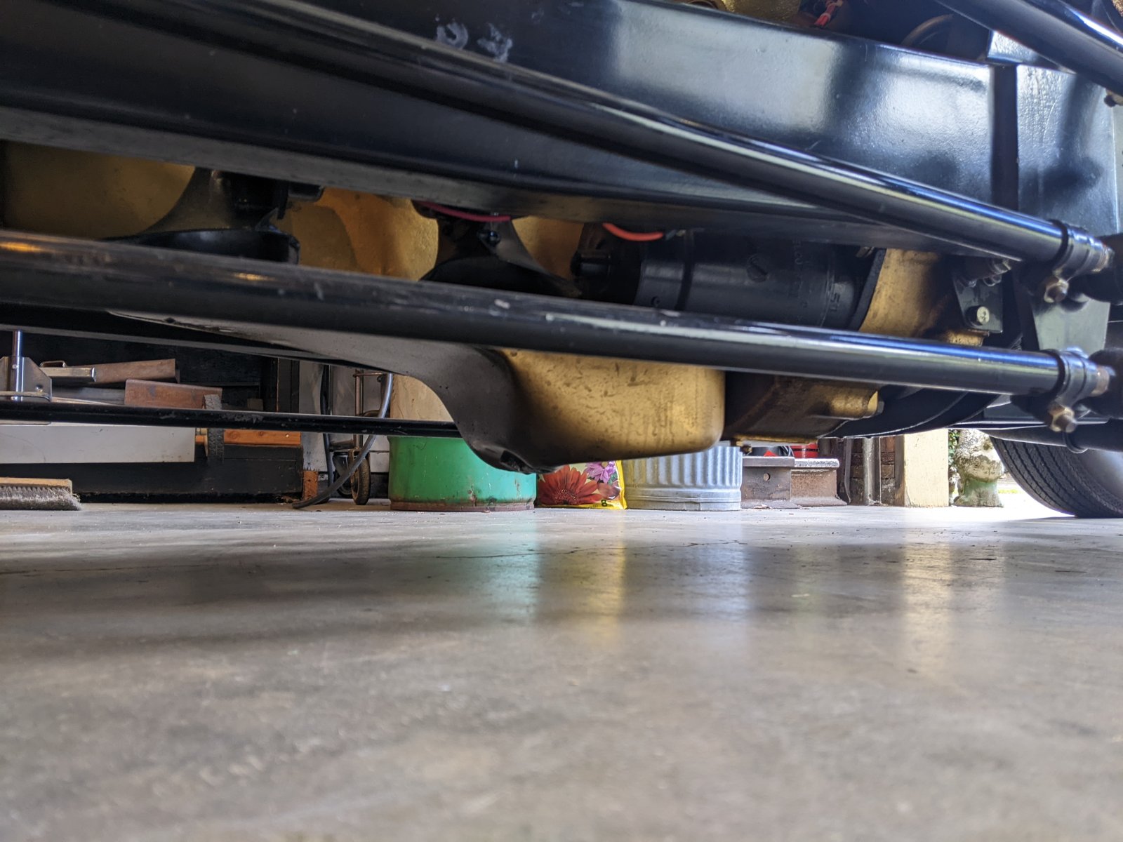

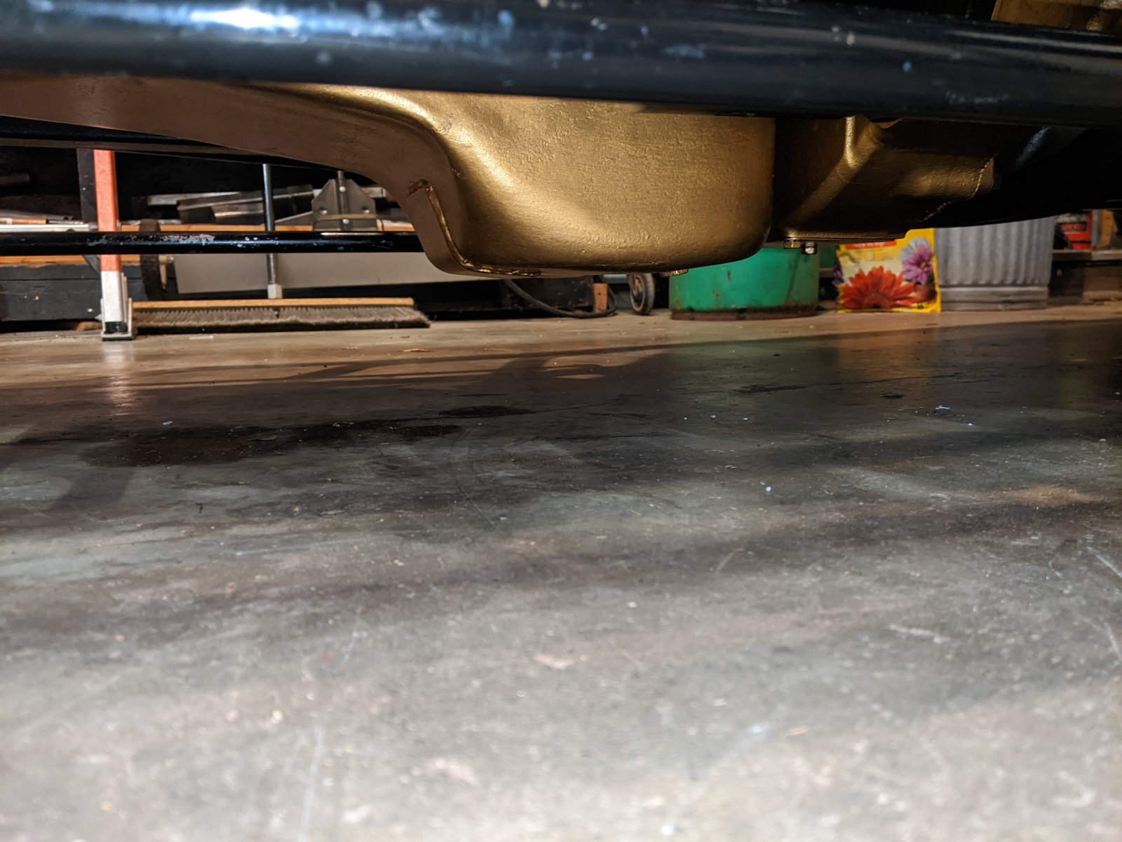

    pan in question is attached to a '58 Olds 371.
    those familiar with the early Olds engines know there is no easy way to raise the oil pump pickup, so that is not an option.
    but, in '58 the drain plug is located in the front of the sump and in it's own little sump.
    that is what has been bottoming out, most often from coming down off a speed bump,
    the weight of the 600+ pound engine compressing the suspension at just the right moment.
    as said earlier I can not raise the engine without modifying a hundred other things.
    the pan needs repair, so that's where I start.
    I can reduce the total depth of the pan by removing and relocating the drain plug and eliminating it's little sump.
    this will give me roughly one inch more ground clearance.
    if that's not enough I will raise the car by placing shim plates on the spring packs.

    I posted the pan modification to my '23 T build thread here
    thanks for all the input guys
    Tim likes this.
  19. Paul
    Joined: Aug 29, 2002
    Posts: 16,955
    Paul
    Editor
    before and after
    now with 1" more clearance
    right at 3-3/4"
    williebill, Sharpone, X-cpe and 3 others like this.
