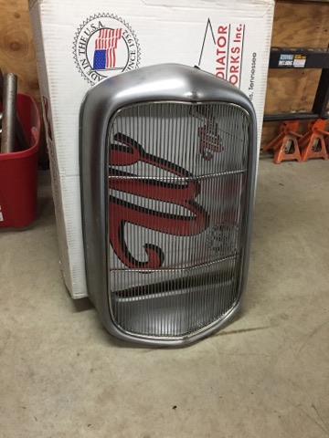

    Brookville shell and insert thru Speedway. For a little more than buying each piece separately, you can get them pre fit and ***embled by Brookville. Came direct from Brookville, Speedway just brokers the deal. Very happy with the quality and fit so far.
    SPark
