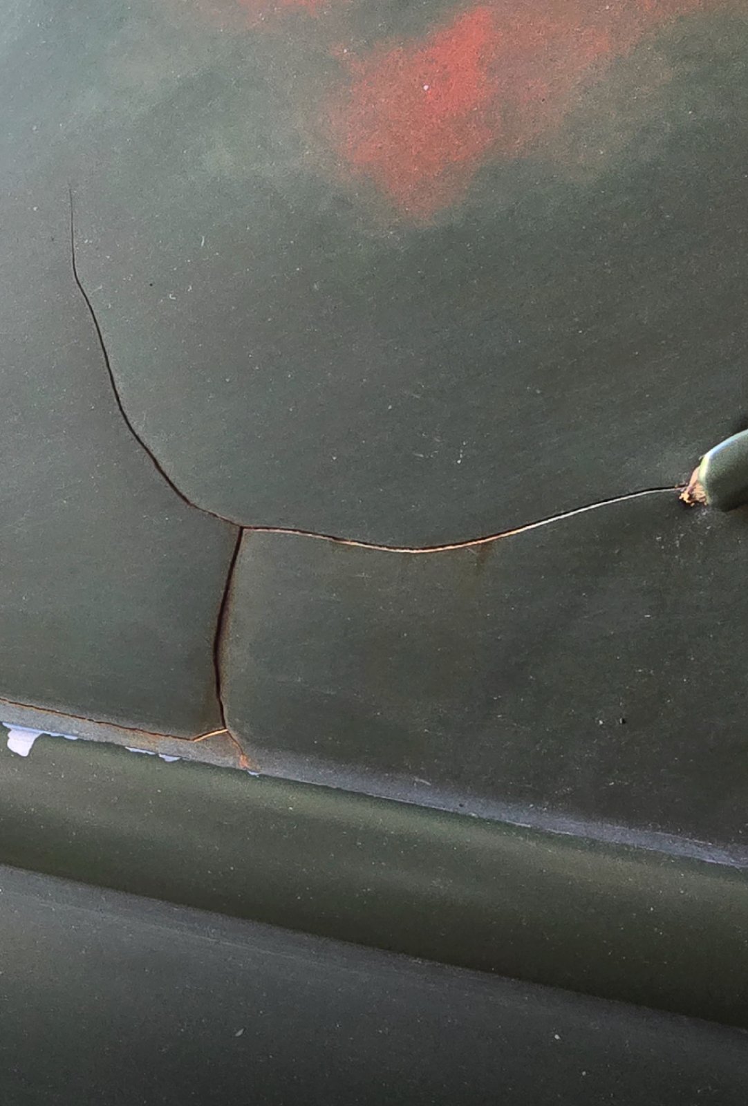

    Looking at a chopped 51 Buick and was hoping to get some thoughts on how it was performed. It's been about 10yrs by what I've been able to find and was done by a shop in Burt Iowa. Any feedback would be appreciated.

    The pictures in the album pretty much show where it was sliced and diced, what else is there? You could always call the shop if they are still in business.
  3. alchemy
    Joined: Sep 27, 2002
    Posts: 22,826
    alchemy
    Judging by the cracks in the paint and that seam, the prep work and cleanliness was nil. Maybe even poor fab work like not welding completely, or slathering on a ton of bondo instead of good metalwork. Could you live with that?

    Is there any pics of it fully welded ? All I see is pics with tack welds. Makes me concerned it's not finish welded. They may have just bondoed over the tacks.
    Moisture gets in & it cracks that body filler. Otherwise the profile looks good enough.

    bring a magnet,,if it doesn't stick....not desirable...or you could just ***ume strip the car and redo some of the work...
    This last picture tells a story . Lots of filler !!
    the chop profile looks good , gl*** looks like it’s sitting right . Car has been driven so doors open and close etc.
    If you willing to strip the car , by the looks of it do a ton of metal work to finish it correctly . Or just “ repair what’s there “ and by repair I mean slather some filler on it and paint it .
    If it has lasted 10 years does not sound horrible , depending on price and what your final level of finish you will be happy with is .

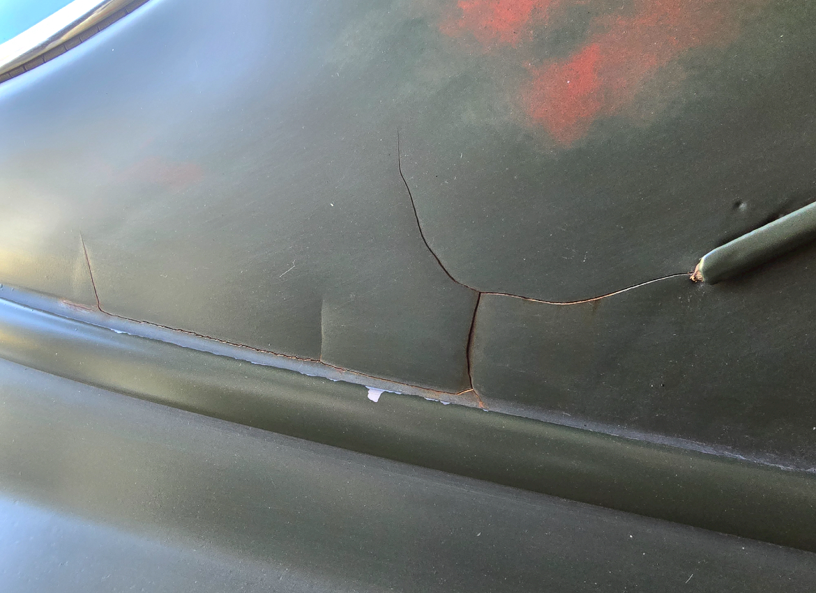

    What about what looks like enormous cracks in the sail panel area with rust coming out of them? Those kind of cracks are usually caused by the bondo being way too thick IMG_1564.jpeg IMG_1563.jpeg

    ^This. Plus, you can tell water got inside those cracks...not good.
    I would walk away. There are better options.

    The factory tailpan seam failure that @VANDENPLAS posted isn't from torque, but rather a cancered out factory seam that was not properly mitigated, but rather bondo'd and painted over-look at the rust hole in the tailpan below the seam. Even thick bondo will sometimes last for years w/o cracking. The sail panel cracks, etc speak to poor welds and or poor metal prep. Possibly it was chopped, then ran bare or in primer for awhile, got rusty, then bondo'd and painted? It's a shame because the chop has nice lines.
    At that price, I'd p***. Unless you're in love with the diesel and are planning to grind out/repair the affected areas and reprime the car and run it as a driver. A proper treatment of taking the car back down to bare metal for repairs, couple of grand in chrome work, etc would really rack up the total price.

    Totally agree. There are lots of red flags on this build. ****y theme, sliced and diced chop metal work, big cracks in the body work, goofy choice of drivetrain.... looks like a rat rod, or in this case rat custom, to me. So regardless of how decent the profile of the chop looks, the truth is staring you in the face.
    Big cracks in the filler over the sail panels are telling you the filler is either too deep, there is poor surface prep where there is no adhesion between the filler and the substrate, the panels are not fully welded, the body/roof is twisting up from either torque or lack of body bracing/structure, or some combination thereof. None of those options are appealing.

    Moriarity's pics sealed the deal. Hell no. No offense intended, but that car is a disaster. Keep looking!
