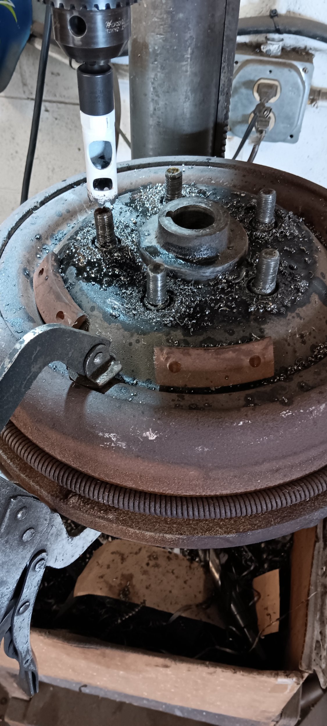

    IMG_3753.JPEG A couple of years ago, to get a 64 Fairlane's brake issues solved I needed new front drums, when they came they didn't include the hub:(
    I "luckily" had a hole saw of the right dimensions which I used a piece of copper pipe to keep it somewhat concentric on the stud. The new drum was the right center hole diameter so it self centered. Finding a drum that is the same dimension would be the only issue. IMG_3748.JPEG

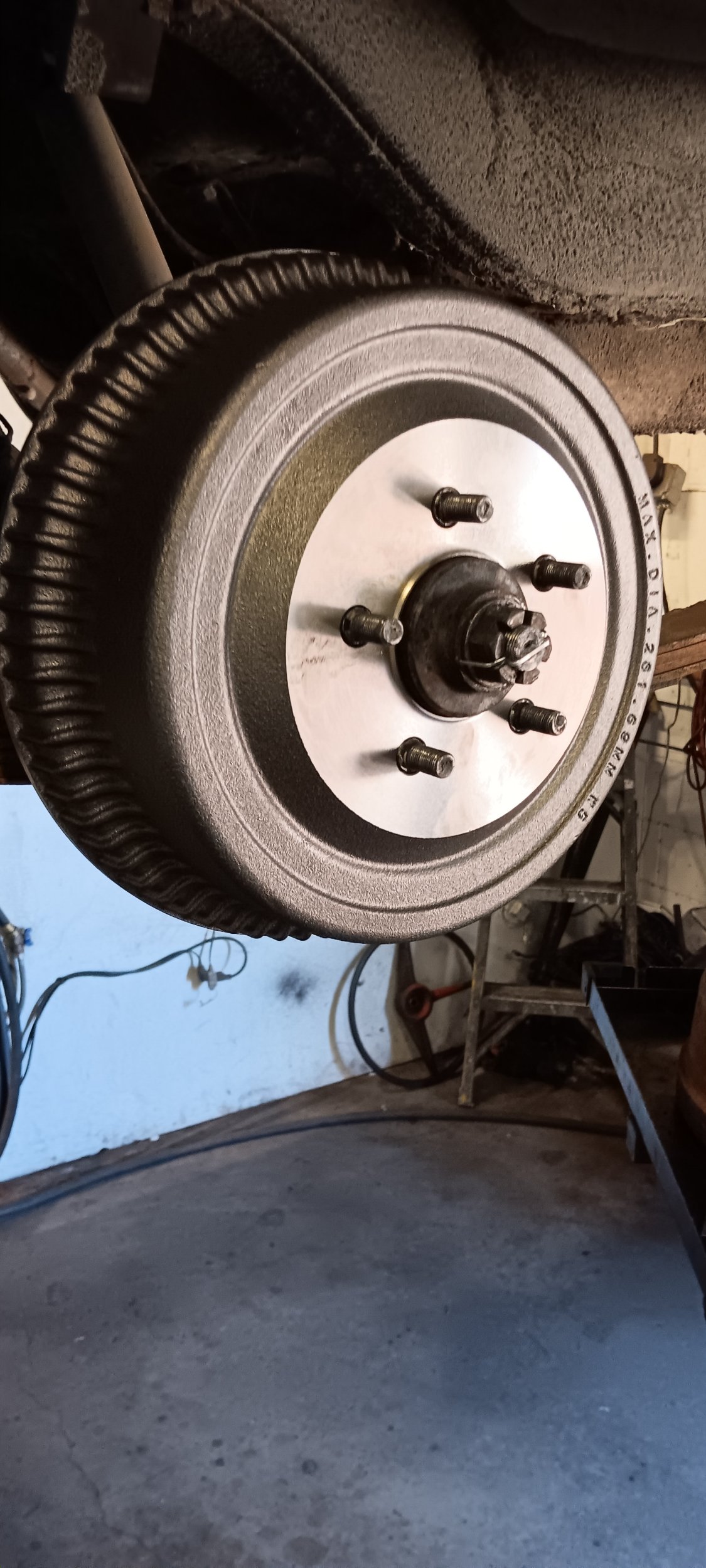

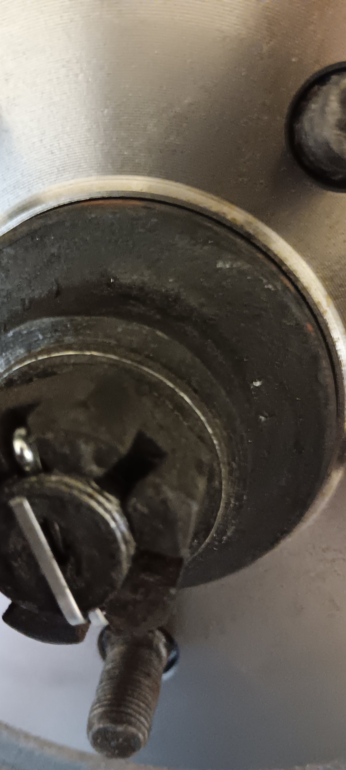

    Update for today. I finally got the drums for the 66 new yorker and though they are deeper offset They fit onto the hub and do not hit the backing plate at all. Only problem is the inside diameter is a little larger than the stock drum, so it's not an exact tight fit. The new drum measures 2.835 and the old drum measures 2.8100. I'm gonna put it together tomorrow morning and see how it does. 20250610_150200.jpg 20250610_150807.jpg 20250610_160420.jpg 20250610_160434.jpg 20250610_160438.jpg 20250610_160929.jpg 20250610_160809.jpg 20250610_150200.jpg 20250610_150807.jpg 20250610_160420.jpg 20250610_160434.jpg 20250610_160438.jpg 20250610_160929.jpg 20250610_160809.jpg

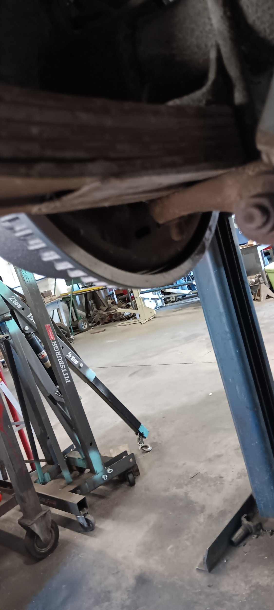

    Another update. I don't like that The hole of the new drum doesn't fit on the hub tight. The guy that I got the front drums from that are from a 68 super bee said I could have the rears sitting on the side of his house. They fit nice and tight on the hub. But they touch the backing plate a little bit. So I think all I have to do is 3 sixteenths off the edge. And everything should work perfectly. Gonna turn them and cut the edge. And we'll report back in a little while. 20250610_160025.jpg 20250611_080018.jpg

    Brian, I hope you won't mind my continued observations, but before you get too far, please check the wheel-to-drum fit, which I suspect might've also been an issue along with the hub-to-drum centering hole clearance for the new drums you got yesterday.
    Also, the used drum in your latest photo appears to be turned/worn past the max ID and possibly making it/them worse choice than the OE drums with the groove.

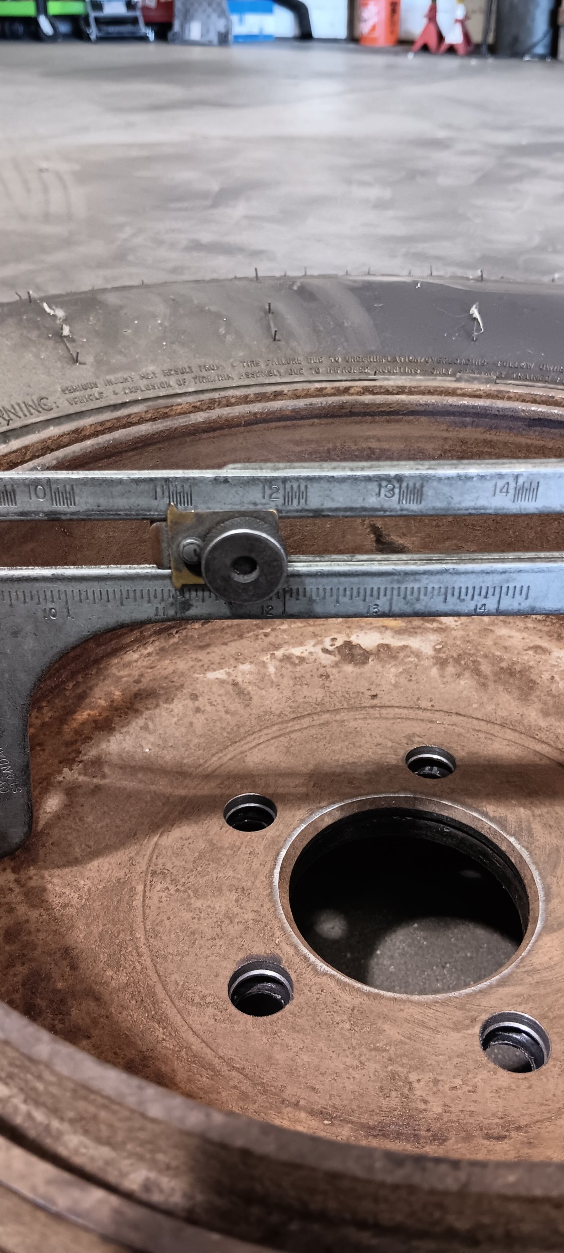

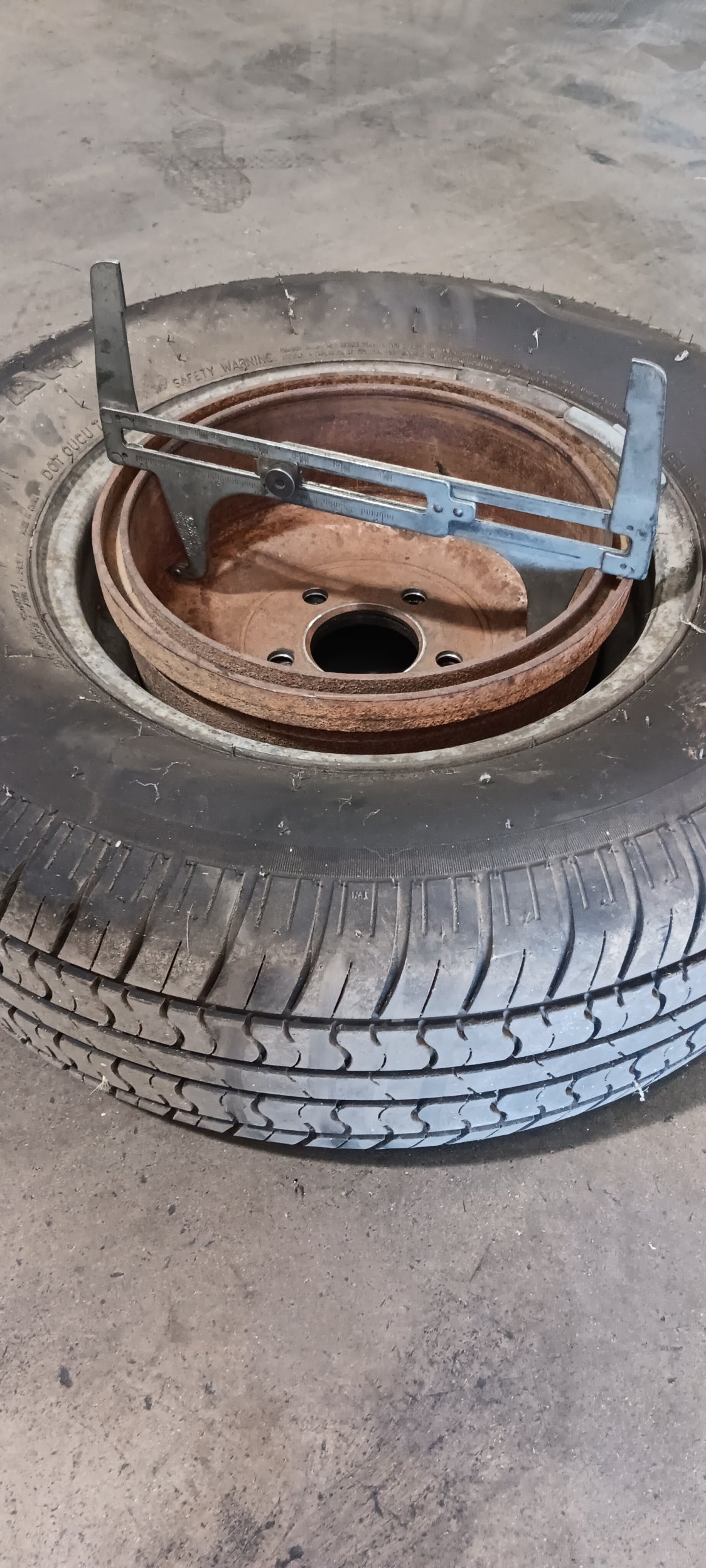

    Thanks for the suggestion on fitting it to the wheel. Just checked and it clears everything fine. As for the thickness of the drums I measured them . Just a hair over eleven So I don't think they've ever been turned. 17496592444696081436648717009594.jpg 1749659278937521008745125732510.jpg

    At least in your photos the drum appears to have a quite deep wear pattern where the shoes have been making contact, also evidenced by the high ridge close to the edge, not to mention fair amount of deep corrosion.
    You might also consider measuring higher up, more in the center of the contact surface and perhaps use (borrow or buy ?) more accurate/precise measuring equipment.

    You can barely feel the ridge with your fingernail on the outer edge. Once they clean.
    Up. I will measure them again. Maybe you see the black marker line that I put on the drum to be cut off And Are mistaking that with the ridge?

    Everything worked out great. Everything clears and everything works. So that's 1968 super bee rear drums with the inside lip cut off quarter inch. Measured the drums after the cut and they are 11.030. Still got a bunch of life left. 20250611_142153.jpg
