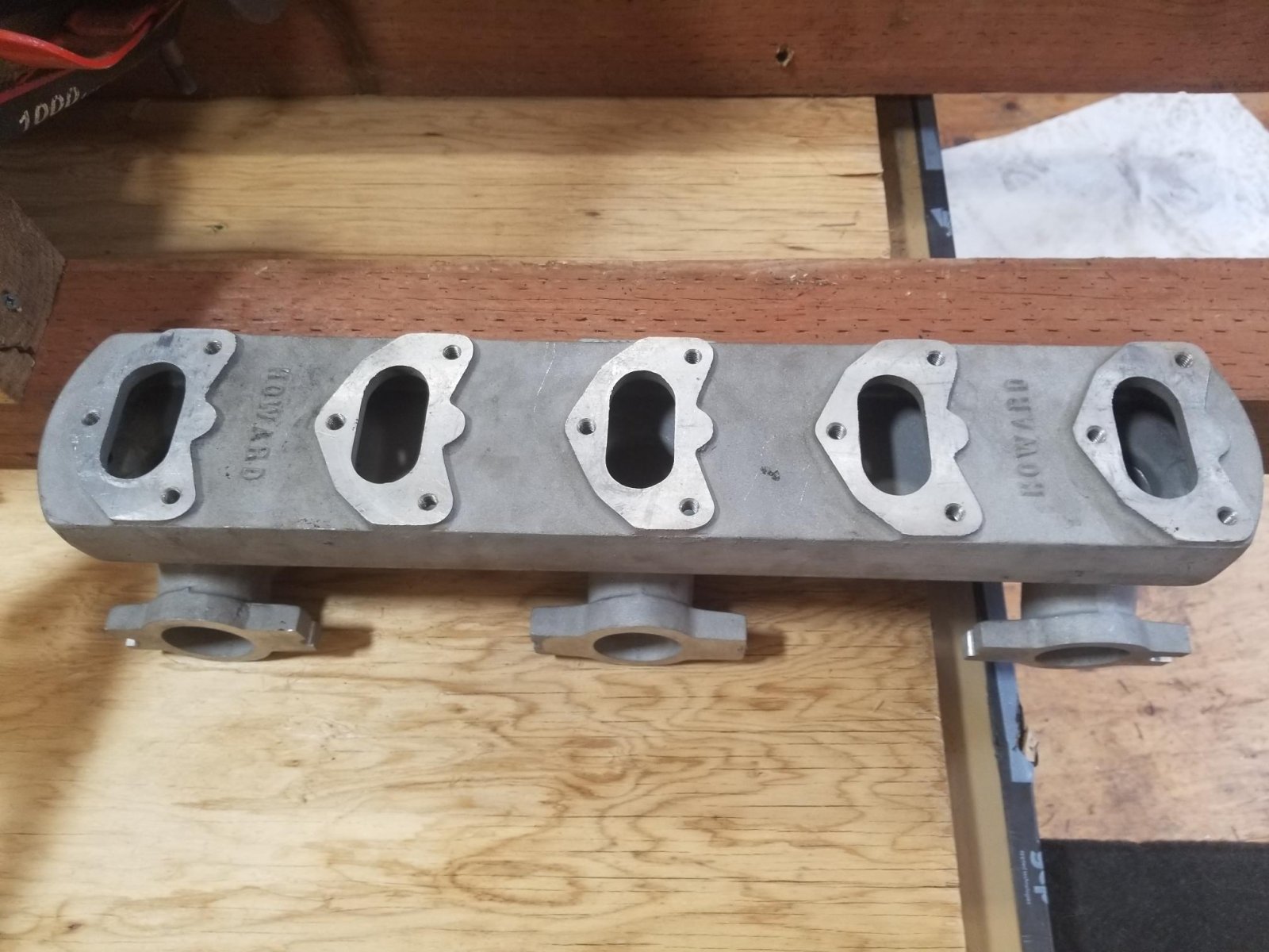

    I'm building a mildly tuned 302 GMC inline six for my '54 GMC 1/2 ton pickup. Bumped compression, mild cam, and split exhaust. I've got a handful of pretty good 2" bore SU carburetors and I'd like to run three of them on the motor. AN SU guide that I've seen indicated that 3 of the 2" bore SU's would be about right. I have a Howard intake manifold setup for Holley AA-1's and I'm wondering if I should build a similar "long box" style manifold for SU's? Or would it be better to individually mount the SU's on three separate intake tubes?
    The carbs need to be raised above the intake ports a little to clear the steering column. Using the elbows that are on the Howard, then building a new plenum to sit on top of the elbows that would accept the side draft SU's would take care of the clearance issues. Or I could fab separate manifolds angled up a bit, of tubing, for each carb.
    This isn't my area of expertise, so I'd appreciate some input from people that know the pro's and cons. Thanks for the help, if I'm posting this in the wrong forum, just let me know and I'll move it.

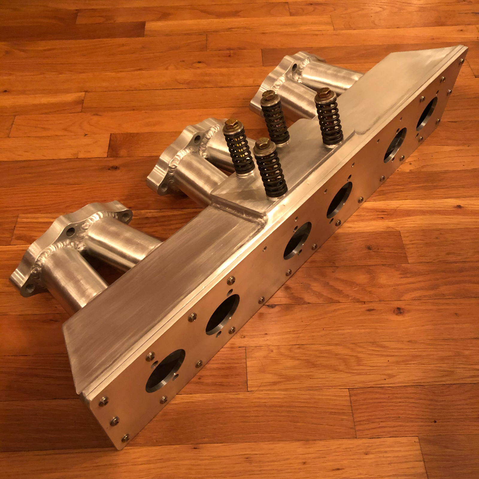

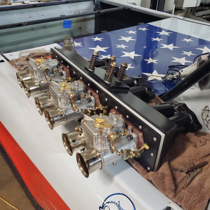

    Food for thought – here's a fabricated tunnel ram for a GMC 302. This one is for DCOE Webers on a 12 port cross flow head, but you could potentially build something like this with a common plenum for a stock head. GMC Intake 1.png
    6sally6, sdluck and lothiandon1940 like this.

    Forgive my ignorance, but what are the four spring ***emblies for on the manifold? They look like a home-made relief valve ***embly. Relief valves are often used on ****-through blower ***emblies as a more friendly alternative to a burst panel. The description though sounds like an NA setup, which normally don't need relieving.

    No problem. I know how you feel. If I stop racing my HAMBster I'll probably hang it from the shed roof rather than sell it. I had such a blast running it. Give me a yell if you do want to part with it. The cage would be the main thing to update. I only want to run a six at regional tracks.
