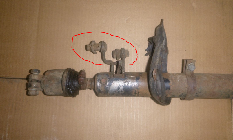

    I picked up a 63 Bel Air wagon with a 3 speed on the column. I took it for a drive and got it stuck in first. I limped it home and got it unstuck. I am going to adjust the column so it doesn't do that anymore but, while I'm in there, I want to replace the bushings for the shift rod levers. I can't find them listed anywhere. What is everyone using? Truck bushings? Tri Five bushings?

    I replaced the shifter bushings on the arms on the steering column in my '51 Ford. Luckily the bushings were easy to find. I got a set I found on eBay, and they worked well. They were pretty simple, made of rubber and br***. Take a look at them; they look pretty generic.

    Also, here is a picture for reference that I pulled from the interwebs of where the bushings are located.

    If the new bushings don't completely fix the problem, remember to also check for wear on the 1st-reversse and 2nd-3rd shift levers at the bottom of the column. And up at the top of the column it wasn't unusual for the shift lever housing (shift bowl) to be worn or broken. This was most noticeable when pulling back the shift lever through the neutral gate. The damaged shift bowl would wallow around loosely but not actually transfer enough motion through the shift tube to select between the 1st-rev or 2nd-3rd levers at the bottom of the column.

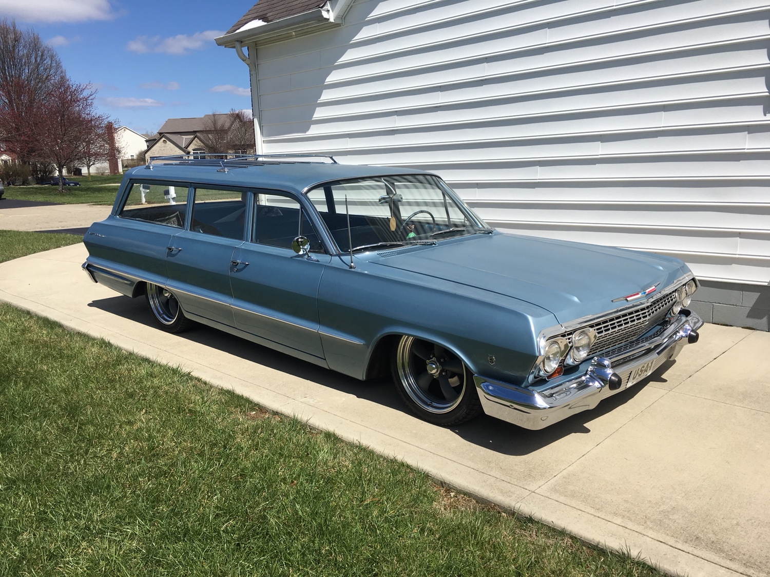

    By the way., Post a pic of the wagon.

  19. Woody's Hot Rods

    My goodness, this wagon is stunning! Pure taste, just right.

    That is nice.

    When either of these bushing is worn out or missing it will definitely get stuck in gear & or be hard to shift. Something to check when you fix these is to adjust the 2 shift rods with lever in neutral to where the two arms are parallel to each other. That really helps.
    Also something I figured out is sometimes my shift arms would get stuck in high gear and just would not come out. This was after the bushing were replaced and arms adjusted. Found problem to be just lots of wear inside ****** and the high gear just would not move good on the shaft. If I could get the car rolling just a couple of MPH with clutch in it would then shift back into neutral. not long ago I replaced the worn out 3 on the tree with an automatic and found out nearly all my ****** problems were caused by a worn out front shaft bearing letting everything inside have bad movement and slack. Bout all the guts were worn.
