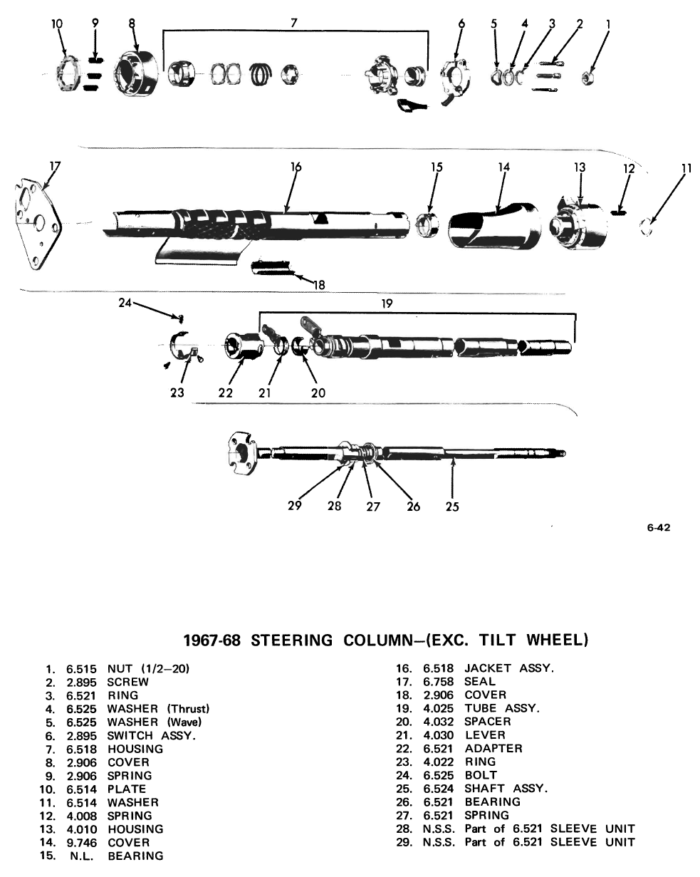

  16. squirrel
    Joined: Sep 23, 2004
    Posts: 60,089
    squirrel
    see what's different?
    Johnny Gee likes this.
