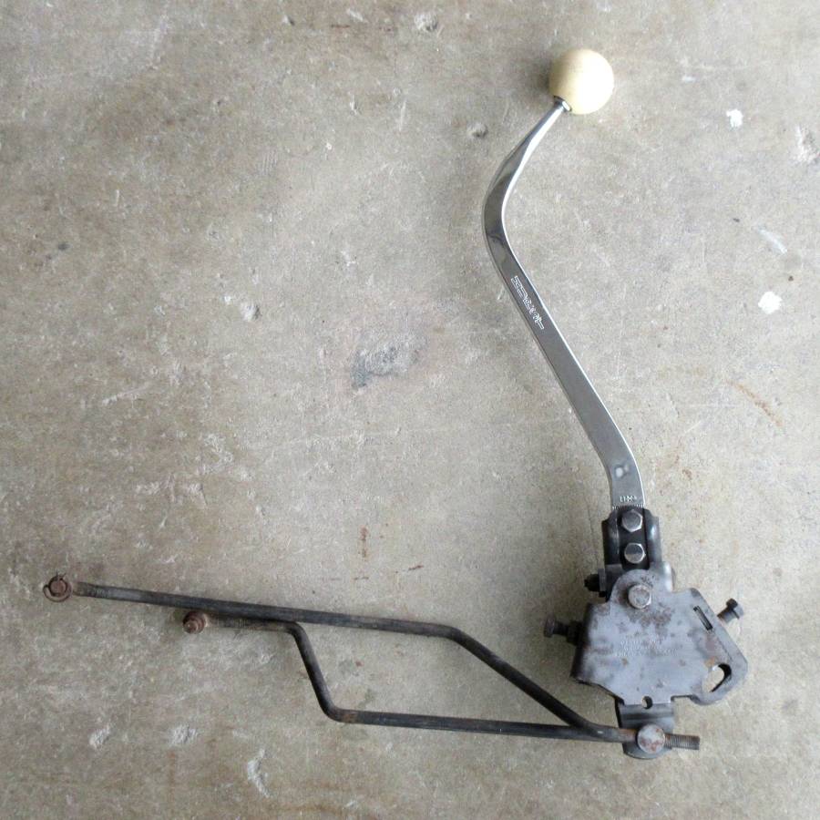

    They might be calling it a Fenton, but it's not. It looks like a factory shifter from a Ford.
    56don and 46international like this.
  14. Yes Bob, that last one looks like what I have in the car now shifting a T-86 I think that is a Mustang unit correct me if I'm wrong.
    This T-85 trans is a little larger and the overdrive unit is really going to be in the way That is why I would like to start over and make a new system (while the car is still drivable) and be able to swap it all in in one day. And while I'm at it to try a little harder to get a unit that fits my '59 guideline.
