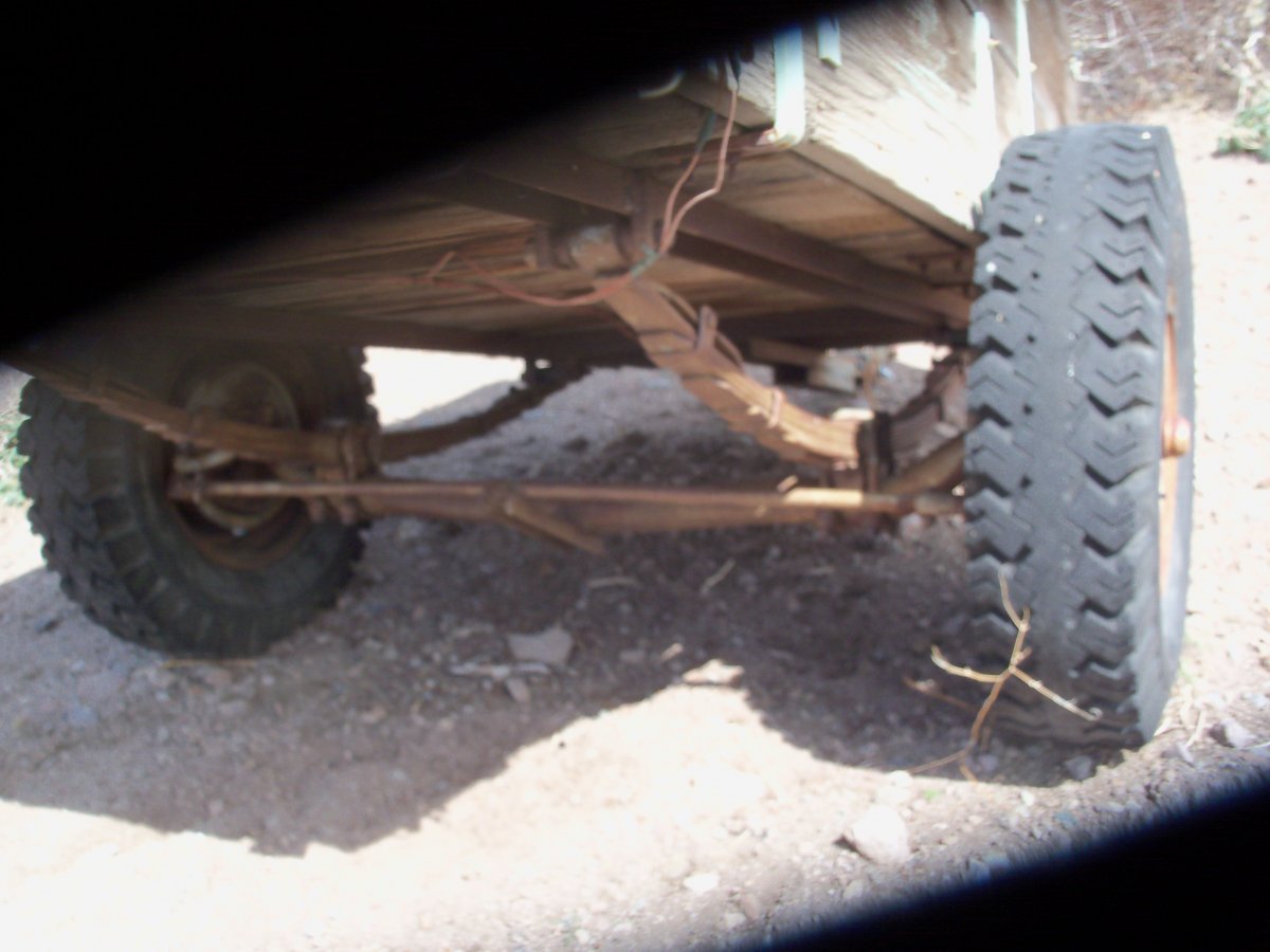

    What is this axle ? Has it got aluminium brake plates ? Thanks.
  5. studebakerjoe
    Joined: Jul 7, 2015
    Posts: 1,260
    studebakerjoe
    rgdavid, looks like a Mopar wavy axle from the 30s
  6. Six Ball
    Joined: Oct 8, 2007
    Posts: 7,239
    Six Ball
    from Nevada
    Yes, It is a mid to late '30s Dodge or Plymouth tube axle. Sorry that is not a better picture. You can not see the nice curves in it. No. there is no aluminum on it, just the light and the ins***utional light green paint.

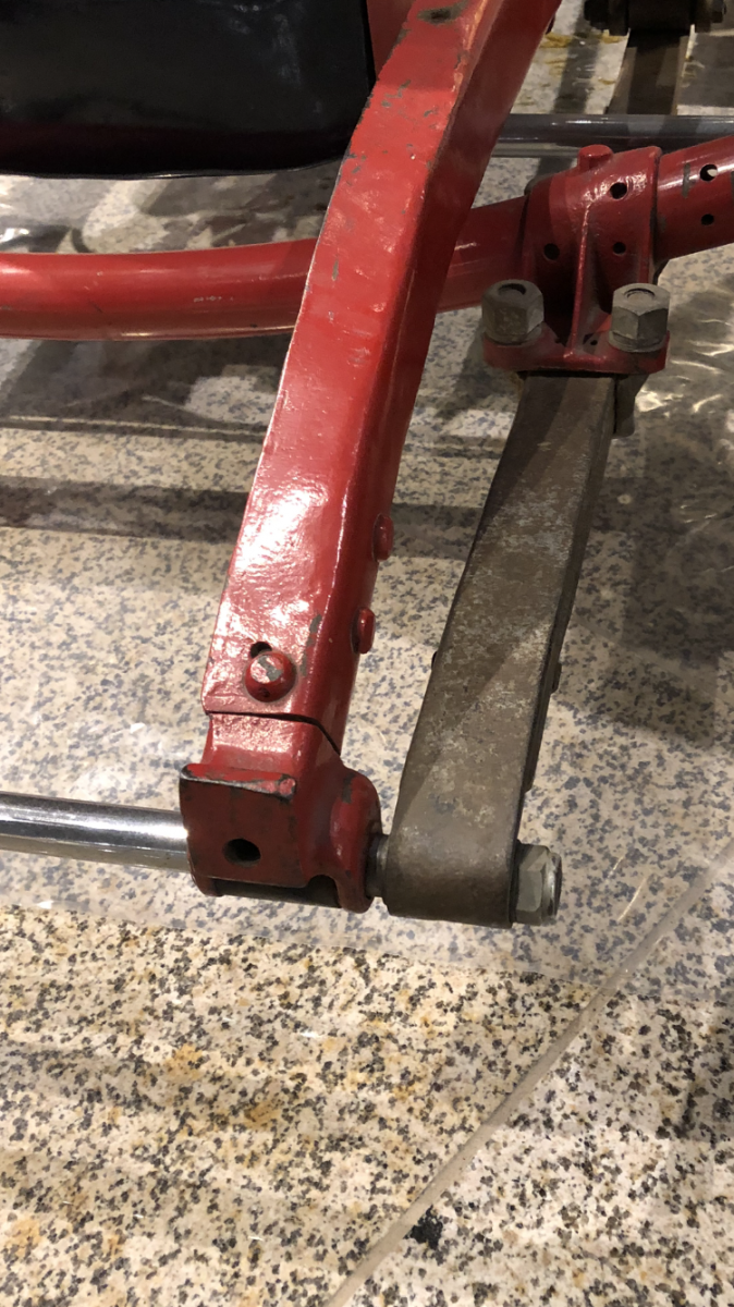

    Building a 3 springer and have a question about how you all handle the front spring mount. I see everyone has a spreader bar but at you using the stock type bolts cantilevered? Drilling your spreader for greasing the spring? Thin bronze bushing and turning the end of the spreader bar down? DA287B0C-41C8-48AF-B849-90607ACE4A98.jpeg 9821C0A0-37DB-4EC6-A246-40D17DBD6E1B.jpeg 49978367-BAF6-430A-8A24-E50EA0197683.jpeg

    Here is a close up I took of the Art Gerrick car. 818350A9-1BBE-40E1-BC0E-B159366A4297.png

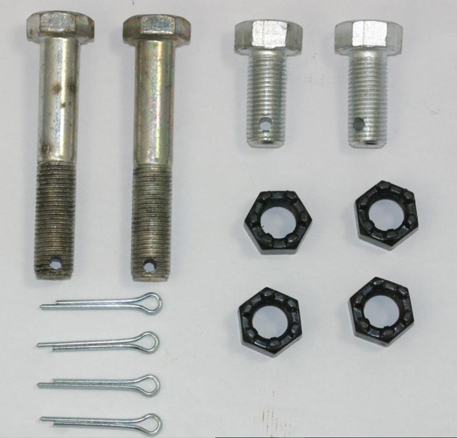

    i bought a length of grade 8, 9/16" redi rod and sleeved it with a piece of dom tube.

    9/16" fine thread . In fact I still have y eyes peeled for old school castlated nuts. I left no provision for grease.

    I am thinking 9/16 solid rod, partially gun drilled with a grease zerk and nut/washer for retainer. Photos I got today from the Speedway museum of the Gerrick car show no provision for grease or any bushing.

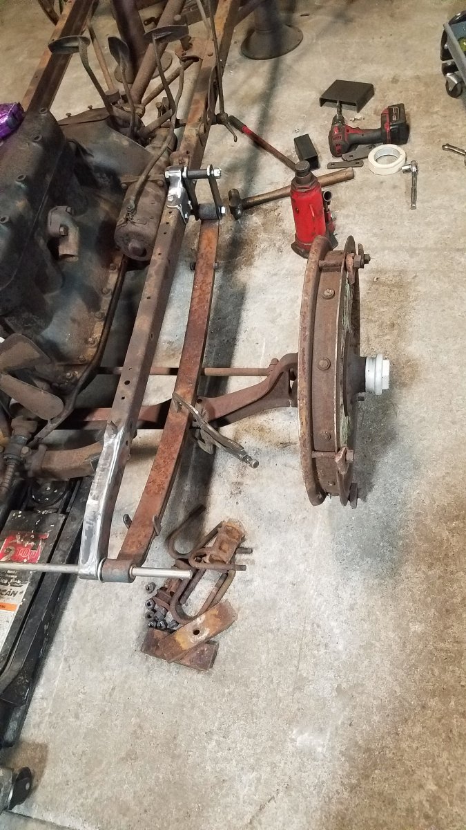

    Heres my project, not much yet. hoping to get going on it more soon.

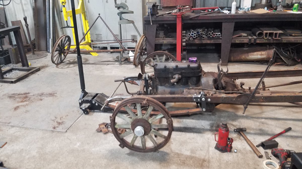

    hillbilly4008

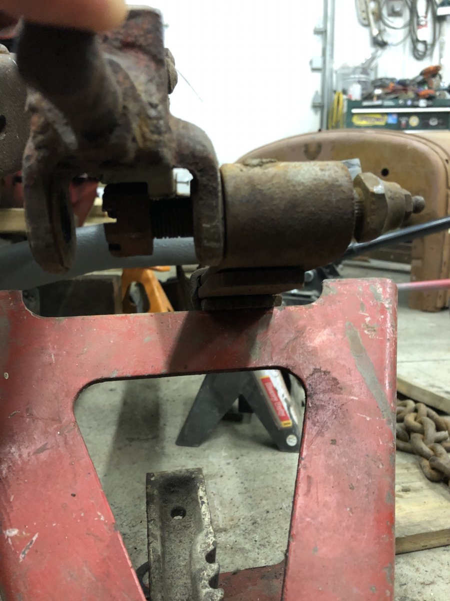

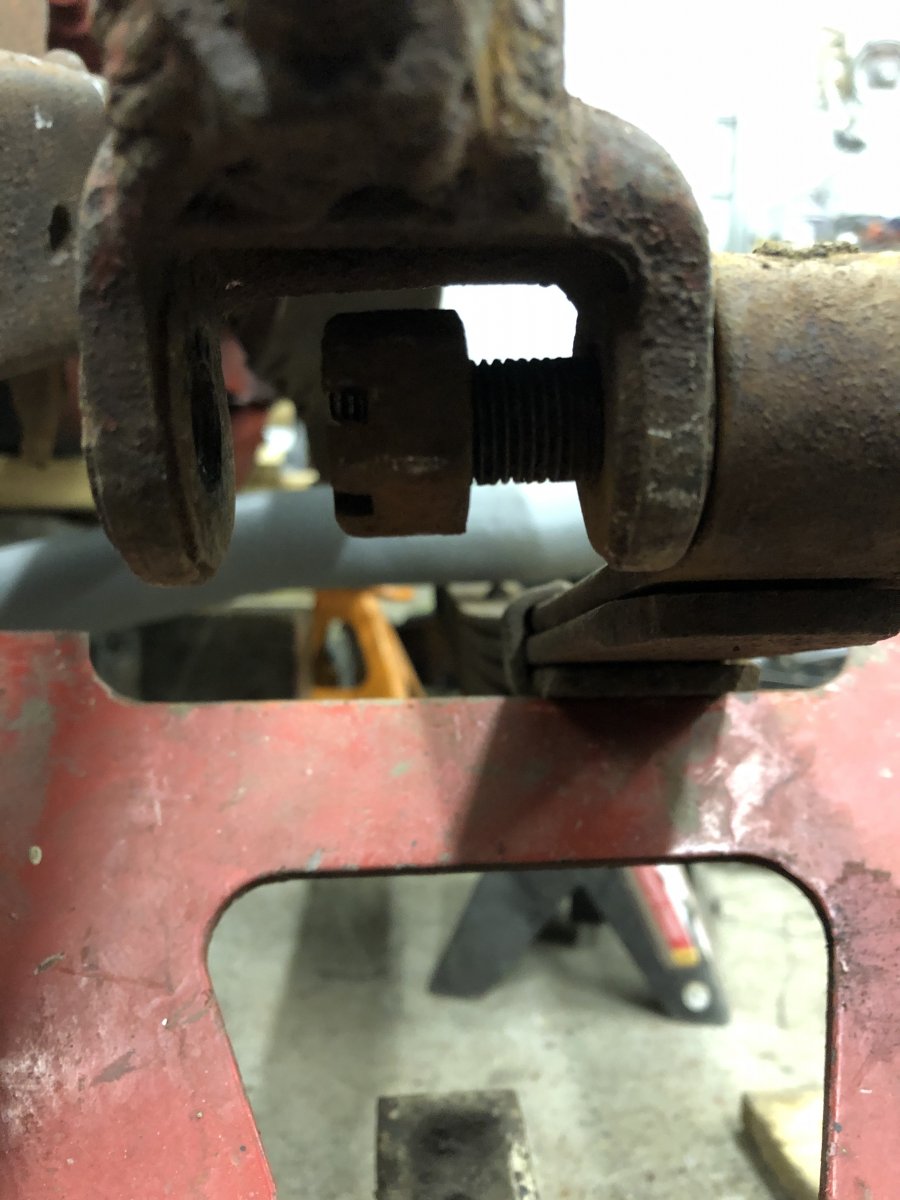

    Does anyone have pics showing rear shackles on springer ch***is? My springs are outboarded, with little real estate in the area where the mount should be.
    Lil'Alb, Jet96 and Okie Pete like this.
  23. alchemy
    Joined: Sep 27, 2002
    Posts: 23,465
    alchemy

    I spun mine 180* and used some plate to build them out to parallel . I plan a small gusset. gowza003.jpg

  26. hillbilly4008
    Joined: Feb 13, 2009
    Posts: 3,237
    hillbilly4008
    Thanks @alchemy those pics did the trick.
    Now i can stand on the frame and bounce my fat *** up and down!
    Shadow Creek, bct and brEad like this.

    guitarguy
    Your bottle jack reminded me....did you ever check the rails for straightness on the top edge? They notoriously sag, usually behind the mount ears of the pan. I used the tried and true method of chains wrapped around the ends of a piece of 2.5" thick wall square tubing and a 20 ton jack between the tubing and bottom of the frame to coax them back into shape. I did this before I started any ch***is work......you might not be too late to check hopefully.
    Once that was set, I then squared the frame....because again, they are notoriously not square.
  28. hillbilly4008
    Posts: 3,237
    hillbilly4008
    I can guarantee everything from the trans mount forward is in check. I haven't examined the mount rearward yet, but now i gotta check that tomorrow. I'm not overly worried about squareness now, I'll be cutting the frame apart for the eventual Z anyways.
    I was concerned about the strength of the T rails as anyone could flex them by hand. That sideways torque coming from the shackle mounts had me worried. I was planning some added brackets to mount the bottom of the frame to the trans crossmember, then i realized that Henry Ford allready made provisions for it. There is a 3/8" hole on the center of the frame rail that lines up with a hole in the ****** mount. Just add bolt, and instant strength. Apparently one of the previous owners never reinstalled them when they swapped out the engine.
    The sagging to you mentioned was allready a concern of mine as well. Im allready planning a bridge type thing to mount below the frame rails...

    guitarguy

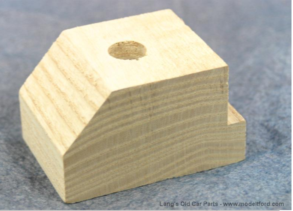

    Your on the right track, except what also goes in between the frame and pan ear is a wood block, before the nut and bolt are tightened down to keep from bending the pan ear and distorting the frame rail.....well, in a "stock" application anyhow. I'm sure you could do the same with a steel or aluminum block I suppose. But the bolt and nut were never meant to be drawn up super tight.
