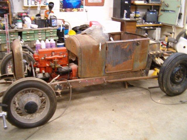

  3. bct
    Joined: Apr 4, 2005
    Posts: 3,196
    bct
    made a door bottom....it was my first time separating a skin from the frame.....way easier than messing with it all as one piece
    dash is welded and i can't wait to get the steerin column thru the bottom hole
    harley wind screen chopped up ....i like the shape but might just use a single flat piece after all .

  5. HRS
    Joined: Nov 7, 2008
    Posts: 362
    HRS
    Why are the springs moved to the outside of the frame rails and not under the rails like stock?
  6. Hackerbilt
    Joined: Aug 13, 2001
    Posts: 6,250
    Hackerbilt
    Narrowed body requires narrowed frame and then you have a full width axle to deal with.
    The simple (and traditional) way to make it all work was to offset the springs outboard from the narrowed frame. :)
    volvobrynk likes this.

    Back on the first Page there is a pic - "Chucks Two Man" that was my inspiration.
    I'm using a pair of bobbed '29 Willys frame rails with parrelell leaves up along side the rails, a Chevy axle, Model A rear cross member and spring, as in line six, a 53 Victoria rear, a slightly larger than stock 27 T body and an unknown rectangular tank. I'm not pretending I'm replicating some thing from the 30'sor 40's but building a car that pays tribute. This will finish as a regularly driven road car.
    Bit more work done since this but no pics at the moment.
    Cheers
    Tony
    volvobrynk and AHotRod like this.

  27. bct
    Joined: Apr 4, 2005
    Posts: 3,196
    bct
    got some stuff done....may be a solid roller by tomorrow.
    j-jock likes this.
  28. youngster
    Joined: Feb 26, 2006
    Posts: 533
    youngster
    from Minnesota
    Progress feels good huh? Looking good. Please post a pic when it's a roller too.
    Ron
  29. bct
    Joined: Apr 4, 2005
    Posts: 3,196
    bct
    semi roller....but the idea is there.
    brEad likes this.
