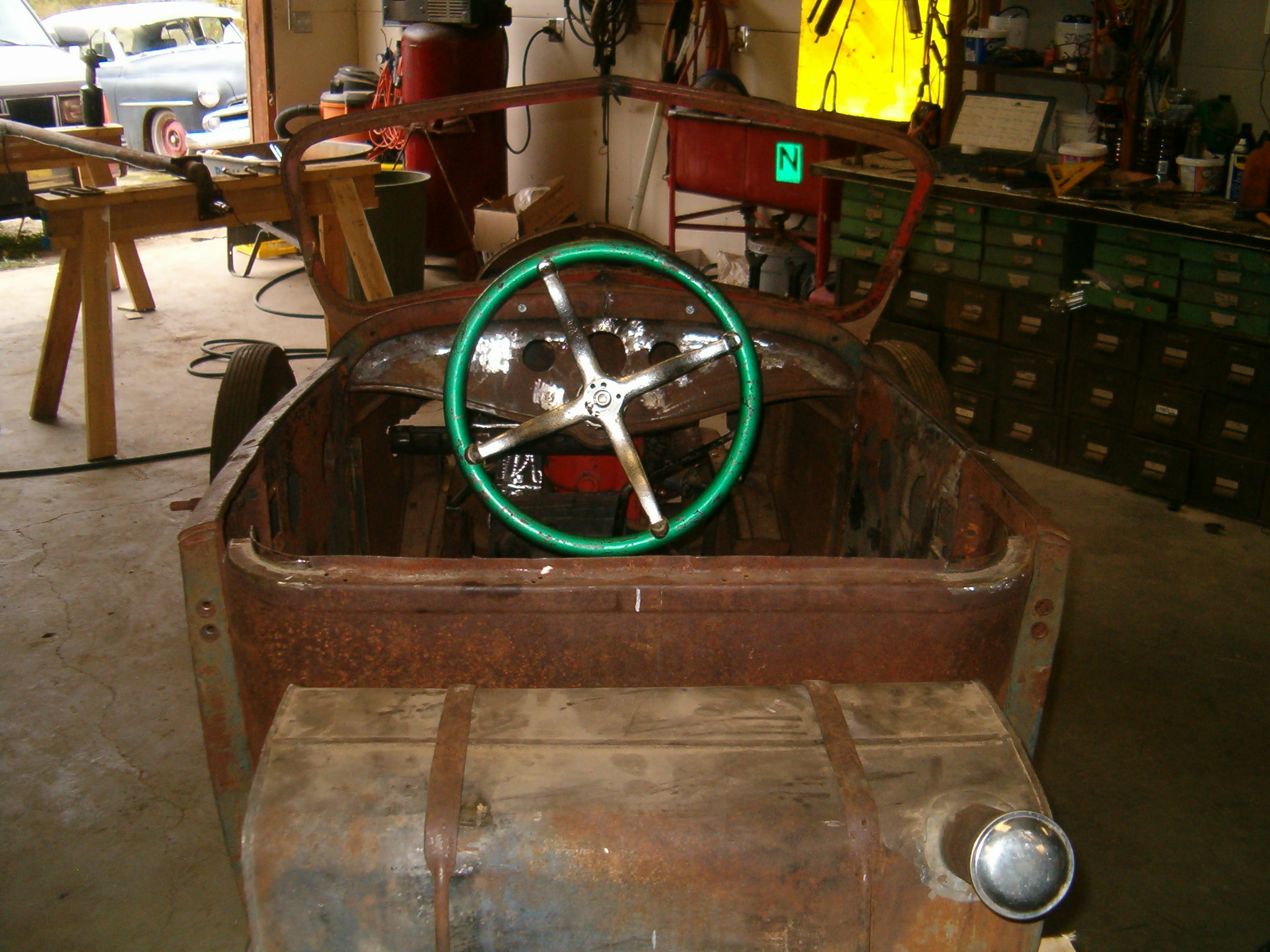

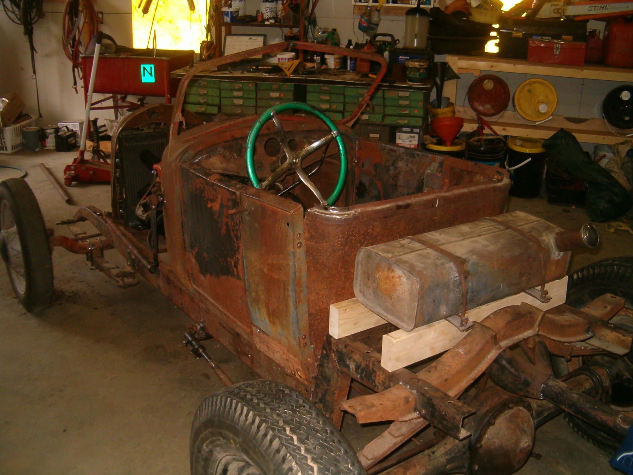

    shortened my driveshaft and finished the basic for suspension. brakes are near working and gas pedal is close too. push bar is getting there and steering is close. lots left ...but it's all there to do . everything is figured out except spark advance and choke . i'll build my battery box and gas tank mounts while I wait for a bushing and seal for my steering box.

    3springs 025.JPG thanks 64 dodge 440 . spent a week solid getting it this far in the latest thrash. so many details with a narrowed car . going to have to build a header as my exhaust is colliding with my brake pedal ...also ..looking for chunks from a gmc/chevy late 30s - 40s windshield. the lower p***enger side of mine is rotted . so if anyone has a broken frame ,,,,let me know. I love the new windshield idea , better than the cut up Harley screen . the new frame strays away from art gerricks car but she is beginning to take a shape of her own.

    going back to work on her this w/e . can't wait . this is the most fun project I own. got my check valves for the pressure pump that guffy sold me and the pet**** for the tank I need . she is holding water and ready to fire up again . need to rebuild the tillotson carb. but that should be easy enough.

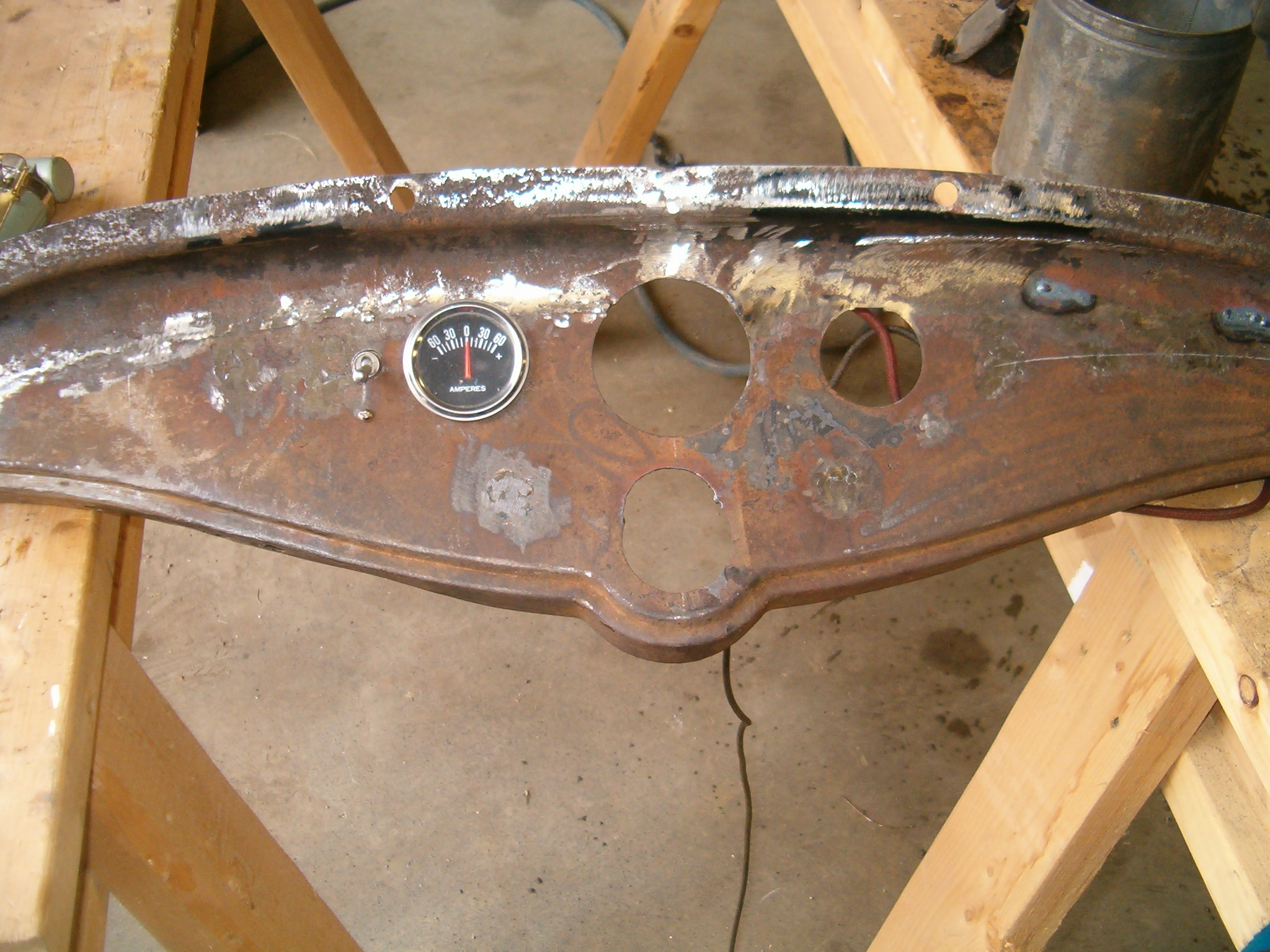

    started wiring

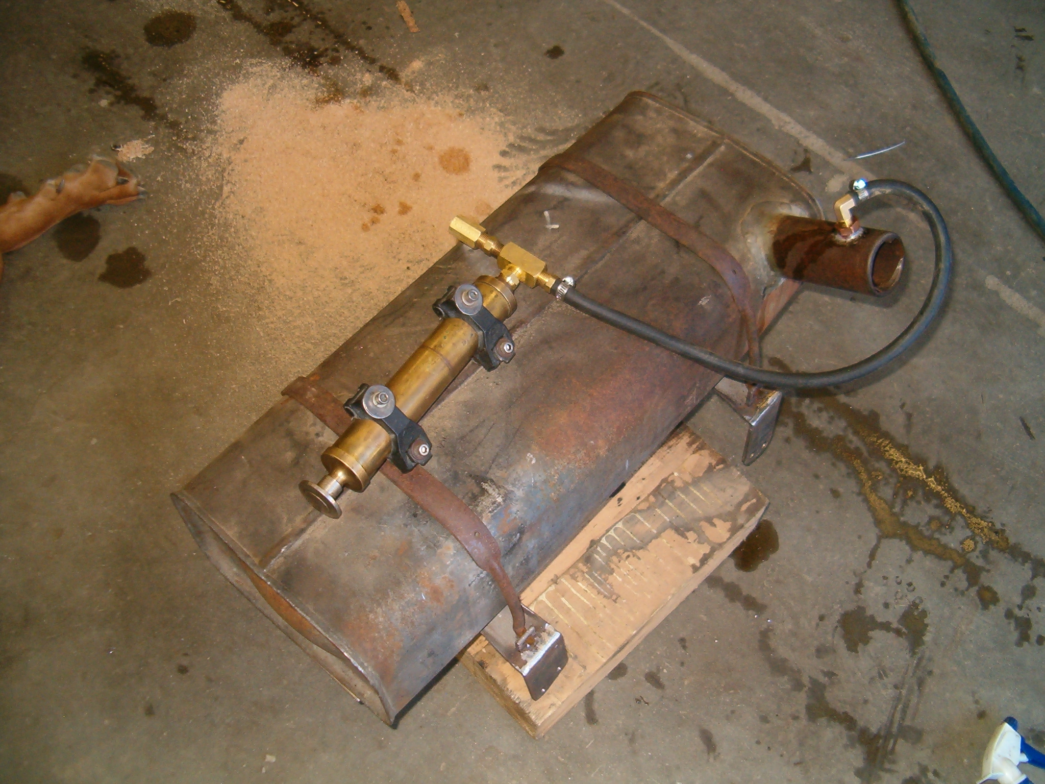

    got lots done last week end ....fixed my gas tank valve . made some stout frame brackets for the brake levers. did some more wiring ....
    I have a question ...
    .can I solder copper to steel?
    I am looking to place a bung in the filler neck of my gas tank so I can pressurize . can't find a steel one to weld . I tried to make one with a pipe tap and broke my tap driver. the 7/16" recommended hole for a 1/4" npt is way too small .
    any tips on tapping pipe thread?
  26. 64 DODGE 440
    Joined: Sep 2, 2006
    Posts: 4,436
    64 DODGE 440
    from so cal
    You can solder copper to steel, or you could weld or braze a steel pipe fitting to it, (think 1/4 iron pipe coupling).:rolleyes:
  27. bct
    Joined: Apr 4, 2005
    Posts: 3,199
    bct
    I havn't had much luck welding cast steel fittings . and I have never brazed anything since high school. I found a nice copper fitting in the plumbing section with 1/4"npt . I will fill my tank with water and try to solder it. the neck is soldered and riveted on (steel to steel) so it will be consistent. thanks 64

    To solder copper to steel you will need to tin the steel.
  29. bct
    Joined: Apr 4, 2005
    Posts: 3,199
    bct
    thanks alchemy. I have some ****er left over from another project so I will tin first.

    holding pressure other than the cap
