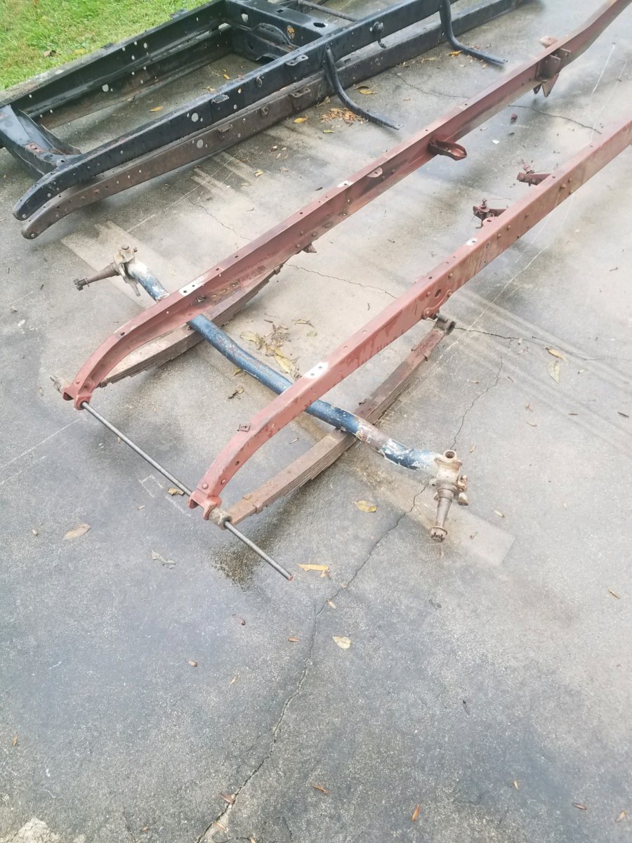

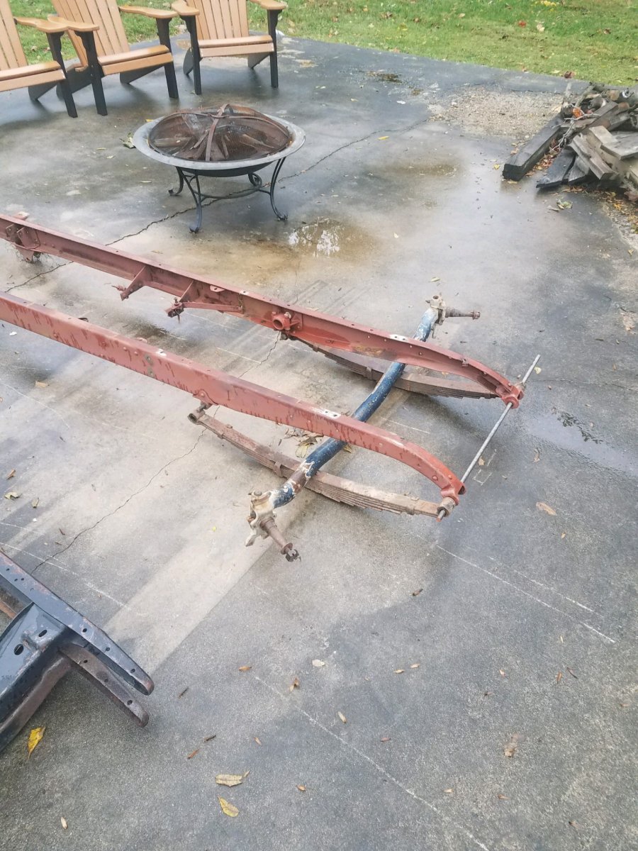

    Have collected all my parts I think by this point. looking for more pics like the spasmodic car. I have a lot of work to do with proportions to make it look right. Also trying to decide what grill to use. Also trying to decide how much to narrow frame and body.
    26 touring body
    wavy dodge front axle
    model a drivetrain
    27 chevy frame.

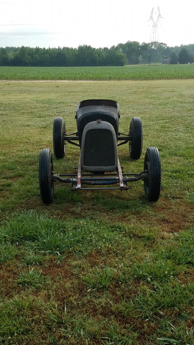

    Here is a neat old modified. Do you know of anyone who has built a one man car for the street? Would be interesting to drive... s-l1600 (2).jpg s-l1600 (3).jpg

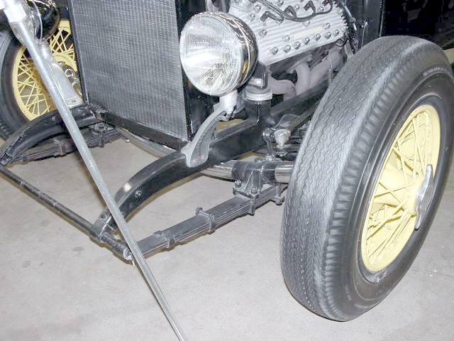

    What spring hangers were used for the rear of the front springs when they were moved outboard and does anyone have detail of how they made the support or crossmember for the front of the dront springs. Also i think im going to narrow my frame to about 20 inches give or take. I think tbats in the ballpark. I am open to any suggestions.

    I just spun my spring hangers 180° then made a spacer plates to adjust my springs parallel . I still need to add a triangular gusset.

    I used quality 9/16 fine ready rod for the front spring mounts. Slid some dom between the stock hangers on the frame horns.
    20 inches sounds good. I made mine 22 and I wish I went narrower.

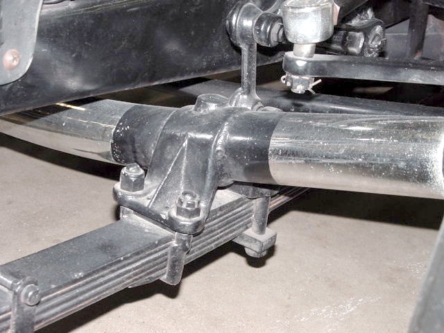

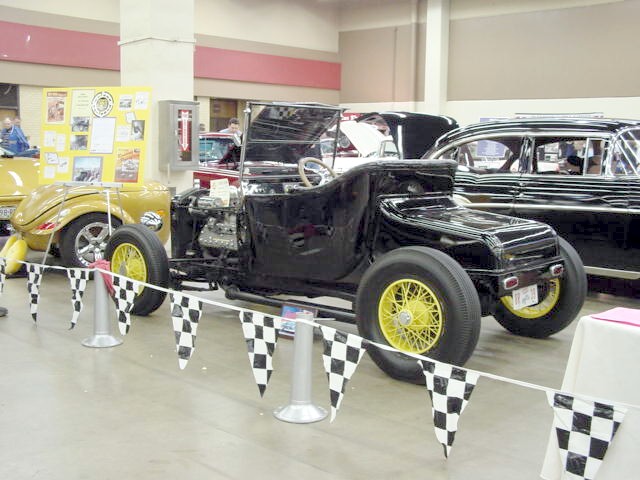

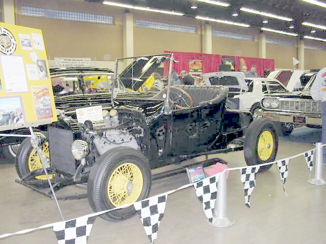

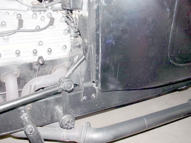

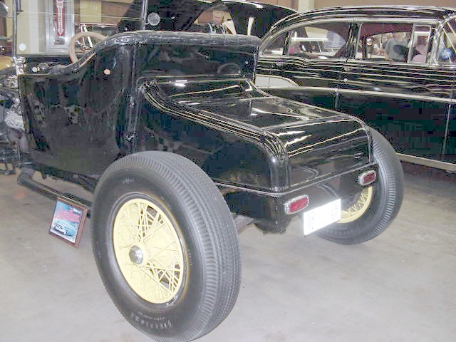

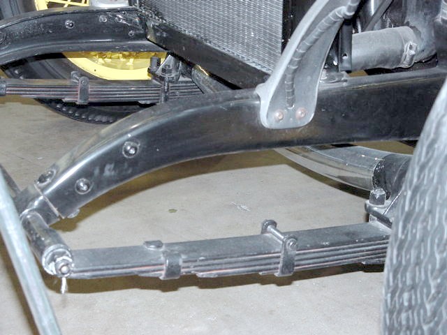

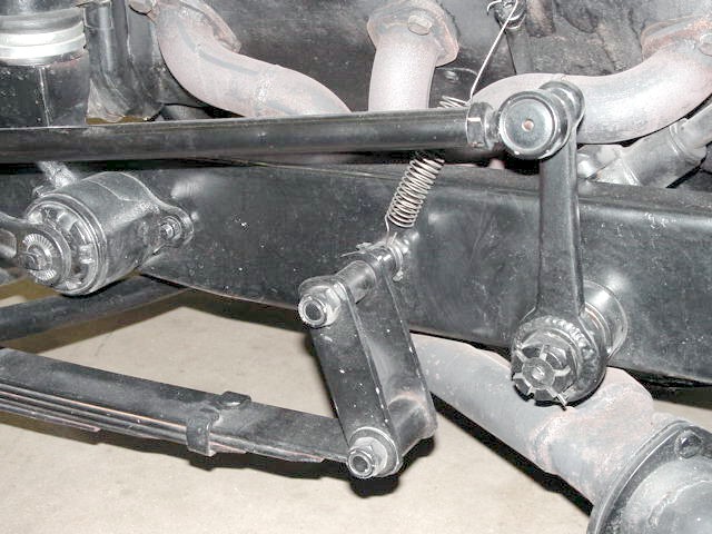

    I was going through the photos on my computer and found these I had taken back in 2007 at a car show in Fort Worth. Here are several shots showing the front spring setup on Phil Weiand's old T. Also shows a body mount bracket on the cowl. RearView.jpg FrontView.jpg AxleMount.jpg BodyMount.jpg FrameDetail.jpg RearDetail.jpg SpringMount.jpg SpringMount2.jpg
    I prefer the cut-down body on the Weiand car. I had no idea it still existed.

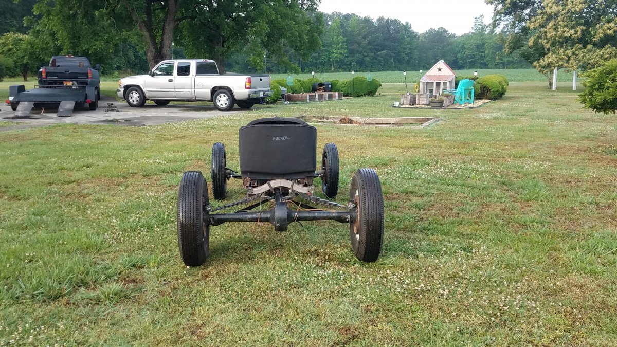

    Here is what I have so far

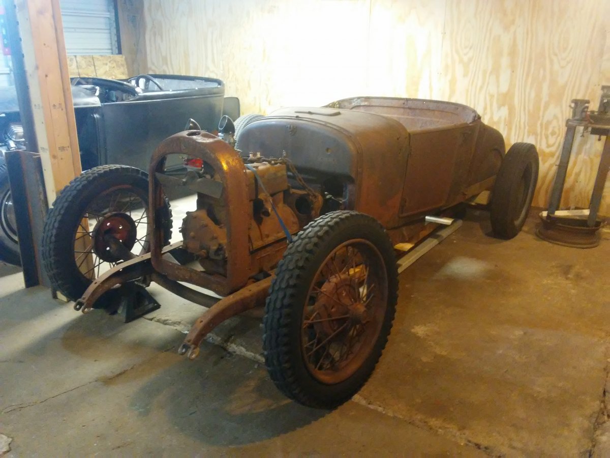

    Next...been a while after our move but I'm getting closer. T Roadster. B engine. '28 Chevy frame. Franklin axle. Oddball Whippet shell. The rest as it comes. 20171203_204039.jpg 20171203_204107.jpg
