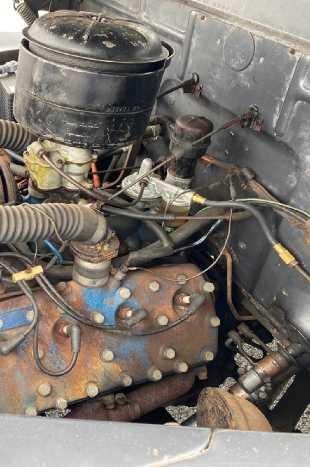

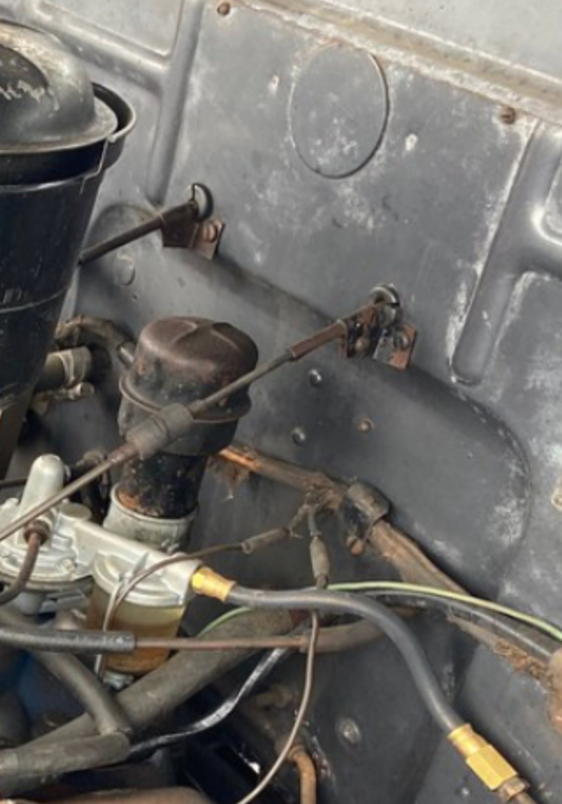

    Does anyone know how to install the throttle and choke cables? I'm bringing my '46 Ford coupe back to a stock flathead. I have no idea how to run these new cables through the firewall. The holes on the firewall seem too small for the big rubber tube located in the middle of the cable.

    I grabbed this off the internet. Is this what you’re talking about? The two rods?
    The big rubber things are vibration separators and “elbows” to allow them to flex.

    Yes Jim, the holes in the firewall are too small for the elbow to go through. The actual knob is forced fitted on and can't be removed!

    The last time I messed with those, the repro ones I bought were one long ***embly.
    I took a screw driver and on the firewall side of the big rubber thing, gently pried the crimped part open enough to slide the rod out. Then once everything was installed from the dash out to the engine I inserted it back into the crimp and crimped it back down with some plyers.
    I have also heard of some of the repro ones not having a crimped end and the rod is just pushed into the rubber. I never have but I’ve heard of guys pulling the rod out of the rubber and after ***embly putting JB weld in the rubber to anchor the rod.

    I'll try both, the rubber seems to be on there perminantly. I'll try uncrimping the cable.

    I managed to seperate the rubber tube from the throttle mech. I think I'll use a good vulcanized glue to put it back together, but it did work.
