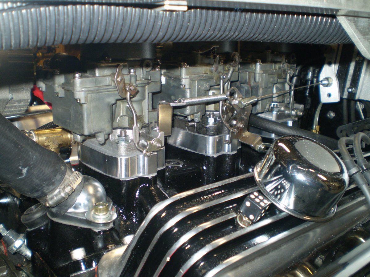

  6. here's my SBC W/ tri power. All three carb bases have spring returns built in and I use a return spring on the primary. You can see the cable is straight in line and the pedal is in line with the cable inside. Copy of dashman pics 002.jpg

  9. how did you mount your cable bracket? doesn't look like it's mounted to the rear carb.

  14. Nope, I mounted it to the firewall right in line with the gas pedal. Sorry I don't have a pic. of that and I've sold the car.
