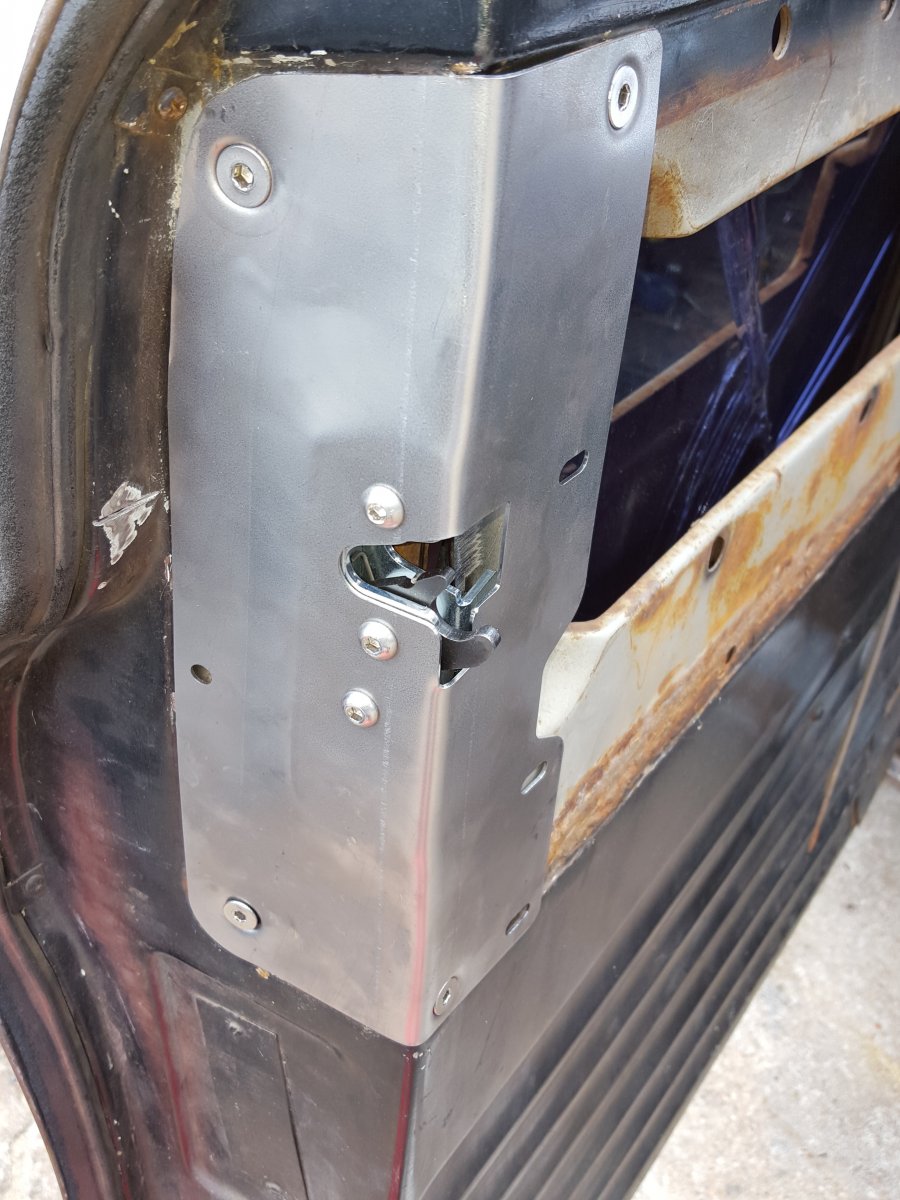

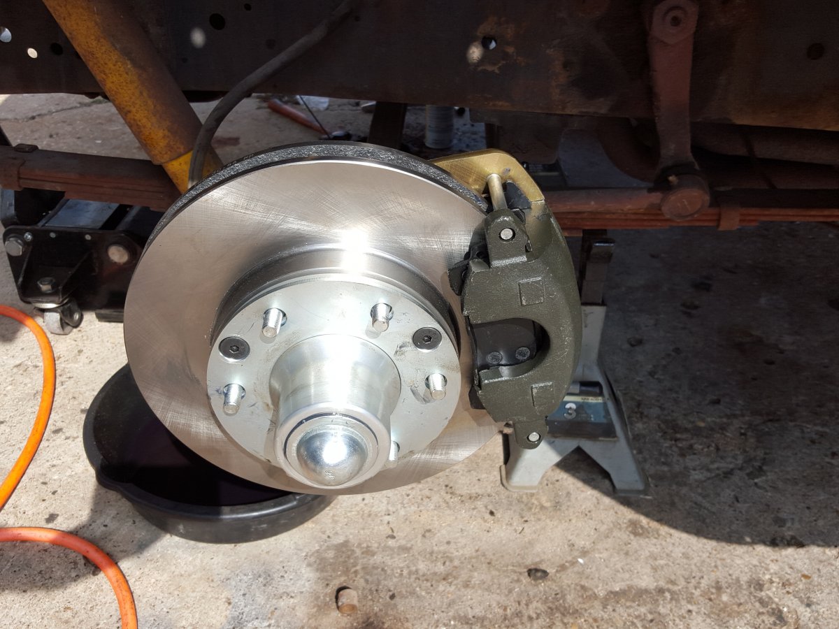

    I came across this thread… unfortunately I am the guy who had the throttle cable jam open and cause an accident in my truck. That was an eye opening experience and it made me take a much different look at all of my cars' safety. The one bit of advice I can give anyone about the throttle cable is make sure there is PLENTY of cable between the carb and the firewall to accommodate any movement from the engine under acceleration or braking. In my case the previous owner didn't leave enough cable length in the throttle cable so when I was downshifting and hard braking the motor shifted forward and caused the braided steel cable housing to pull out of the aluminum bolt sleeve that holds the cable to the bracket and prop the throttle wide open. All hell broke loose. I replaced the throttle cable and rerouted it with extra length and reworked the firewall mount. I also went back through my truck and replaced the drum brakes with CPP disc and hub kit, I replaced the factory door latches with Altman latches, I replaced the steering wheel, I replaced the door gl*** and I did some electrical work all to try and make the truck safer and more reliable.
