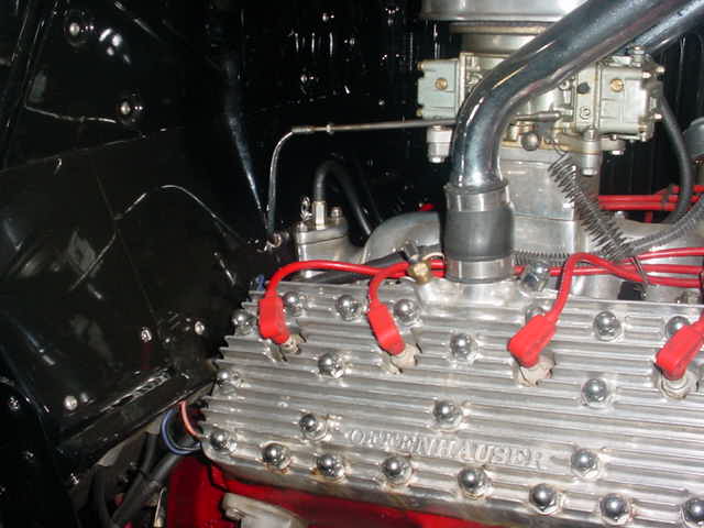

  3. I'm with Deuce Roadster on this one,,,,,here's how it was done on my flatty,,HRP
  4. OK OK guys I hear yas...I agree on a steel ride that would be the way to go.
    But Ill be running a single 2 bbl to break it in, then ill be going to a PM7 then the 4-71 will be going on so I need the flexibilty that a cable will bring.
    Maybe down the track I can knock up a steel rod setup with the 4-71 but for now I just wanna get this thing going.
