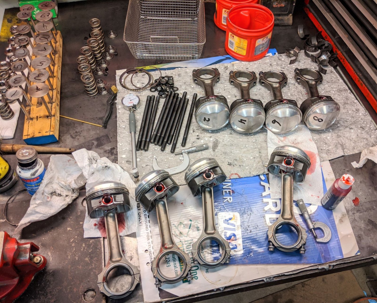

    Slayer, here is the scoop on the Hemi:
    Short block:

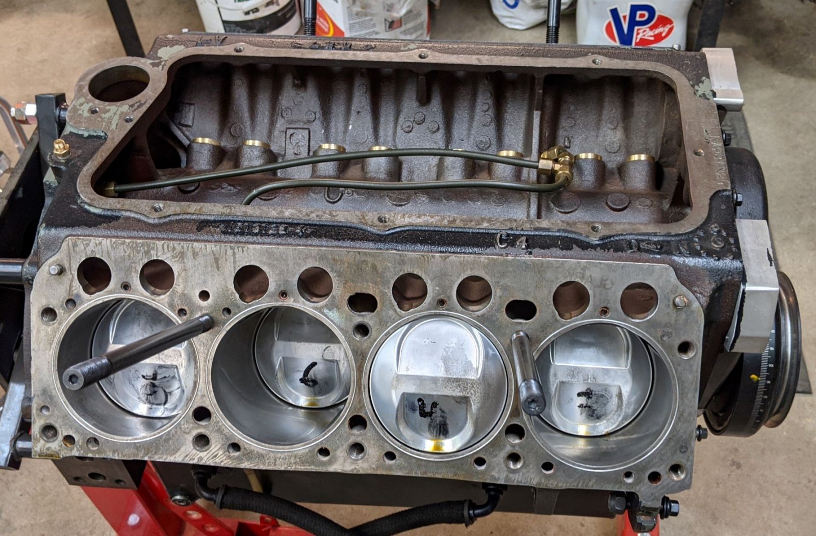

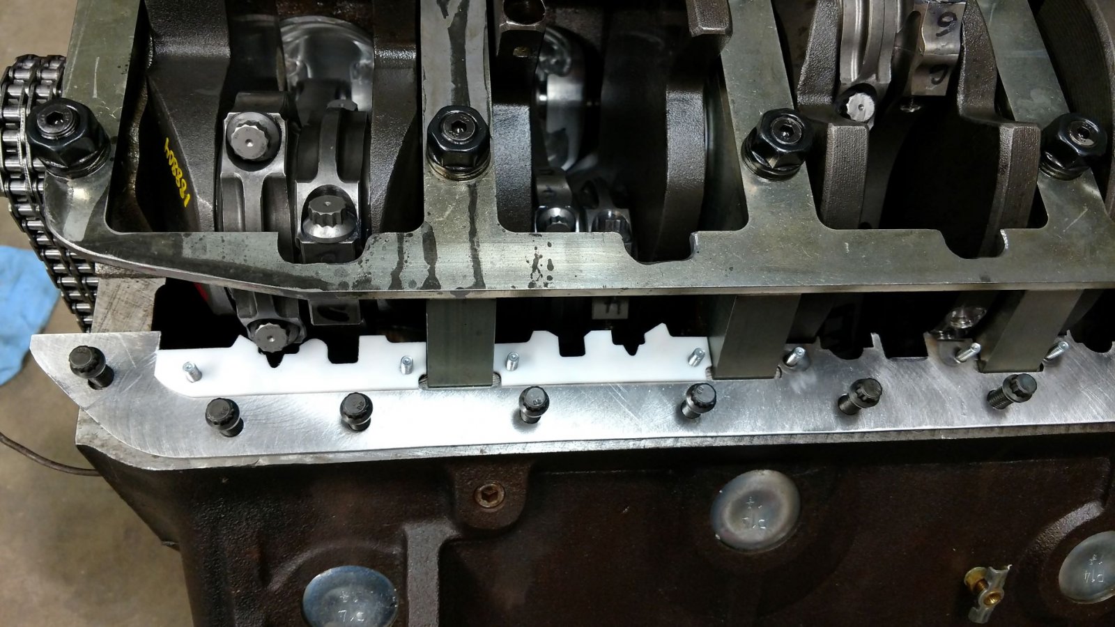

    .060 over 392 block 1/2 filled with Hardblock polymer fill, O-ringed deck
    Bronze bushed lifter bores, bushings drilled for full oil pressure to lifters
    4.525 (5/8 stroker) billet crank. I am not sure of the brand, I bought it used and it is unstamped

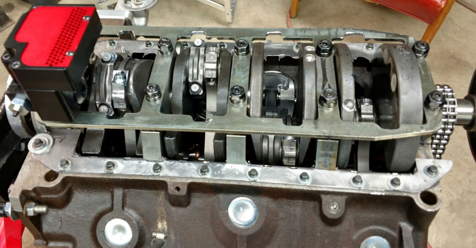

    Milodon steel 4 bolt main caps
    TR Waters main stud girdle
    7.1" Oliver steel parabolic I beam rods
    Diamond 13.5:1 pistons
    Total Seal rings with C33 nitride chrome plating
    ATI small block Mopar Superdamper, bore honed and keyway re-broached to fit Hemi crank

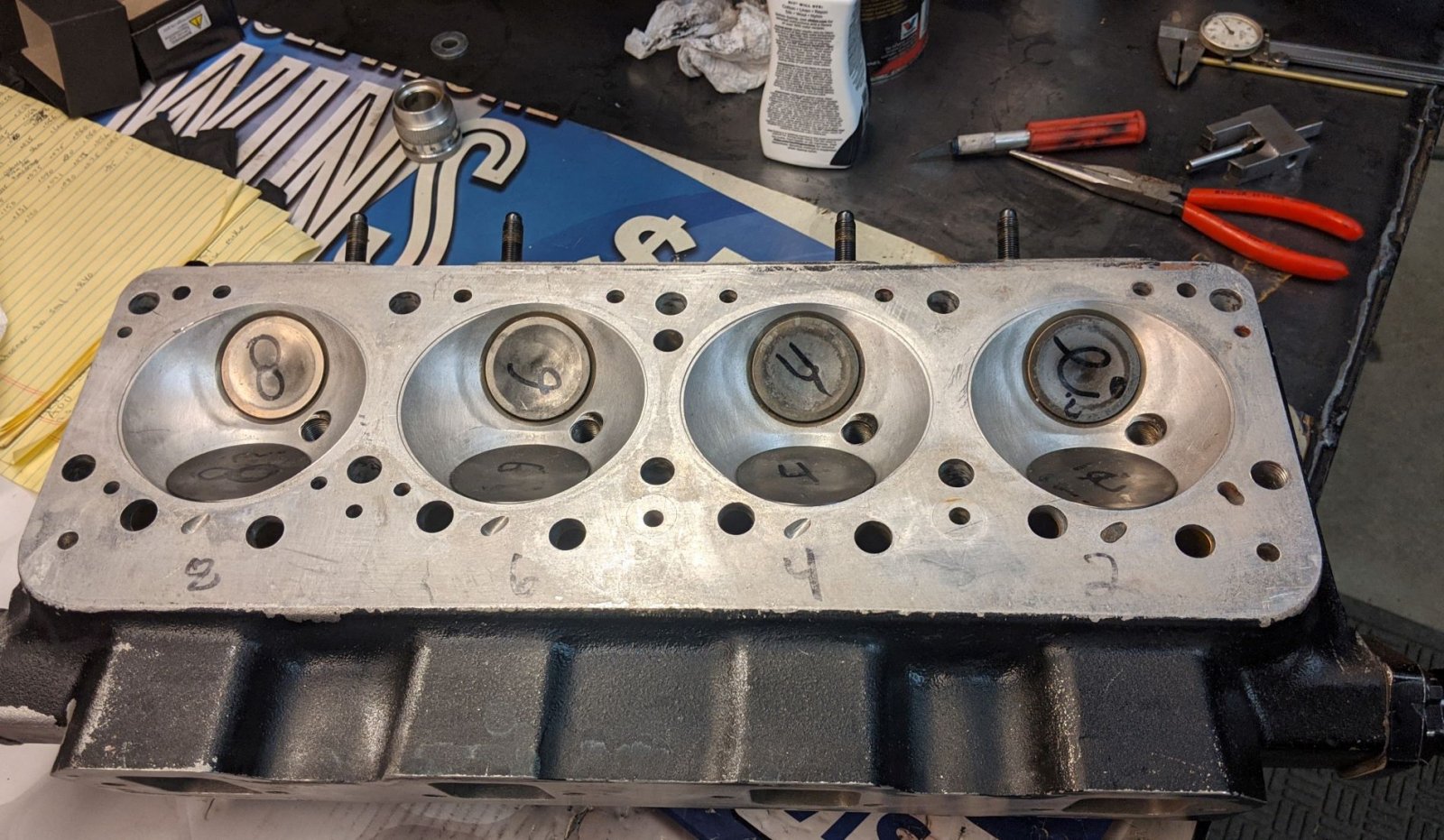

    Hot heads aluminum racing heads, ported by Nick Smithberg
    2.200 Ti intakes 1.800 stainless steel exhaust valves
    bronze guides
    Clark copper head gaskets

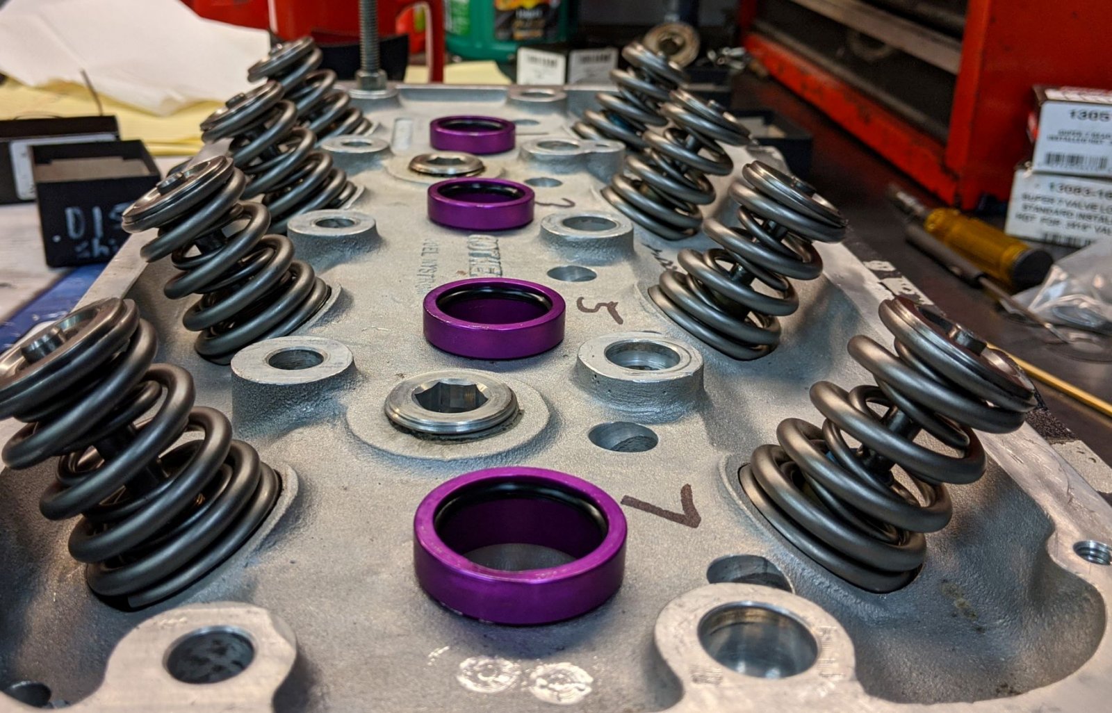

    Comp Cams conical valve springs and Ti retainers
    Pac tool steel 7 degree locks

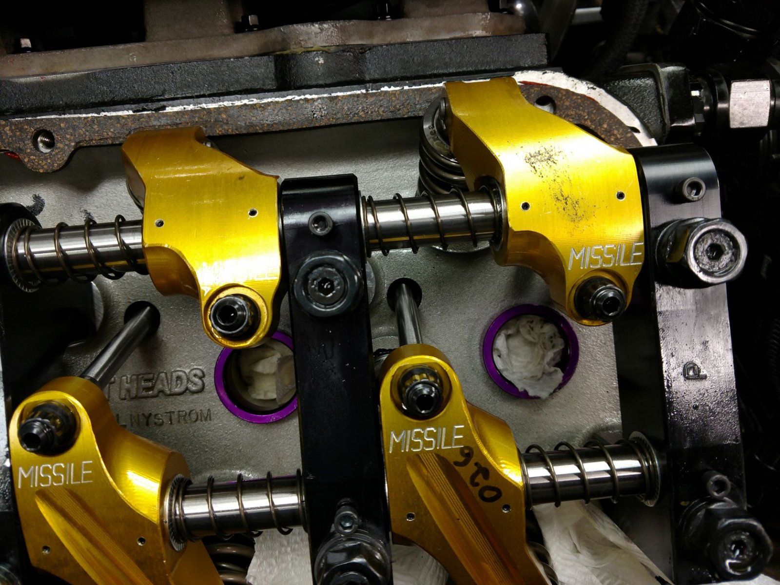

    Missle roller rockersthat I drilled and tapped 4-40 set screws into the bushings to prevent rotation

    Internal oil lines byp***ing the cam bearing oil feeds, sending full pressure to the rocker arms (For drag week reliability)
    A pair of -8 oil return lines from each head to the oil pan. (to get all that oil out of the heads)
    .024" hole drilled in the rear oil gallery plug to spray on the cam gear

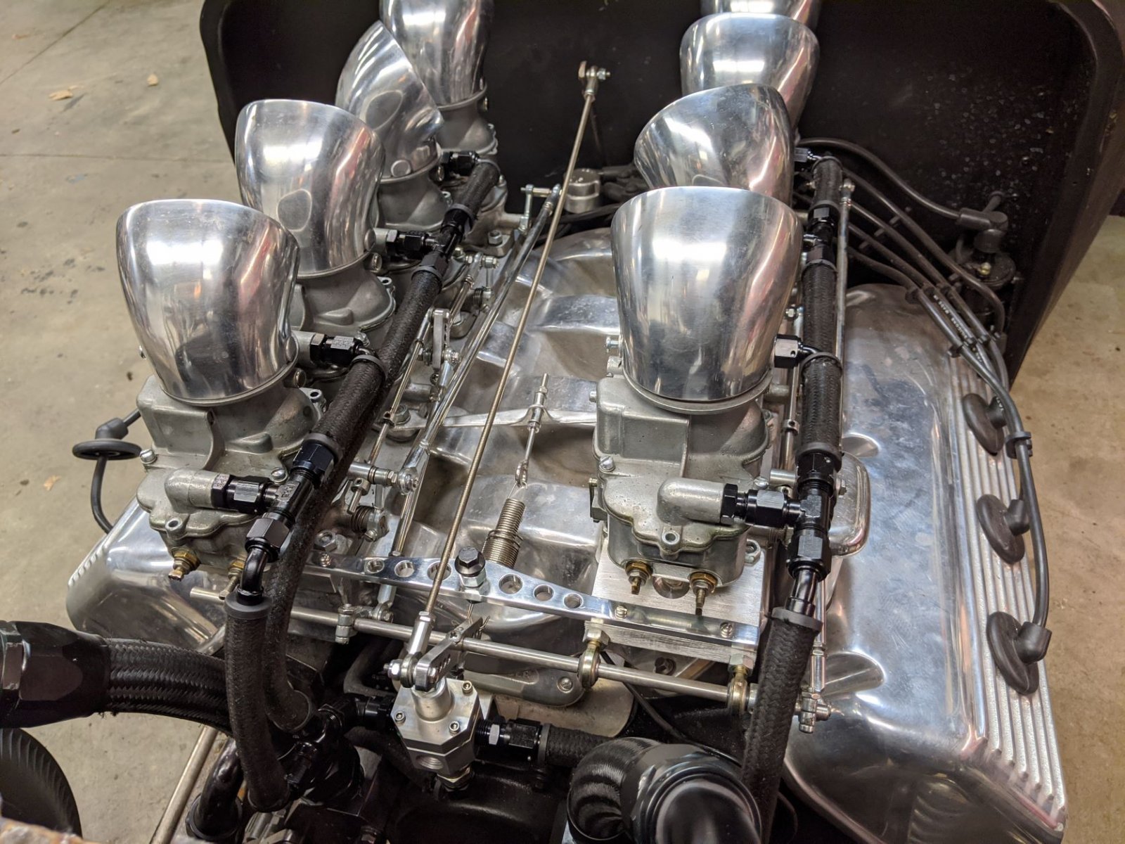

    Hot Heads valve covers and timing cover
    vintage magnesium valley cover
    MSD distributor
    Taylor Spiro-pro plug wires
    custom built headers
    Edelbrock 8 carb X3 intake
    8 1-1/16" Holley 94's
    custom built linkage
