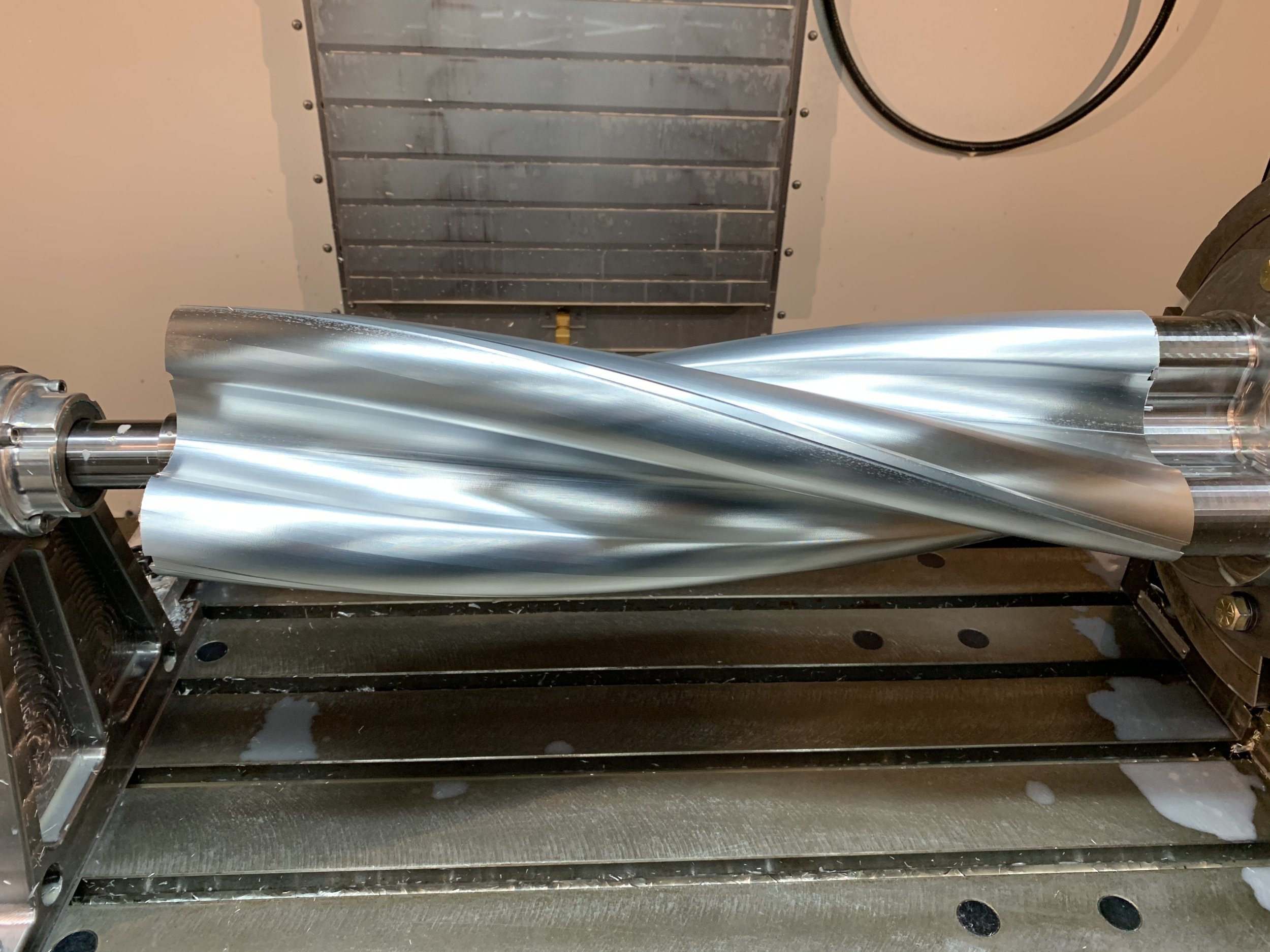

  14. Yes, we can do things today that could only be done by huge corporations with teams of CAD/CAM folks and hardware/software tools that were too expensive for almost any smaller company to afford. The CAD/CAM and CNC machine world has really progressed in the last 5 - 10 years.
    Here is a picture of a 14-71 compe***ion rotor that I designed - and later produced on a HAAS mill (couple years ago). I could not have imagined having the tools/technology to do this 20 years ago:
