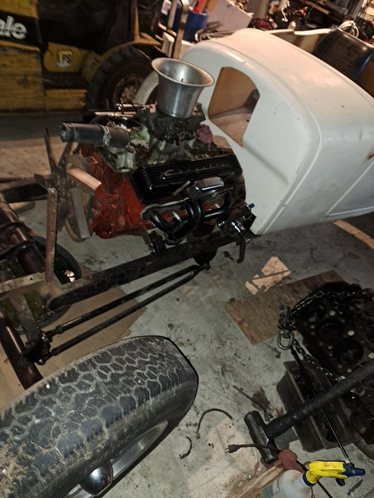

    I have a pretty old Speedway frame front axle / kit I bought at least 25 years ago used.
    I'm finally getting back on making it into something.
    I'd like to have the tierod behind the axles not in front as it came.
    I have ford spindles with non bolt on arms on a spring behind tube axle with hairpins .
    Spring on a perch .
    It appears I can run the tie rod through the hair pins
    My question is how much clearance do I need above it between it and the frame ???
    I have no idea what the travel will be on one of these .
    It's a basic t bucket type front set up with what ever spring speedway would have sold.
    Jumping on the front dosent give me much travel
    SBC for now. Maybe a 4 cylinder later .
    Ignore the brackets for the moon tank it was never driven like that and there coming off. 20221211_114439.jpg 20221211_114439.jpg 20221211_114450.jpg 20221211_114450.jpg 20221211_114439.jpg

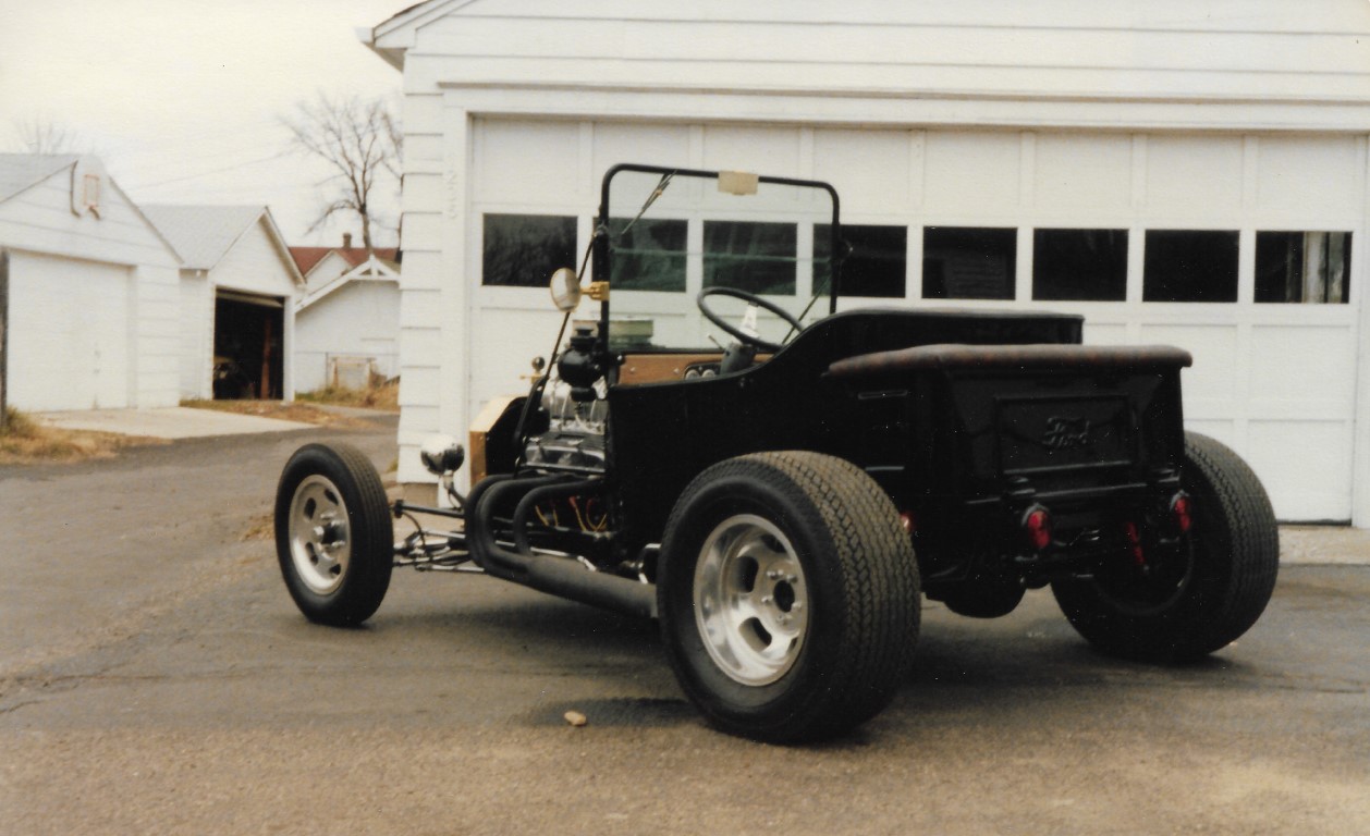

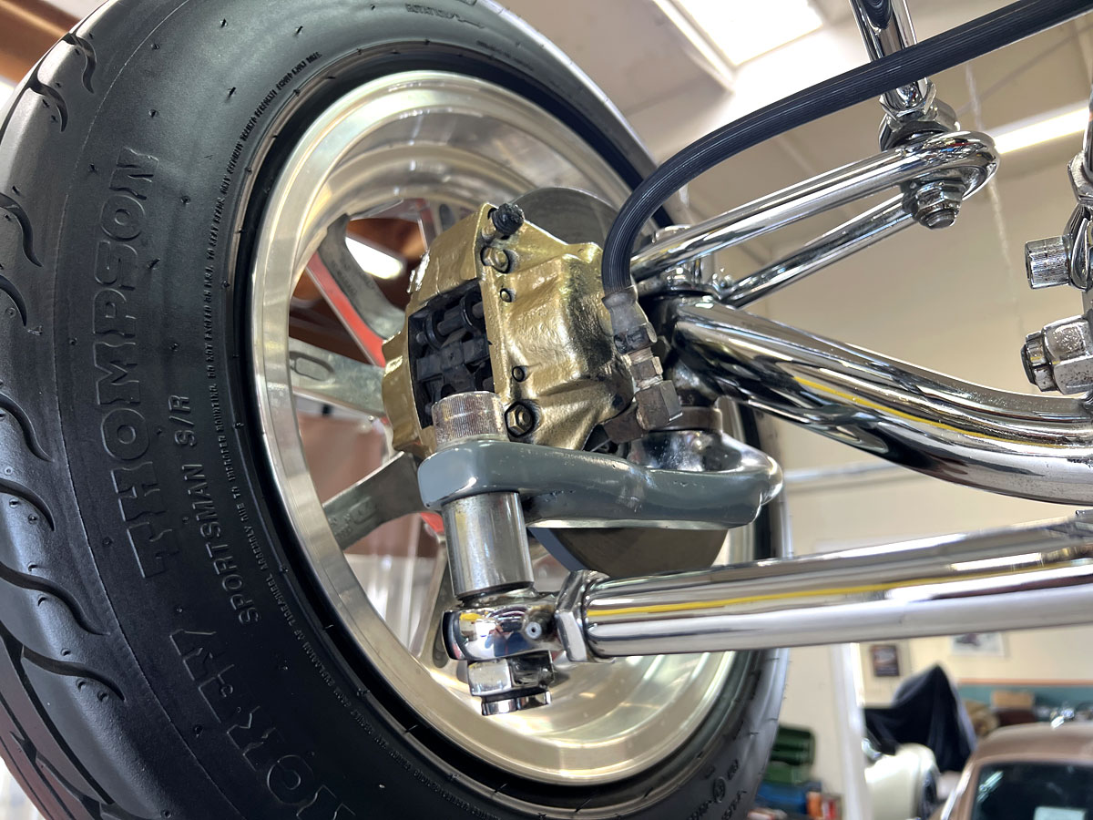

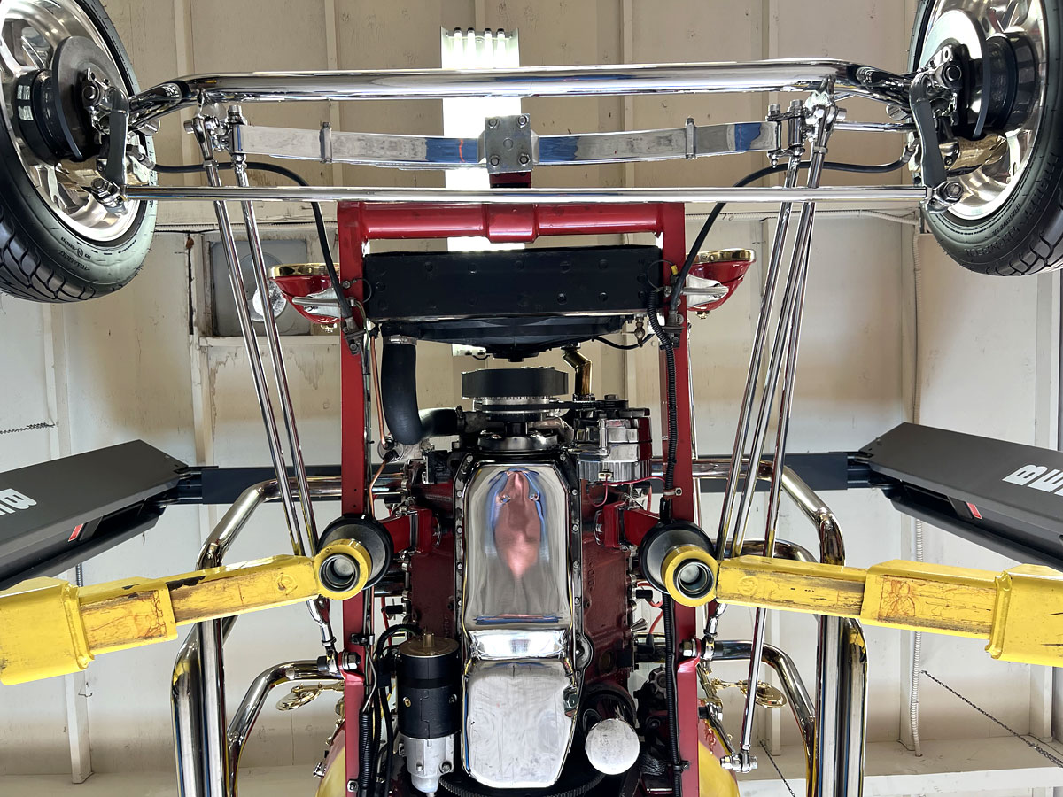

    The T I am building right now was purchased from Speedway in 1995, I borrowed a friends fairly current "assembly manual", here is the page pertaining to your issue. Hamb T.jpg
  18. Wait a minute.......the entire front suspension goes up and down as a unit when encountering bumps, holes or dips. The relationship between tie rod and wishbones doesn't change, at least mine doesn't. 34frontXmemberdone.JPG
    Tim, Just Gary, bchctybob and 2 others like this.

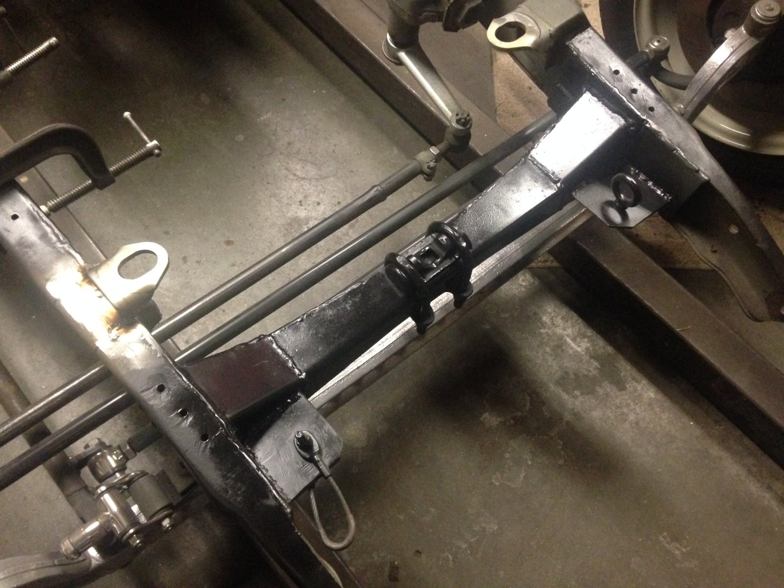

  19. I have run them both thru and under the wishbones depending on how things matched up. The one with WW has the tie rod under the wishbones due to a lower arch spring. It has Ford spindles with the arms heated and bent; never gave me any trouble.
    The one with the Fenton wheels was run thru the hairpins as this car had a higher arched spring; never noticed it happening but there were slight marks in the paint on the bottom of the frame.
    The extra length your combination of a L/H and R/H drive spindle should give you plenty of room to go below and clear the spring shackles.
    Remember the tie rod swings up as it moves left and right; check your clearance lock to lock.

    Those arms look a bit longer than stock ??
    Does yours have that style of flat bolt on arms ?
    Looking like I don't need as much clearance as I thought .

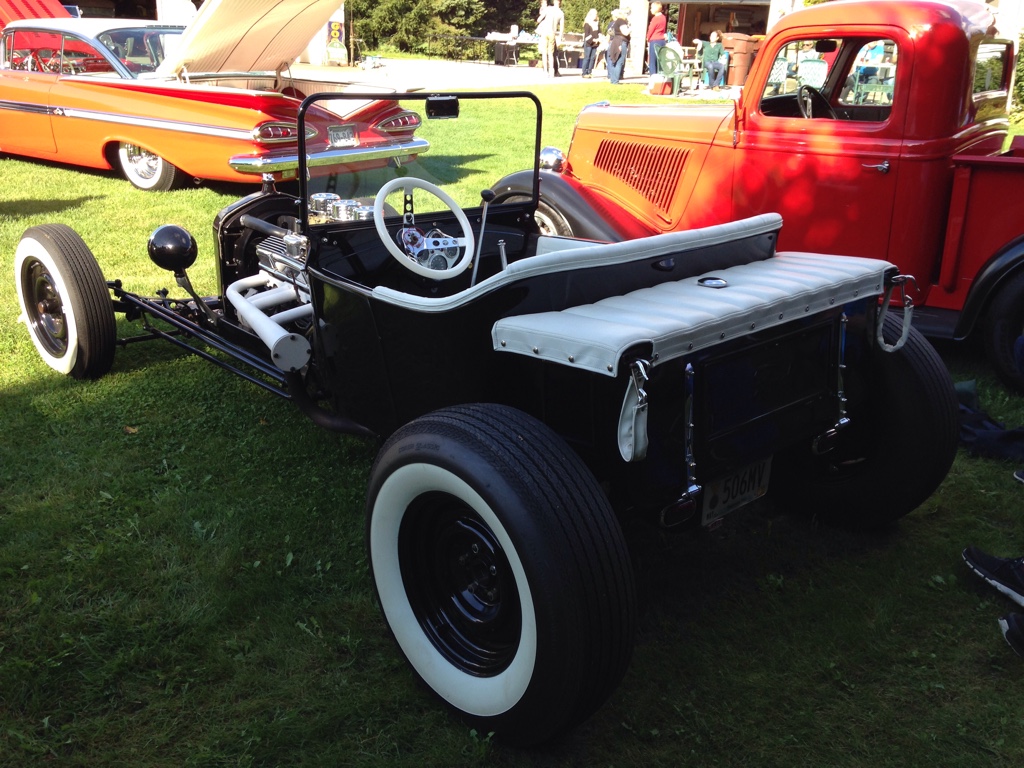

    I have 50k miles on my T , steering is side delivery tie rod behind axle , through hairpins . I have 1 1/2" clearance between tie rod & frame , less when wheels are at full lock , while I have scraped the paint on the tie rod , its never caused a problem . The total up & down travel of the front axle is 3/4" compression 1" drop . If I have time I could take a picture.

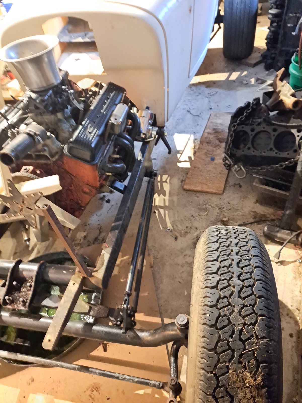

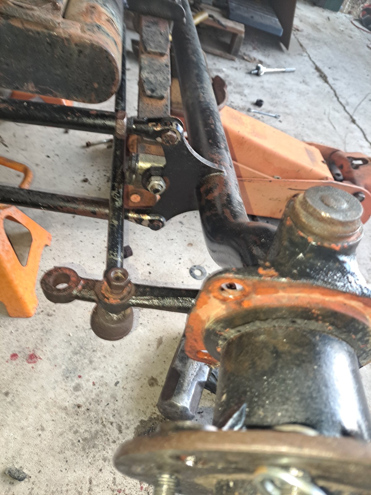

    Well after about 4 hours I managed to get the king pin out of the axle ( never should have left this out side for 25 years) and flipped the spindles around so the arms face the rear .
    The arms are about the right height to put the tie rod through the hair pins BUT the the tie rod will hit the shackles if I turn .
    One of my spindles is for a RH drive car so the arms both have two holes for cross steering. Great I'll use the second hole further back
    BUT the taper in the hole for the tie rod is opposite of the front hole putting the tierod end on top .
    So my question is can a ream the taper in from the opposites side part way in and run the rod end on the bottom . I have the proper tapered reamer . I'm just not sure if there will be enough support with the hole only partially tapered the right direction .
    Probably not a good idea to weld up the hole and Redhill and taper ??
    I'm guessing that those flat bar steering arms speedway uses must be longer than stock.
    I'd rather not use those and heim joints and gave to cut my arms off.
    I have a set of aftermarket steer arms ( look cast ) and there to short to clear the shackles and bat wings also .
