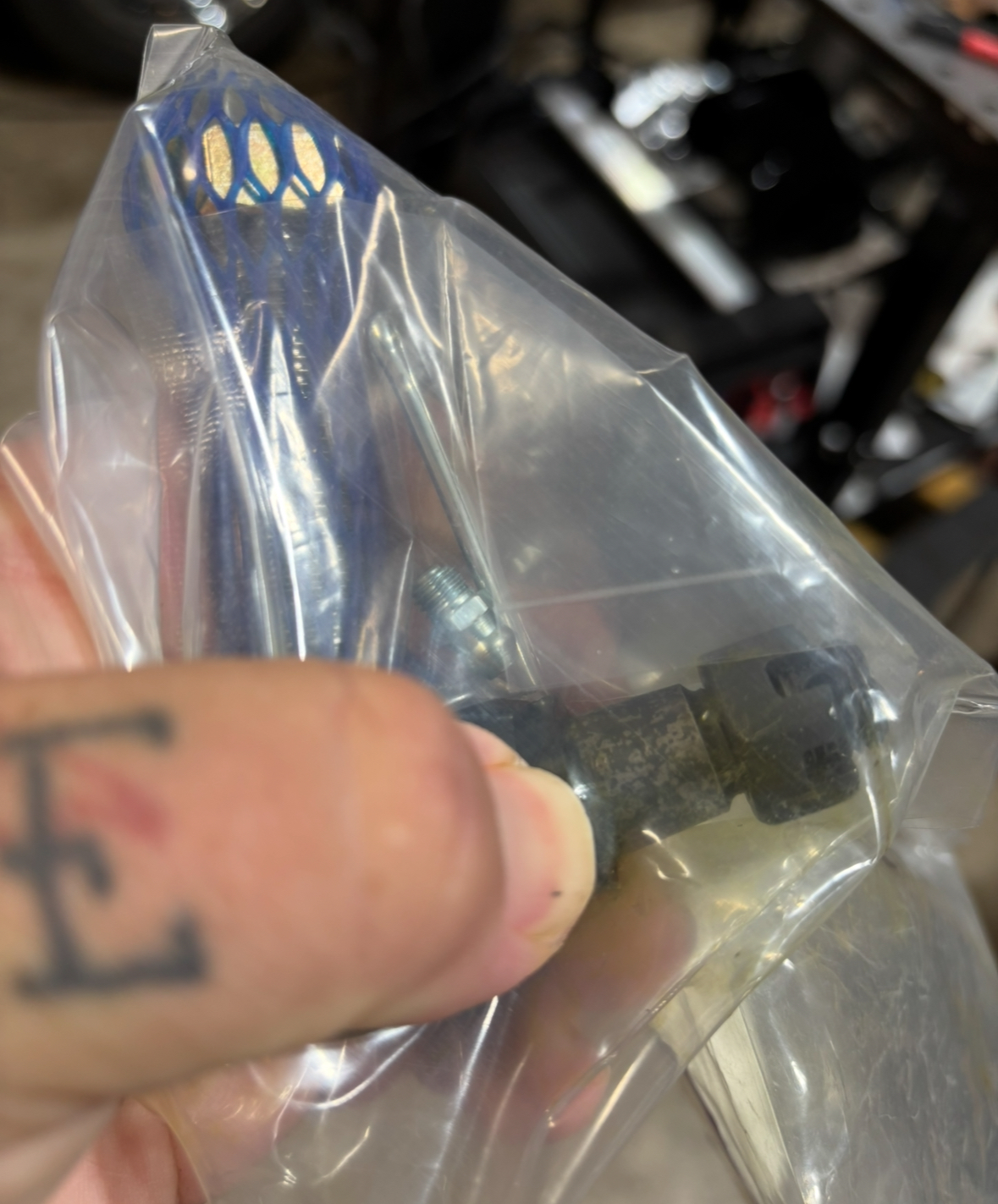

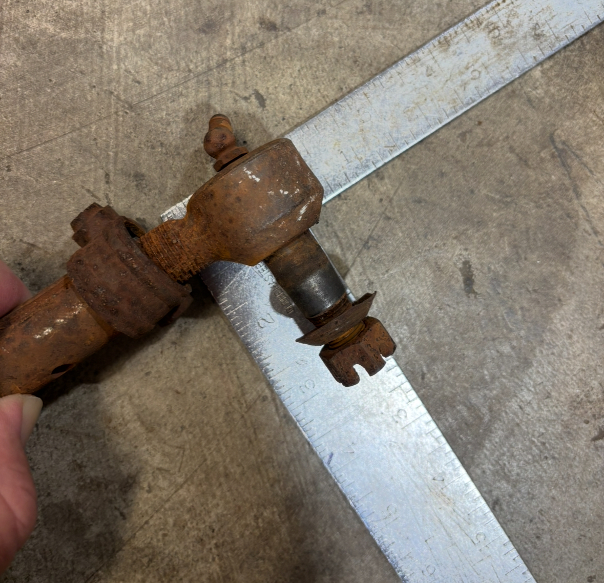

    Alright here we go IMG_0283.jpeg 46 ish ford tie rod with the boot long gone the rusty area between the top of the rod end and the tapper that fits in the steering arm is 1/2”

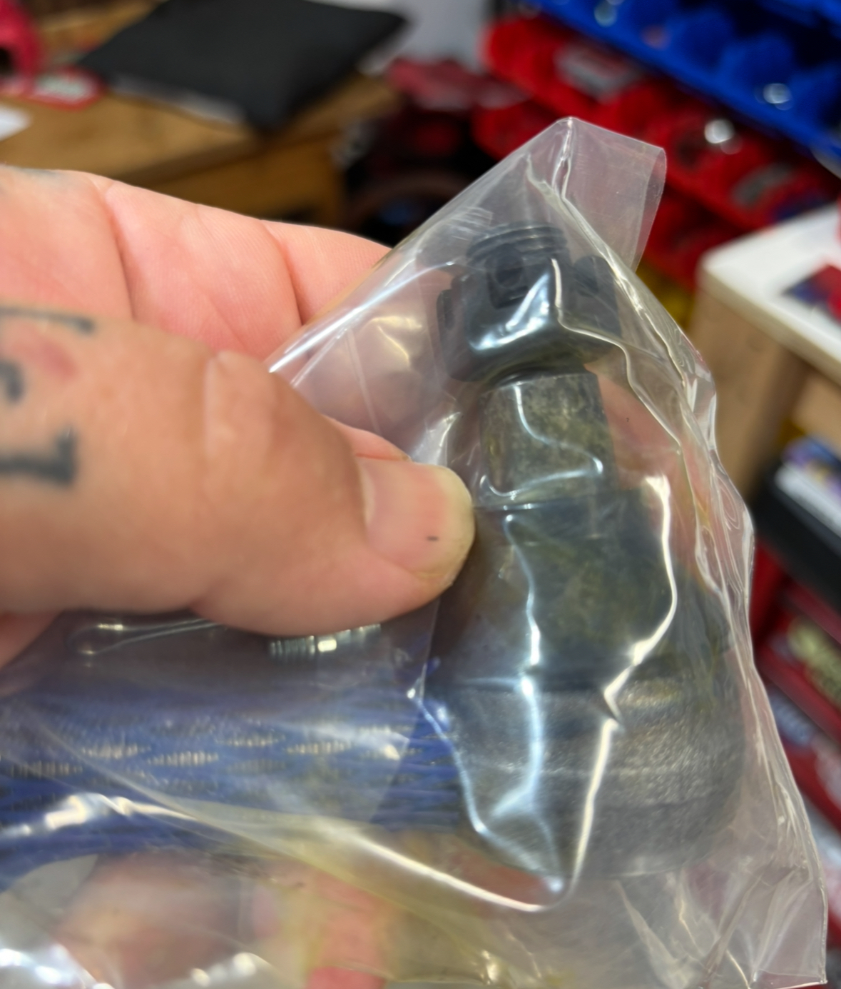

    IMG_0284.jpeg IMG_0285.jpeg on a new replacement rod end the taper depth is 9/16” and the boot height is right at 3/4”
    I included the taper depth because I’ve seen steering arms where the entire tappered section wasn’t all the way into the arm. So ***uming you use a brand new rod end ( this ones from speedway) and mount them from the bottom of the arm
    You should have 3/4” from the bottom of the arm to the top at the rod end.
    I do have one of those dropped rod ends in the shelf also should you want a specific measurment

    Thanks @Tim thats great info and I appreciate your time. With those dimensions it will be close but should fit and will give it a go. Will just order the standard ones for now. Thanks again.
