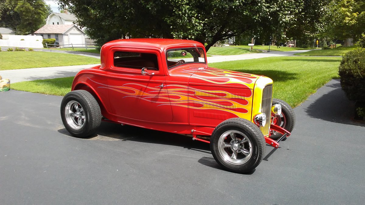

    Getting familiar with my `32 ford I got over the summer. Anyone have an idea of what the torque spec would be for the tie rod end castle nuts? From what I know they are Ford tie rod ends on a Speedway forged I-Beam 4" lowered. 001.jpg
