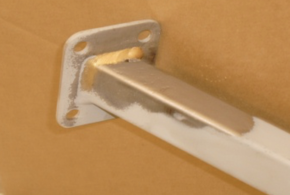

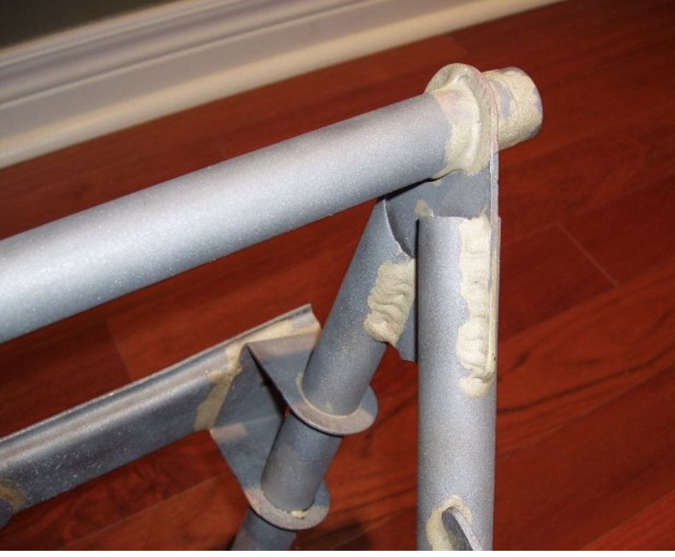

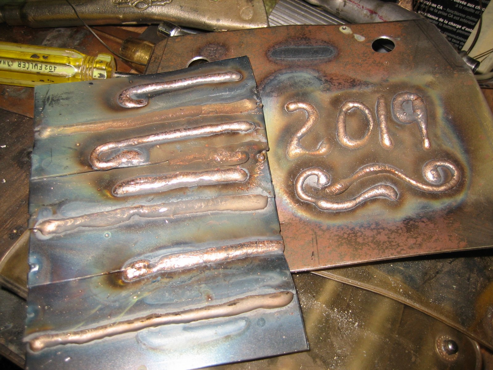

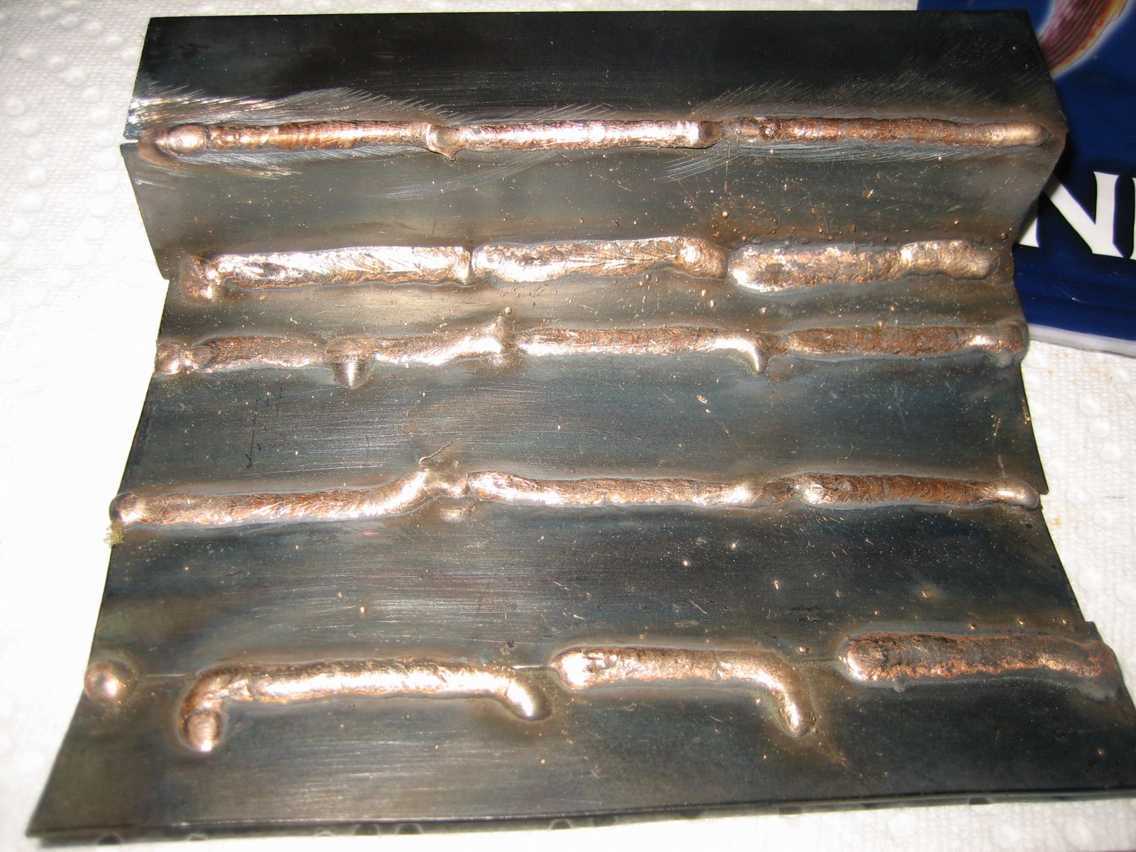

  2. C3FE6D99-4EE3-4846-8676-D29A56B43B89.jpeg DA95862E-E62A-477F-B7AB-81F6FCB8ADE3.jpeg
    some random online pics.
    This would be the worst looking parts. The E Type structure has some clean looking work as well. There was a “furnace brazing” process for some of it.
    The guys familiar with the Reynolds’s process might chime in

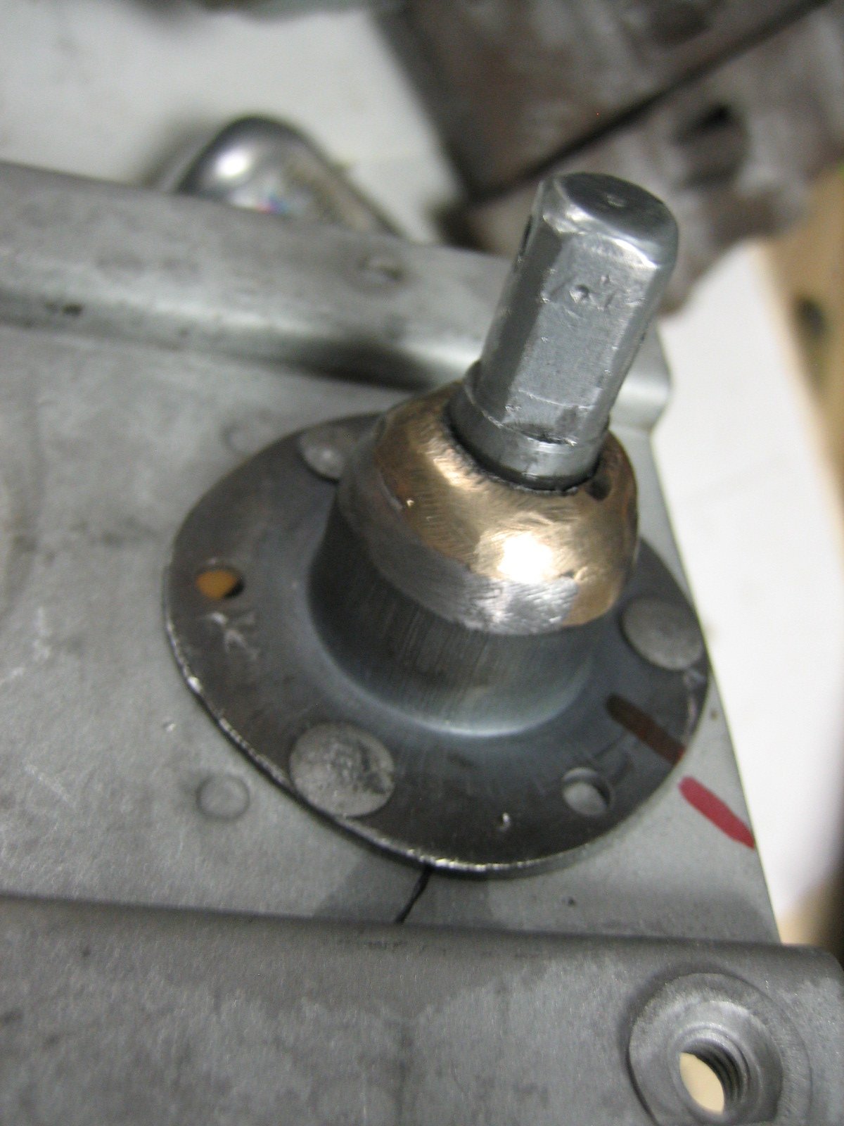

    More E-type work
    There is also some interesting bicycle and motorcycle brazing as well

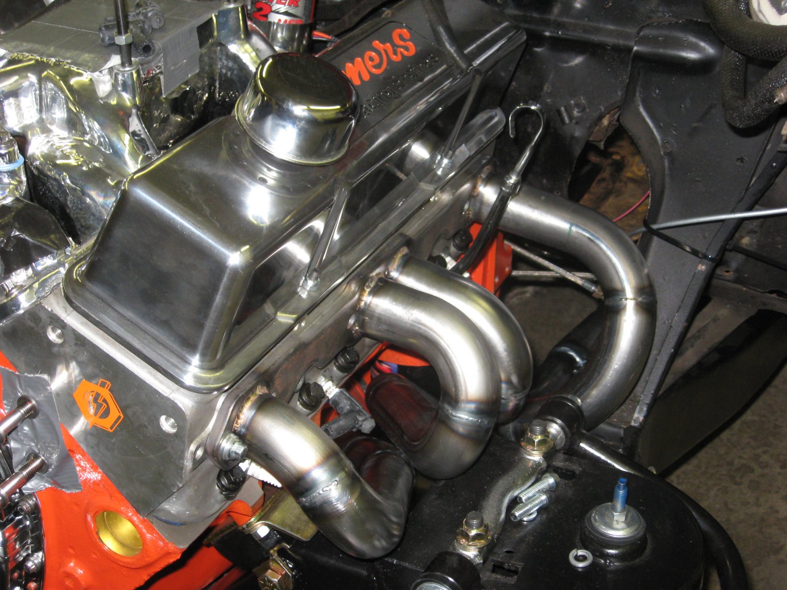

    I can see by your work you will not have a problem, and it's the way to go on small holes. I also use it on the outside of header flanges, after welding the inside. IMG_1169.JPG
