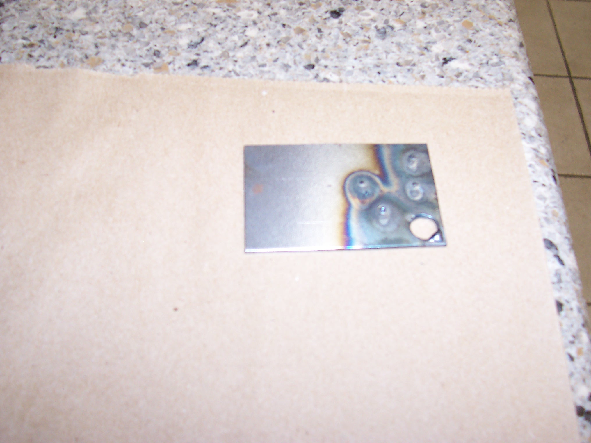

    009 (2).JPG I've had the same problem with my Syncrowave 180 machine. Once in a while when welding sheet metal (usually 18 or 20 gauge), I'll get a huge arc when I step on the pedal and burn a 3/8" diameter hole right thru. It doesn't happen every time and may weld just fine for a while, then does it again. The current control dial was set at 30 amps max, so I'm not giving it too much pedal. I thought I might have had a problem with the pedal ***embly, so I bought a new one. The welder worked fine on sheet metal for many months and then started doing the same thing again with the replacement pedal. I've replaced the electrode and put on a new clean cup with no change. Still get blast holes.
    Hope this info may help in the diagnosis.
    Any thoughts, guys???

    ^^^^ You have a broken wire inside the pedal lead, mine did the exact thing. When you move the pedal, the wire may bend just right and short out telling the welder to give full power.
