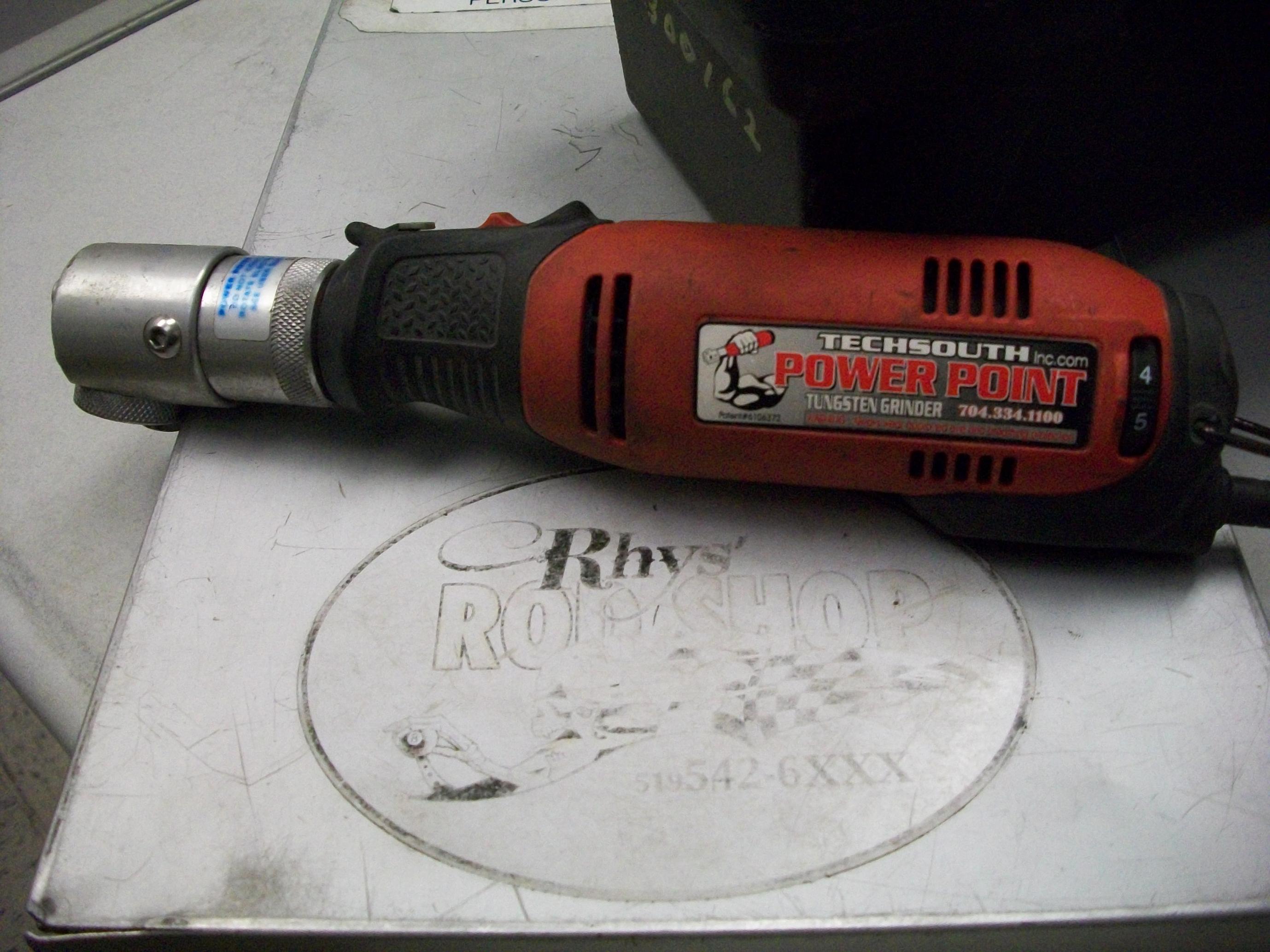

    Here is a great little tool for sharpening your tungsten. I am stuck at work today with my high pressure welding crew on a boiler tube repair and I came across the thread again at an opportune time. We keep these right beside us as we are welding, nice diamond wheel, variable speed, sharpens tungsten in seconds to a nice profile. Wish I had one at home, it would save running to the grinder. regards, Rhys.
