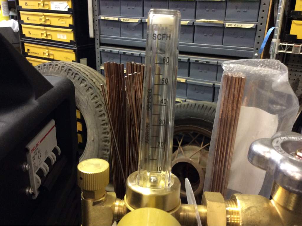

  2. Sunday driver
    Joined: Sep 30, 2014
    Posts: 62
    Sunday driver
    The gas was 15 -20
    It felt like some was coming out before I turned on the machine ,
    Then increased when it came on

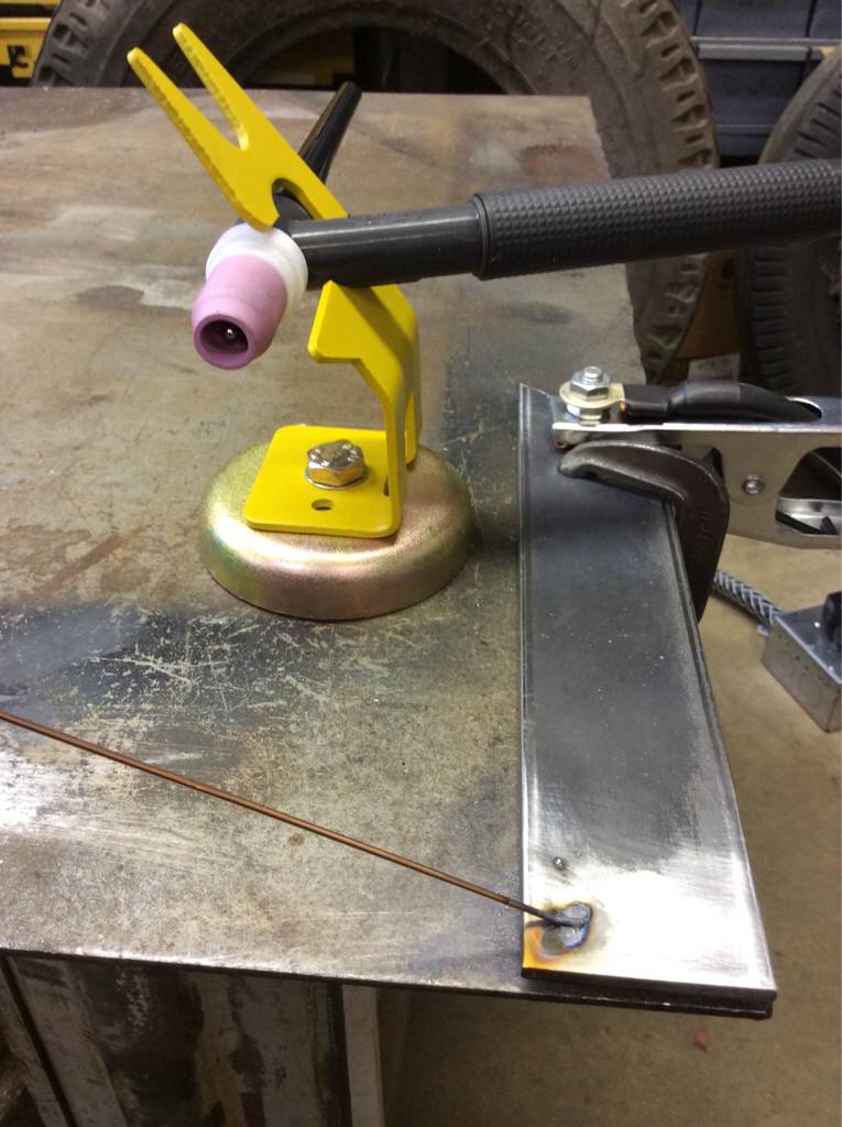

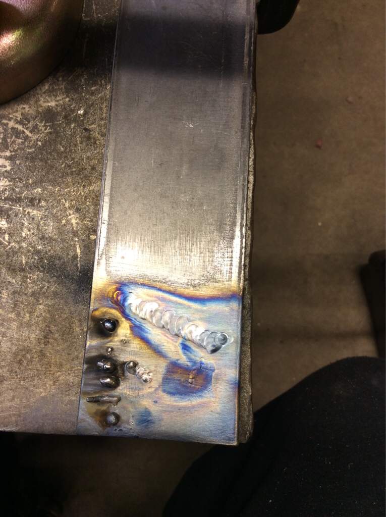

  10. Sunday driver
    Posts: 62
    Sunday driver
    Now that I switched it the tungsten isnt melting but the test strip isn't either .. Started at a 100 amp then went up to 200 amp same not melting
    ImageUploadedByH.A.M.B.1417904196.202056.jpg ImageUploadedByH.A.M.B.1417904350.894220.jpg
    I ment to say the positive clamp lol
  11. noboD
    Joined: Jan 29, 2004
    Posts: 8,994
    noboD
    WAY too high. Read the book.
    Beau and Sunday driver like this.

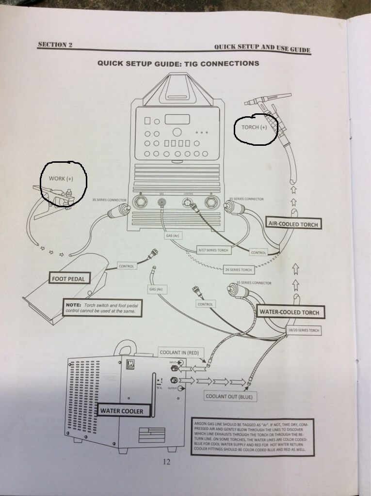

  19. Blue One
    Joined: Feb 6, 2010
    Posts: 11,517
    Blue One
    from Alberta
    Reading the instructions doesn't always help, especially when they are all screwed up. :D
    How can the work lead and the torch possibly be both hooked up to the + side of the machine :confused: :D
  20. Sunday driver
    Posts: 62
    Sunday driver
    thanks yes i have looked but nothing close by figured like everything else you just have to jump in , i got this one because id like to work with aluminum and stainless too
  21. Sunday driver
    Posts: 62
    Sunday driver
    lol good eye !
  22. metlmunchr
    Joined: Jan 16, 2010
    Posts: 877
    metlmunchr
    Make sure you keep the amperage at 150A or less while you practice. Your air cooled torch is rated at 150A and air cooled torches generally won't stand excess current for very long. They overheat and things in them begin to melt.
    Sunday driver likes this.

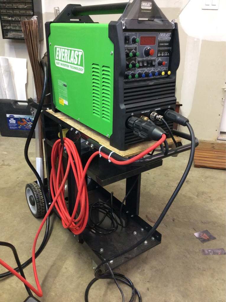

  25. I have the same model ex250 I have the water cooler on mine.It's been a good welder so far, had mine for almost 3 years. I to had never tig welded, took me almost a year to finally figure out the control features and fine tune it. The only thing I did was change the foot pedal, the one that came with it was a pile, I ordered an SSC brand made in USA, night & day difference! I believe they changed the pedals since I bought mine. The more I weld with it the better I get. Welded today for almost 3 hours straight! Keep practicing and maybe watch some youtubes on tig welding until you get the feel for it!

  28. Unkl Ian
    Joined: Mar 29, 2001
    Posts: 13,509
    Unkl Ian
    Get your test piece up off the table.
    Beau likes this.

  30. aaggie
    Joined: Nov 21, 2009
    Posts: 2,530
    aaggie
    TIG requires a squeaky clean weld area. Grind off all mill scale on hot rolled steel then wipe down with Acetone to get rid of any residual grease or oil. Everlast is a good machine but way to many controls for a Novice to learn at once. Clean it like I said then set the machine for basics, DCEN, 125 AMPS. gas flow at 20 and make sure the ground is solid. Grind the tungsten to a sharp point then slightly flatten the point.
    I have run quality tests using all commercially available electrodes and you can weld 99% of anything weldable with 2% 3/32" Lanthanated, that included Aluminum. There are a few exceptions but those alloys won't be found in home shops or Hot Rods.
