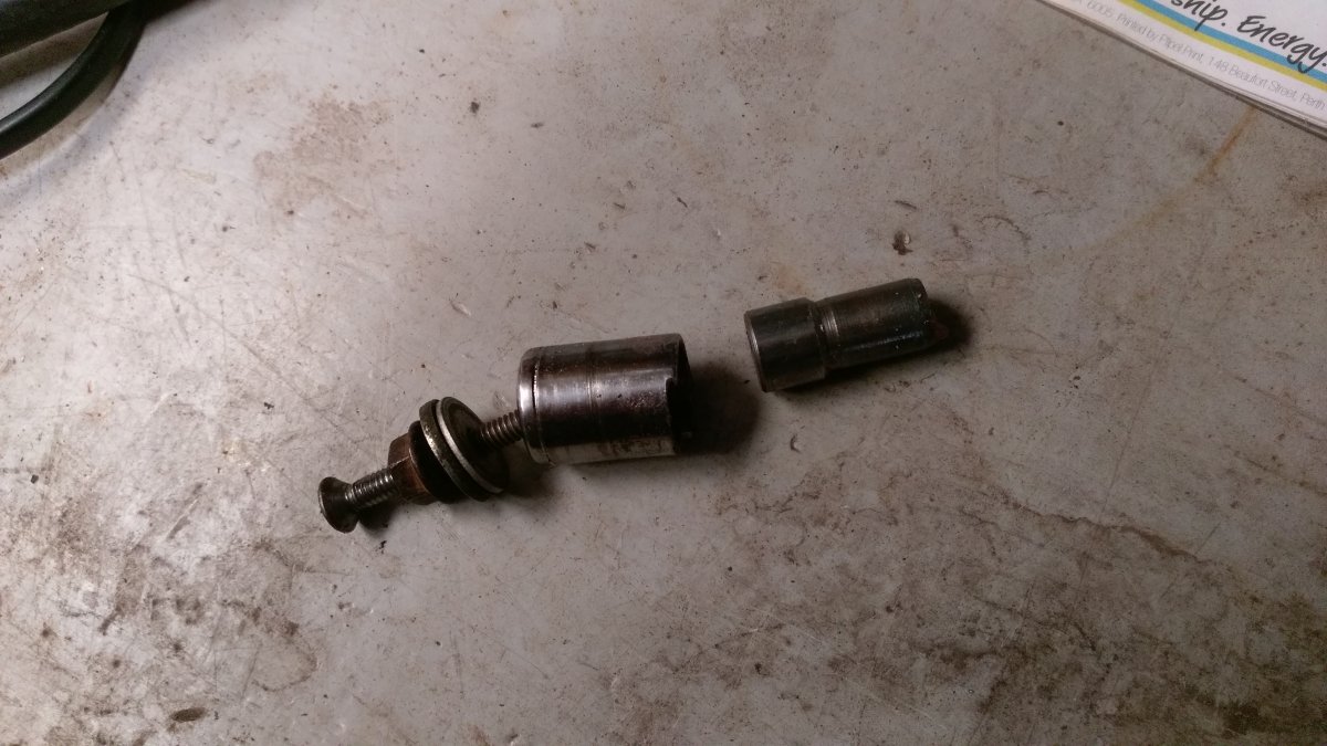

    Here is a couple of pic's of my homemade puller tool.
    I just used a correct thread bolt a couple of washers, a suitable nut and an old junk socket that I drilled slightly so it would allow the pivot pin to pull up inside it.
    Worked a treat and no chance of snapping or breaking.
    I did have to grind down very slightly one 1/3 roughly of the socket edge to ensure it could sit flat as the pivot pin hole sits on a lip edge in the cast housing.
