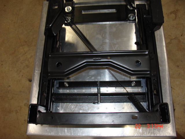

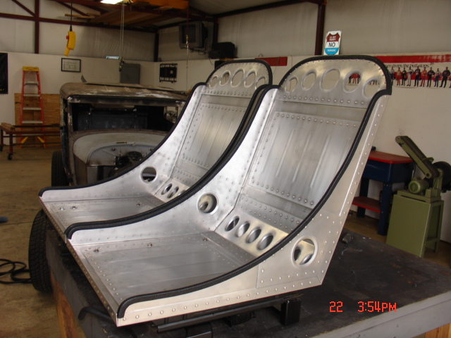

    Okay I finally got them tilting 2 months after starting this thread.
    The adjusters came out of chevy cavaliers they were heavily modified to sit on a flat floor and the p***enger one actually does tilt.
    Started out trying to get the whole adjuster to tilt off the floor but the front of the bucket was hitting the floor before it tilted up very far, and to remedy that I would have had to extend the front feet of the adjuster quite aways.
    So I made just the bucket tilt off the adjuster and this is what I came up with !!
    Still won't be real easy to get in the back but at least it will be possible to get in the back.
    The second picture show the Pin used to lock the seat in the down position.
  11. Looks like a really good solution!

    How wide are those seats?
    I may take a different direction on mine, a Fellow HAMBer has some seats that are a bit more narrow than the ones im currently using.
    I dig your idea, and it works fine for your application,, getting in and out of the back for kids or stuffing things back there wont be too big of an issue.
    My larger seats folded over and rotated up like yours, if found it wasnt a tight enough fold up on mine to roll tucked up..so im going to try a different set of seats just for feel.
