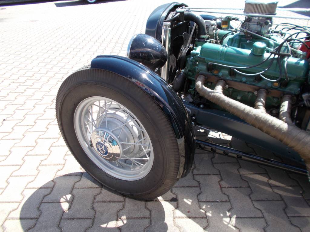

    Here's a couple of pictures to start us off:
    So basically nearly stock, just updated in the areas necessary to bring it up to 1940s standards.

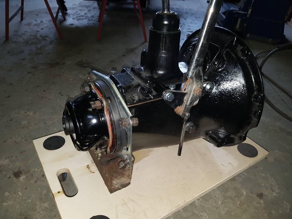

    I also mated up the '39 transmission I rebuilt. It's actually an F1 case and tower. '40 internals, a '37 shifter and '32 rear mount. The transmission got a new cluster and all the usual stuff.
    Made a bracket to mount the '32 parking brake handle to the top of the transmission.

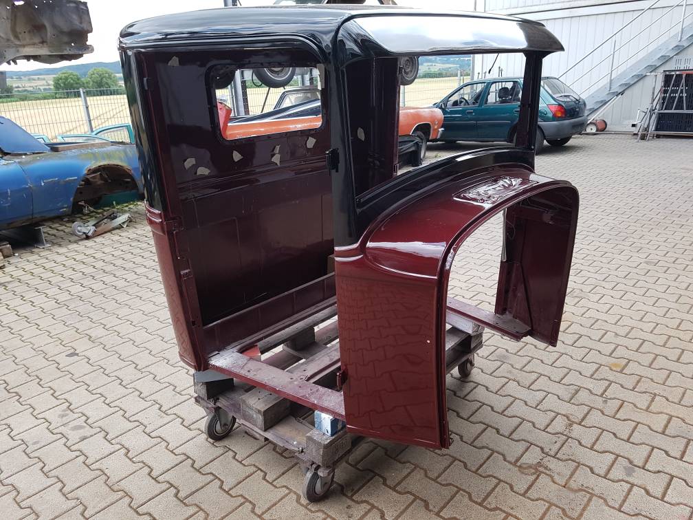

    This is the cab with doors fitted. I had the top half painted black. As I'm not chopping this one I figured that would help visually. The frame and cycle fenders will also be black.

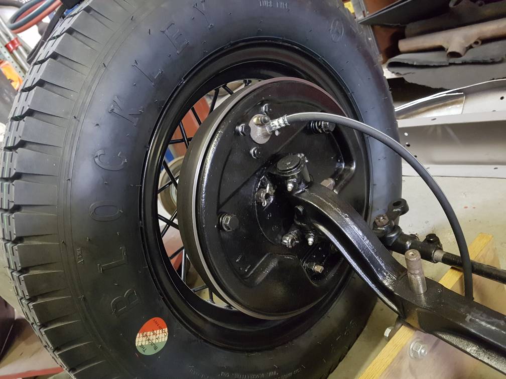

    I'm back on the pickup build now. So expect regular updates. I spent a lot of time thinking about tires. Firestone Deluxe were out of the question. Until Coker can guarantee me no more than 60 grams imbalance I'm not fitting them anymore. Then, completely, by chance I discovered Blockley Tires from England while looking at a friend's pre-war Maserati and Bugatti racing cars. Blockley make high quality vintage tires DOT rated to 130mph. So I fitted a set of Blockleys. 5.50 16" up front and 6.50 16" on the rear.
