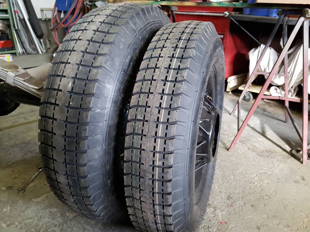

    Here's a picture showing the front and rear tires together. Not a huge difference in size and this might not be ideal for a roadster but I think it'll suit the pickup well.

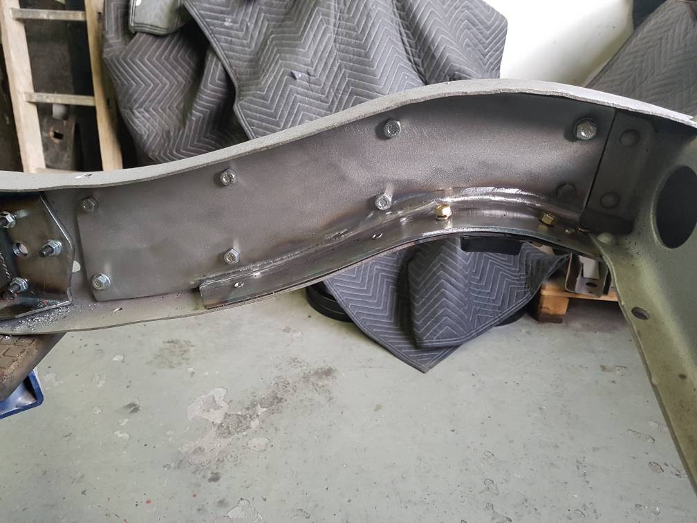

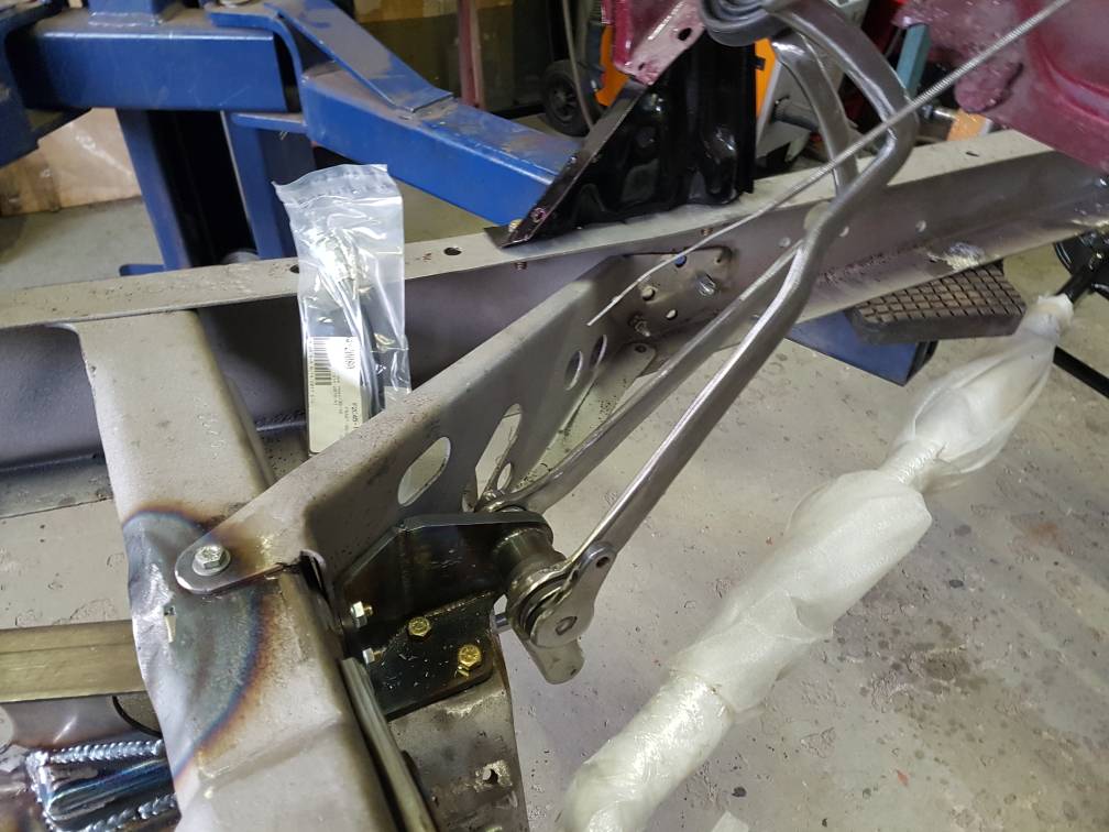

    The frame is now restored. At this stage I start to trial fit all the components to make sure everything fits before paint.
    Here is one of the Bill Stipes shocks and Bob Drake 1940 brake hose bracket installed.
    Industrial Ch***is Inc. 1932 pedal set. I spent about an hour grinding the pedal arms smooth to make them look more light forgings.
    These are the kickup strengtheners. Essential on any original 32 frame. This was actually an official recall in 1932 but I've rarely seen a 32 frame with factory strengthers so I guess most never got retro fitted.

    Not a lot as the frame has never been apart. So it's just the front cross member, the kick up strengtheners and the left K-member leg need riveting in.

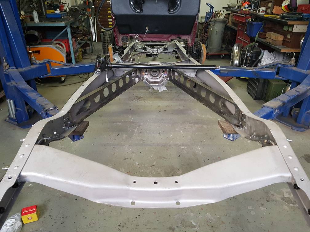

    Superbell forged steering arm needs to be bent down to clear the stock 32 perch. Still needs to come down another 1/4".
    These are the 32 frame strengtheners from Industrial Ch***is Inc. They make a huge difference to the rigidity of the 32 frame which is an appallingly weak design.
    Although both the legs and the pedals come from Industrial Ch***is Inc, the 1940 MC doesn't fit and you have to make this recess in the left leg.

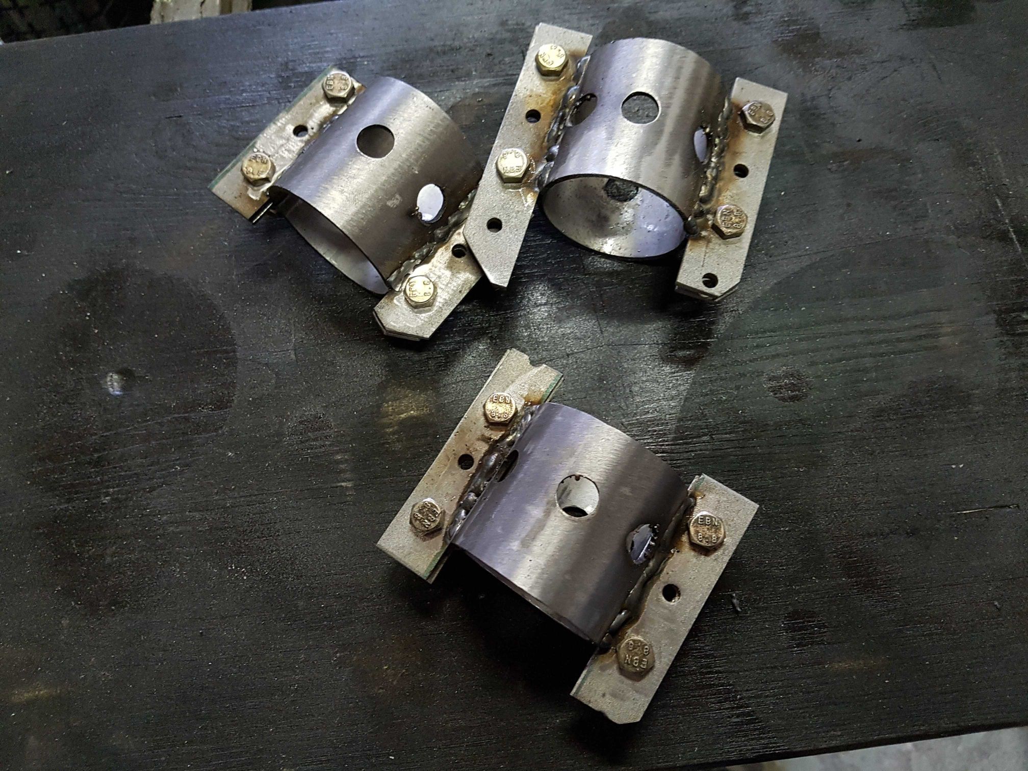

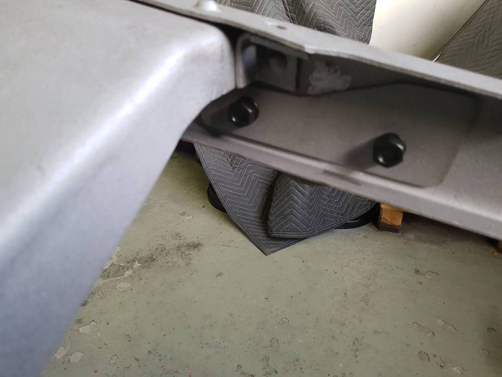

    And lastly for today. When installing Houdaille shocks, don't forget the stiffener plate mounted behind the frame. I made them myself by copying an original I had.

    Those shock backing plates and the frame stiffeners would be easy parts for Industrial Ch***is to knock out on their machines. Thanks

    The X legs are from Industrial Ch***is Inc. The kickup strengthers are more difficult because they're curved.

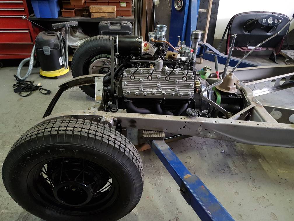

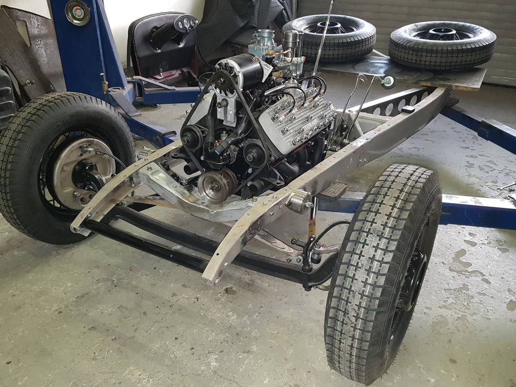

    So progressed today on the pickup. The engine when in for a trial fit. I preferred the fit without the front engine mount extensions which made it sit too high.
    It's amazing how hard it is to fit a flathead V8 in a 32!
    This flange on the sump to bellhousing has to be ground away a bit to clear the wishbone.

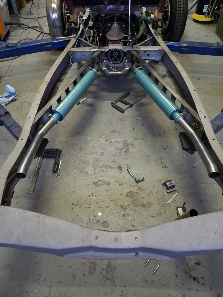

    I am in the process of building a stainless steel exhaust system for the truck. I've used Smithys mufflers which are made of mild steel and Speedway exhaust headers.
    I used 1 7/8" OD stainless steel pre-bent sections. I ordered a selection of 15, 30, 45 and 90° bends. This are bent cleaner than you can bend yourself on an exhaust bending machine.
    The exhaust system is hard mounted and attached to the headers used 18" lengths of stainless steel flexible tube.
    I like to weld the sections together and then grind and polish the welds so they aren't visible. That way the system flows through the ch***is looking like it's bend up out of one piece.
    I made up these clamps. They clamp the exhaust sections together so it's perfectly aligned. I can then set 6 spots through the holes before removing the clamp. I can then seam weld around and it's perfectly aligned so there's no step anywhere.
    To weld stainless steel you'll need a bottle of Argon 4.6 and stainless steel welding wire. It welds much cleaner than mild steel.
    Here's some pictures of the system so far.
    It's going to continue through the holes in the rear crossmember then out the back to finish flush with the end of the pickup bed.
    All exhaust clamps are also stainless steel. A system like this will cost you much more than mild steel but it looks nicer and should, with the exception of the mufflers, last indefinitely.
