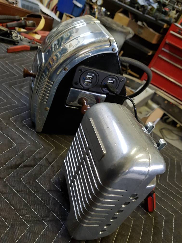

    Here is the heater finished. It's an original Art Deco heater fitted with a 12V fan and an Austin Mini heater core. I also fitted some USB sockets on the side to power the radio and to charge phones.
    There's a two speed pull switch on the side of the heater so it's entirely self contained and just needs power and earth.
    The "radio" is a Doss Traveller Bluetooth loud speaker so you can play your favourite tunes. It's been fitted into an original drive-in cinema loud speaker case.
    The radio can also be unhooked from the firewall and taken to the camp fire. It also features a powerful LED light for finding your way around in the dark. It's got a lithium battery which lasts hours outside the vehicle.
    Both mount on the firewall. The heater in the middle and the radio in front on the p***enger's feet.

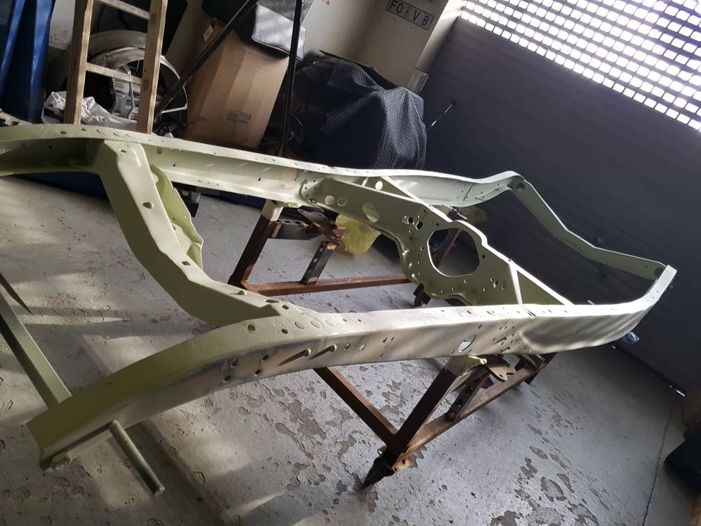

    This is the frame I started with. It wasn't too far gone but did need a lot of work.[​IMG]
    Sent from my SM-G935F using The H.A.M.B. mobile app

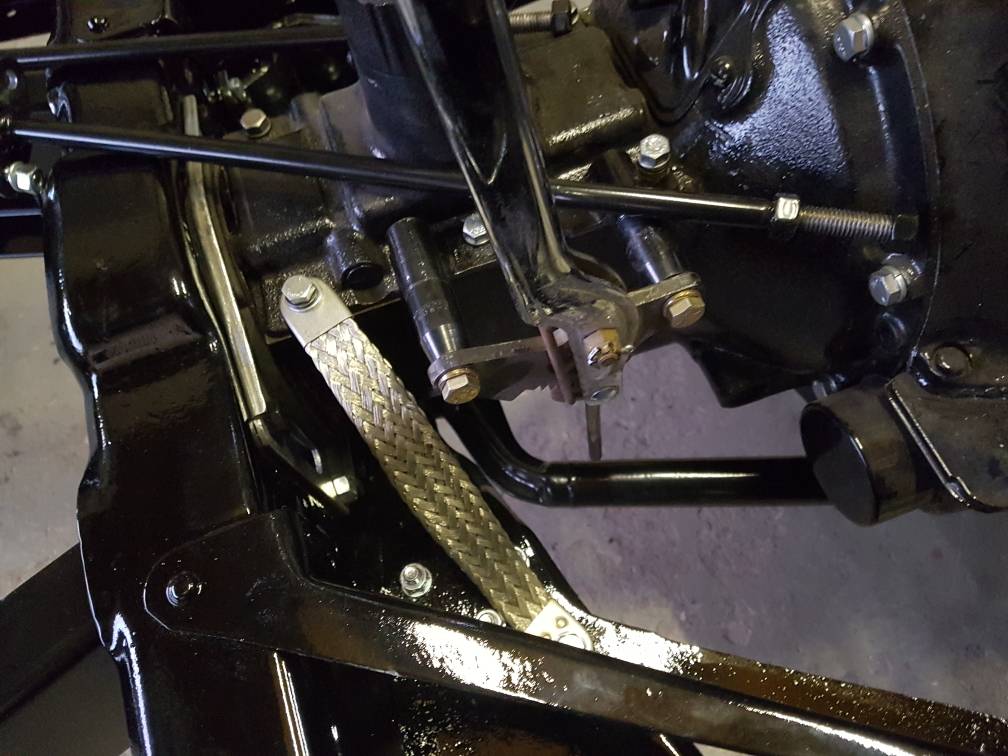

    Today was day zero. The frame was painted on Saturday so I was able to start final ***embly today.
    This is how far I got today.
    I've reversed the front spring U-bolts to give more clearance to the axle. The air filter is an original 1946 Ford oil bath filter. The shackle bars have been powder coated and the nyloc nuts replaced with castle nuts.[​IMG][​IMG][​IMG][​IMG][​IMG][​IMG][​IMG][​IMG][​IMG][​IMG]
