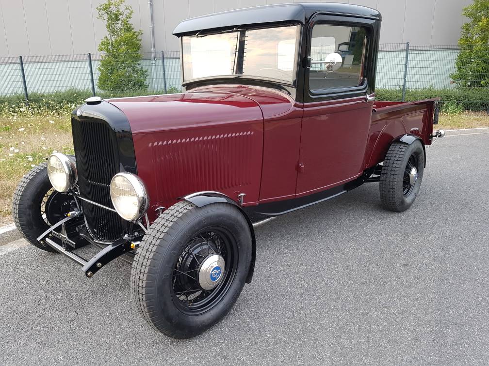

    Also fitted the header instrument panel and wired that all up.
    Next up - fitting the windshield.[​IMG]

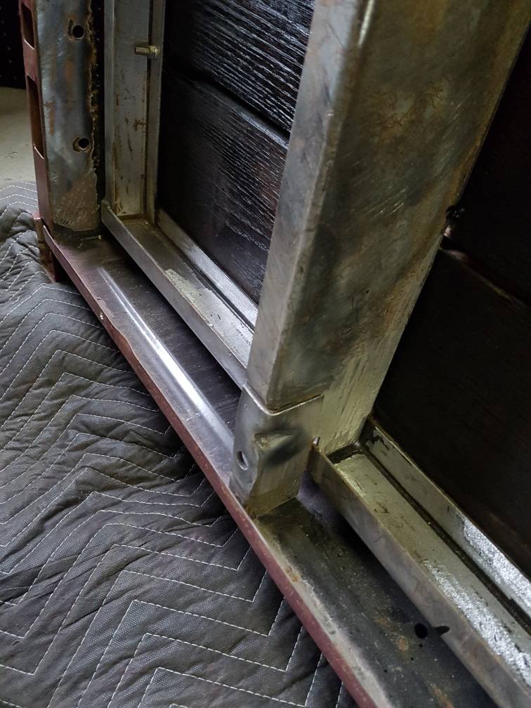

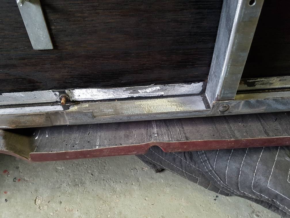

    Here's some photos of the bed subframe taken from the front to the rear. The side rails have cut outs to clear the frame at the top of the kickup. The center crossmember also has cut outs to clear the frame.
    The first photos are of the rear mount which you'll need to source or make.
    The crossmembers have holes for the D nuts which you need to install before ***embly.
    The bed kit comes with loads of rivets to rivet the bed together but you can ***emble with nuts, bolts and lockwashers instead.[​IMG][​IMG][​IMG][​IMG][​IMG][​IMG][​IMG][​IMG]

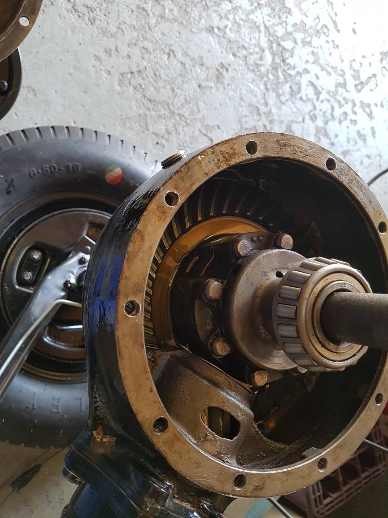

    I found out why my banjo axle was leaking so badly. My axle builder hadn't put even the thinnest gasket on one side.
    I need to seal it somehow.
    Would it hurt to install the thinnest gasket available? Should I apply a thin smear of silicon to the gasket to ensure a good seal? Or is this going to throw off the bearing settings too much? I suppose I could use a shim under the bearing to compensate. The gasket set does come with shims. But that would mean pulling the new bearing which may be difficult. 20180618_144723.jpeg

    Smear a little bit of sealant (rather not silicone) on that and put it together. Should be good.

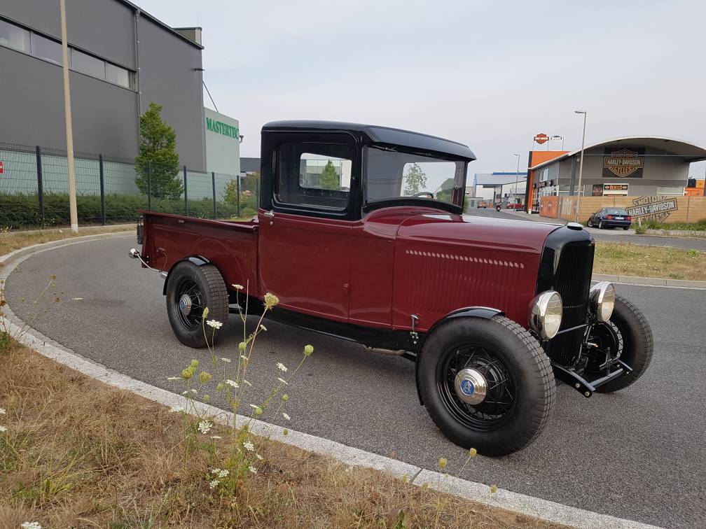

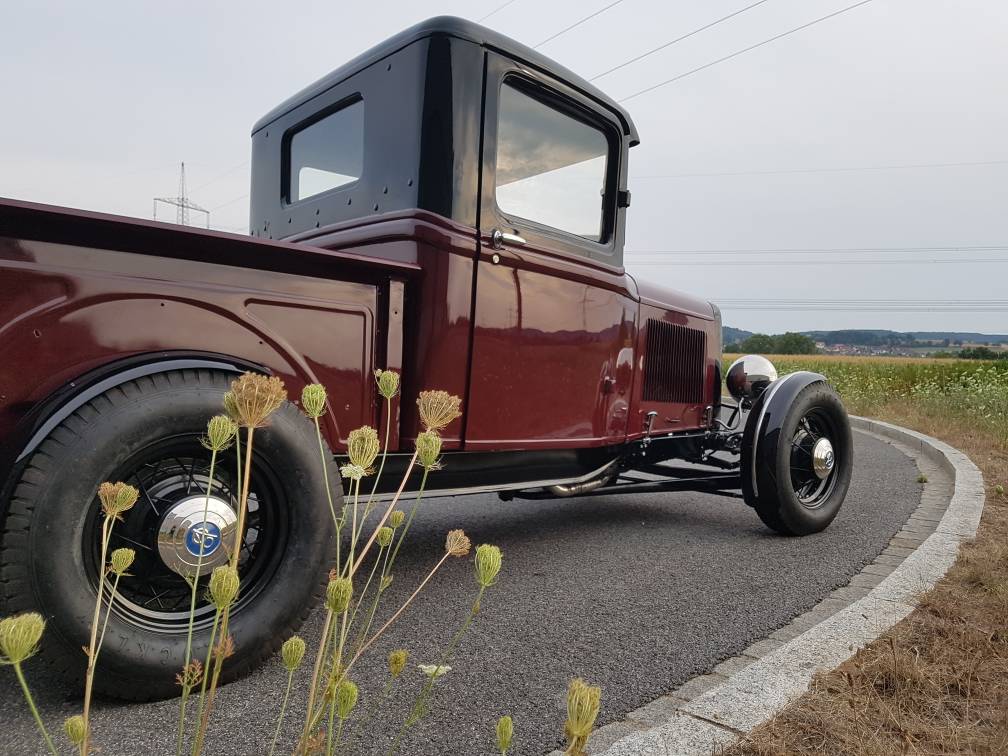

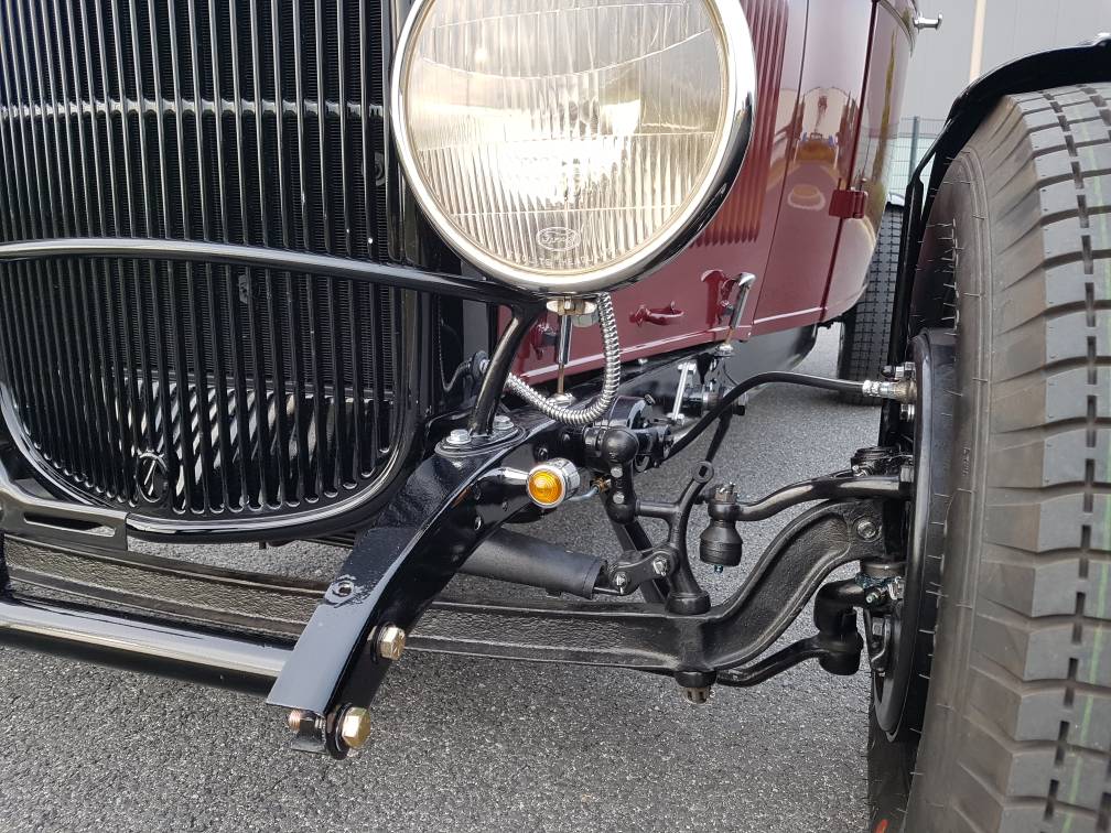

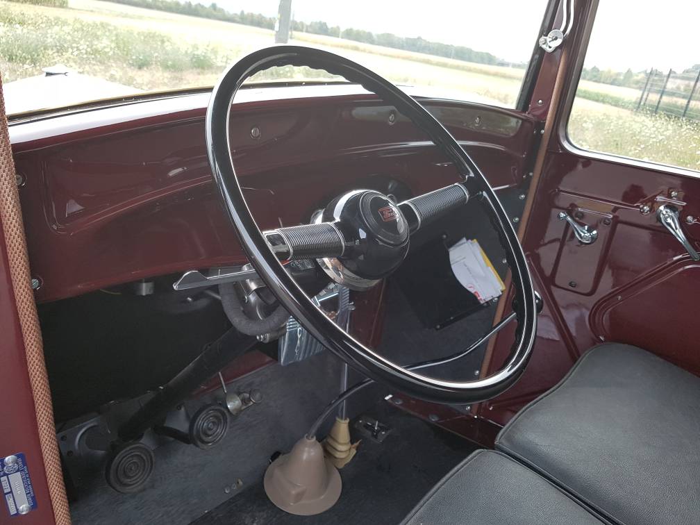

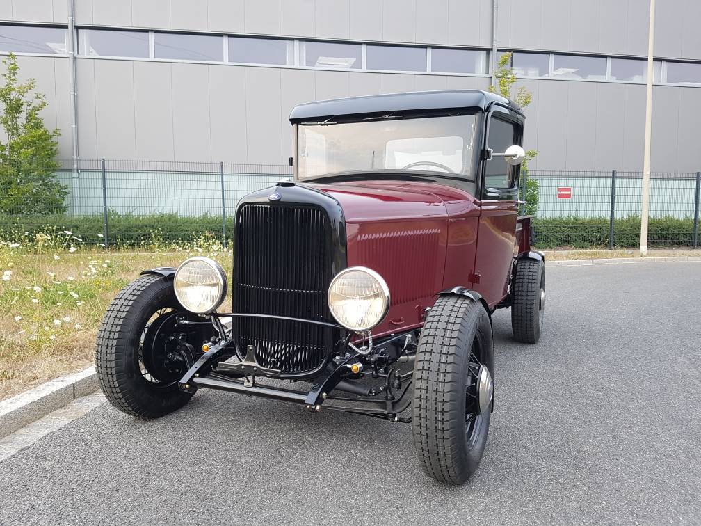

    I spend the afternoon cleaning and polishing the truck. Here it is - finished. 20180807_182640.jpeg 20180807_182605.jpeg 20180807_182509.jpeg 20180807_182500.jpeg 20180807_182432.jpeg 20180807_182549.jpeg 20180807_182517.jpeg
